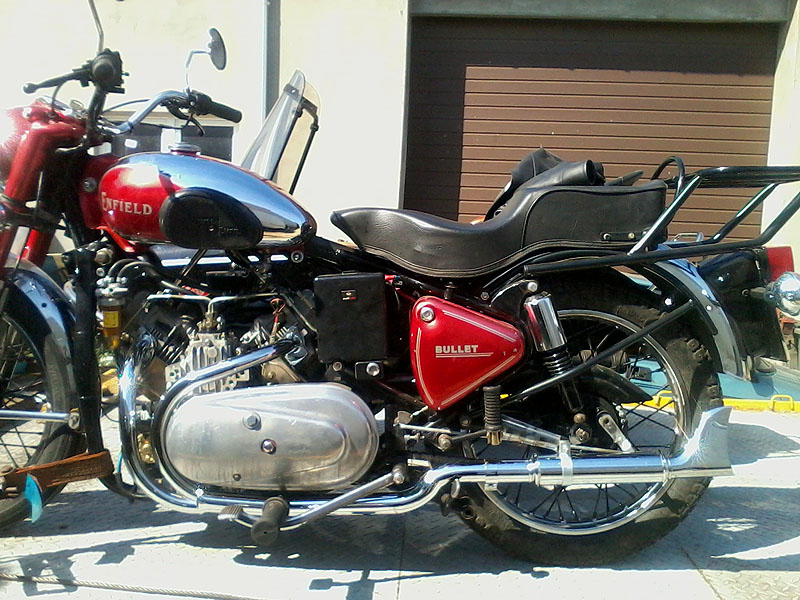

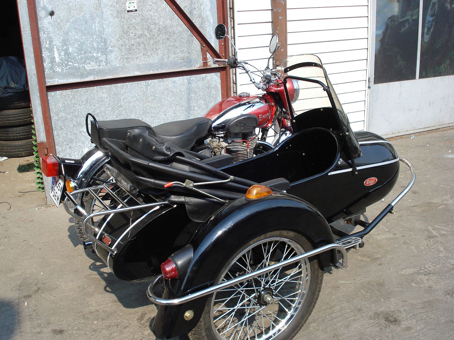

Since is going so nice with pictures I will upload more One with side car but still with original Enfield engine and other one with more currant stage.
Re: Hello from Poland.
Nice one Adamer I best that wasn't easy! It looks to have fitted in the bike very nicely though and, of course, the V twin should pull the sidecar ok

Bike is almost finished and got a plate and new documents Running nice, but still need some improvement. Basically Suspensions have to be harder, as engine is heavier then original 350cc On the next brake (I’m offshore now) Front springs will go to Germany so they can choose stronger for me. In the meantime tank and side panniers will go for new paint. Aft Suspension maybe needs some changes as well. I don't have a chance to drive it a lot so don't sure about fuel consumption yet.
