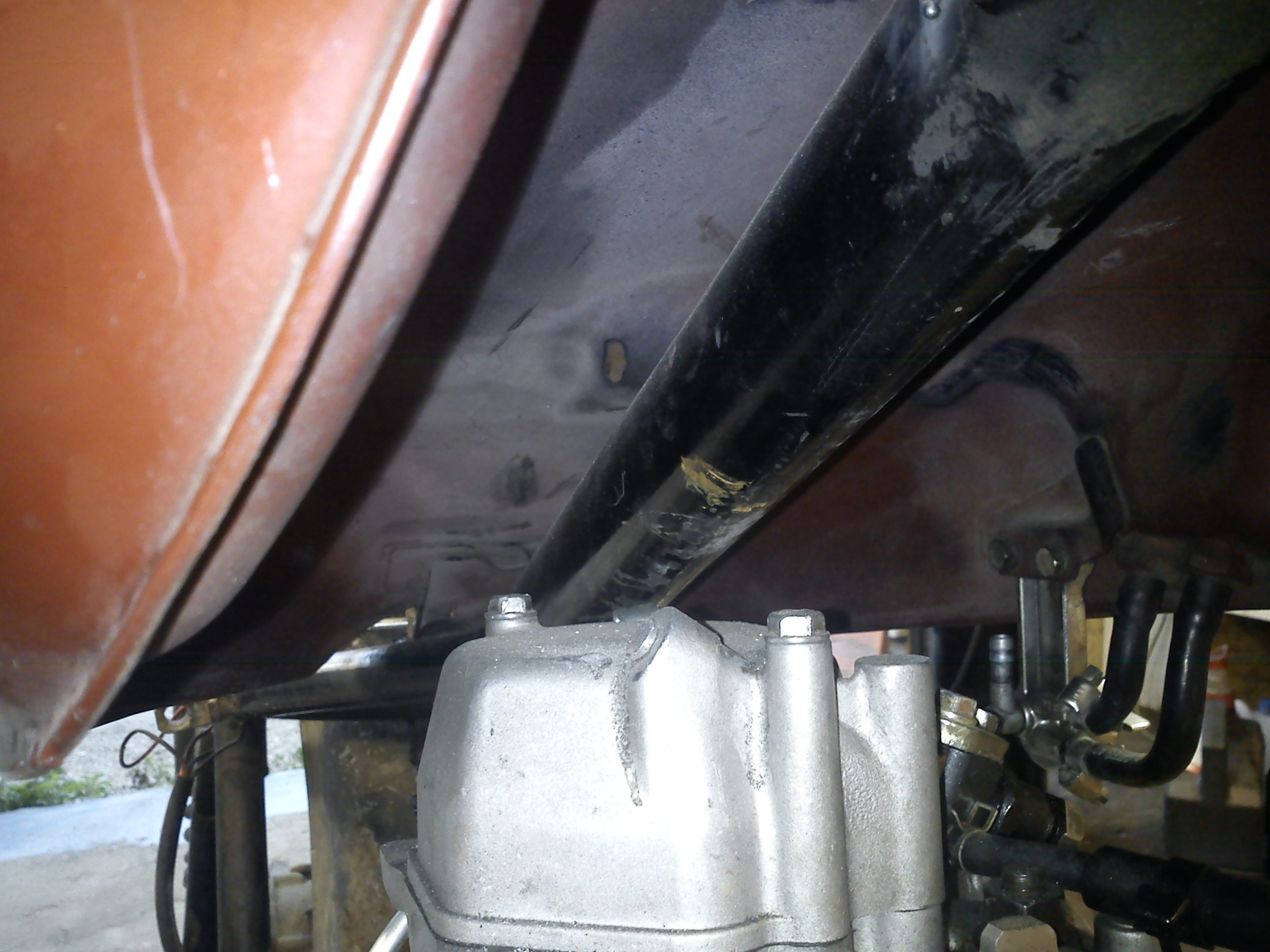

Hrm.. let the pics speak:
Aligning things up
Aligning things up

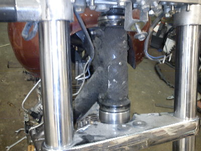

fittings to hold the Vulcan front fork:

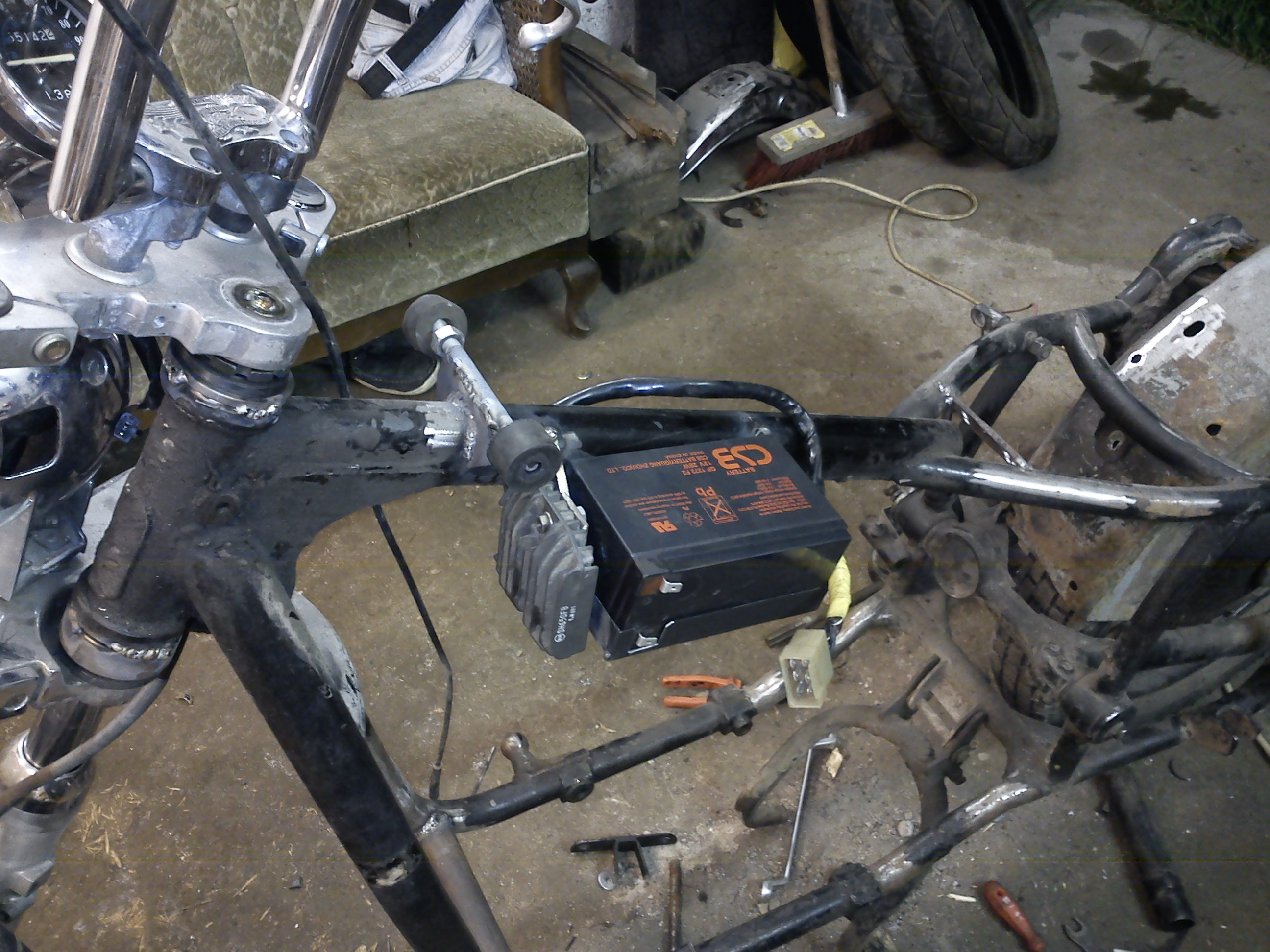

Lots of space under the gas tank to fit 7Ah battery and regulator/rectifier:
Accu box and regulator:

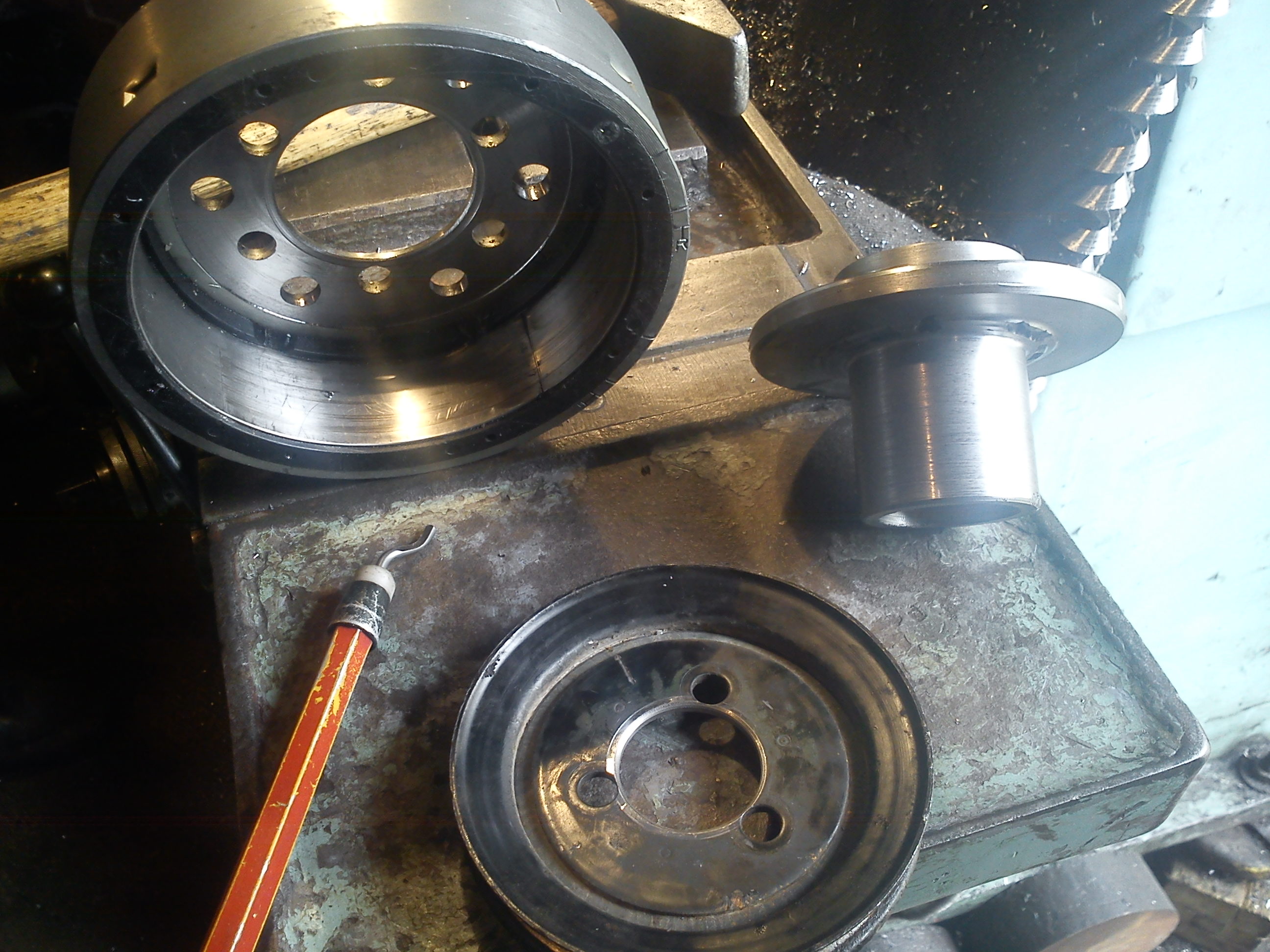

Fitting a Vulcan stator to the engine:
Parts for the Vulcan generator rotor:
Friend welding all the parts together:
Engine and fan test assembly:

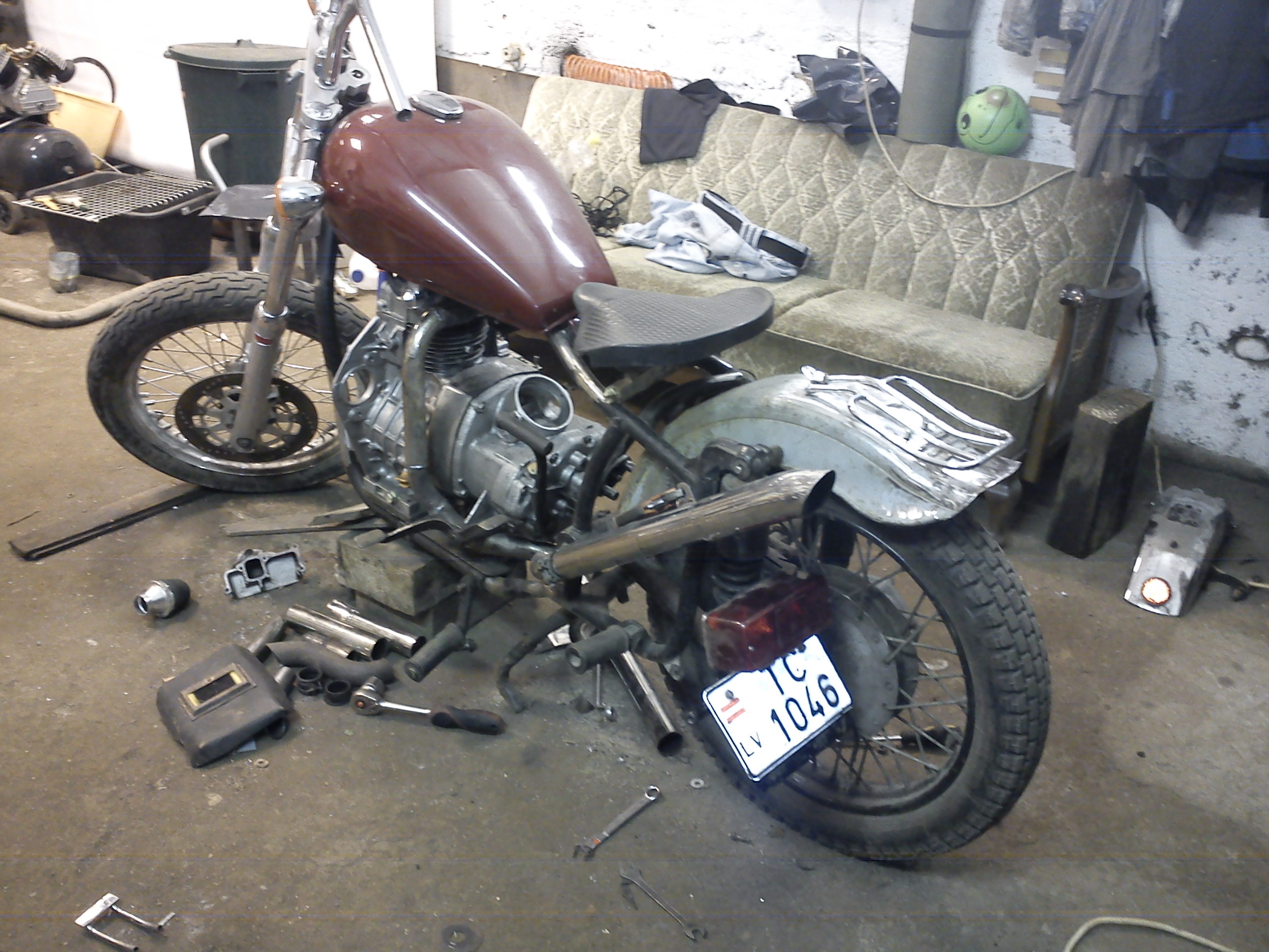

And the pics of semi completed bike, there is still some things to be done - but it's on the finish lino now!!!! :shock: :D :) :) :) :)

That really came together well! Where did you find the donor bike?
kapis
Posts: 35
Joined: Thu Sep 30, 2010 6:47 am
Location: Latvia
Re: Yanmar dnepr project thread
Post by kapis »
The frame, seat, gearbox and rear wheel is frm 1974 russian Dnepr.
The front fork, wheel, fender and brakes are from 1988 Kawasaki Vulcan 1500.
Handlebars are harley aftermarket, rear fender is from russian bike called IZ Jupiter (pic: http://static1.fotoalbum.ee/fotoalbum/1 ... 1eb0e3.jpg)
The Russian bikes and particularly Dneprs are really cheap here in Latvia, one can get running bike for 200$ :)
Hope to finish the bike this weekend, and then will post a vid of it running :)
Cheers!
