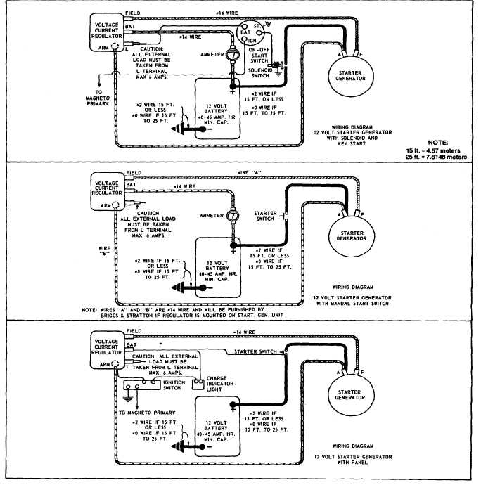

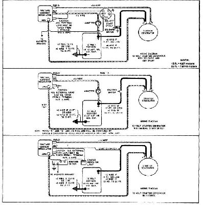

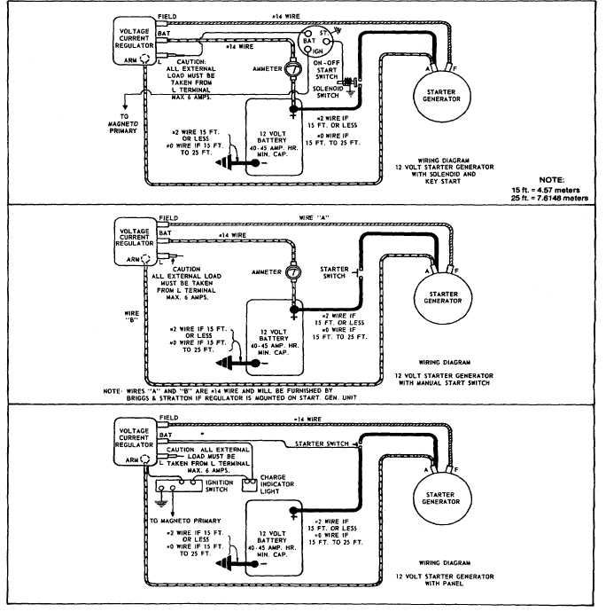

3 common ways for wiring starter/generator ..... hope it's big enough jpg
found at http://recoveryvehicles.tpub.com/TM-5-4 ... 4P_200.htm

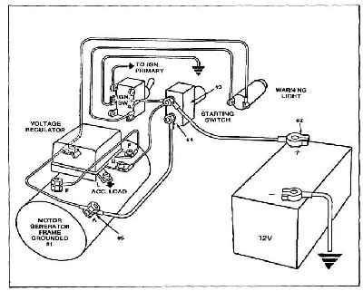

another wire diagram
TM 5-4240-5501-148P STARTERS Starter Generator 12V CHECKING 12 VOLT STARTER GENERATOR SYSTEMS The following tools and materials should be available. 1. Hydrometer 2. Battery cable and terminal cleaning tool 3. Hand tools for tightening belts and connections 4. Baking soda and water 5. Briggs & Stratton 19236 VOA meter or Eico Model 540 Readi-Tester. 6. 4 to 6 amp taper battery charger CHECKING BATTERY Check for clean, corrosion-free and tight connections. Hydrometer reading should be a minimum of 1.225 and each cell should read within less than .050 variation after charging. Battery must meet these conditions before conducting starter generator tests. Fig. 132 - wiring Diagram 41
http://recoveryvehicles.tpub.com/TM-5-4 ... 4P_201.htm
