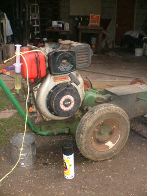

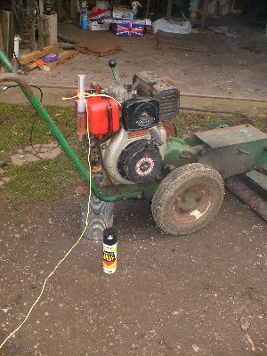

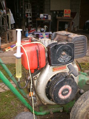

Here is the start of my trials on running with veg oil. Take one lawnmower with same engine as small bike. Disconect tank and replace with syringe filled with veg oil. 20 litres £20. 100% GM soya oil. Pull cord and away she goes admitedly on diesel to start with as there is a small inline filter before pump. A few seconds later on pure corn oil.
Runs OK apart from smelling like a chip shop. The syringe works well and the plunger automatically travels down as the oil is used. Stoped on veg oil, left it a short while and tried the restart. Would not start,gave a squirt of easystart and away she went. Next did a fifty fifty blend of diesel and oil mixed in a bean can and back into the syringe. Squirt of easystart and away she went. Let her run a bit. Stop and restart, this time no easystart. The interesting thing is the plunger in the syringe does not like diesel and you have to give it a bit of a push. The plunger probably reacts to the diesel.
