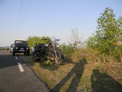

Hello everyone. DST here from india. I am a motorcycle lover ,mechanical engineer and DIY kinda guy.
Have designed and build several bikes only as a kill time option and not for selling. India has no system/ regulations to homologate or approve self build/ garage built vehicles hence custom motorcycle market is absolute zero. finding custom cycle parts is almost impossible, most of them needs to be imported which sends the cost skywards.
My latest motorcycle runs on 1500cc Hyundai U series motor which was taken from Hyundai Verna 2008model ,mounted cylinder bank along the length of motorcycle , has almost all the goodies such as VGT, Intercooler,CRDI, CATCON , EGR etc.
It pumps out 110bhp in stock tune with earthquake like 240nm coming in as soon as 1700rmp. Even at 1400rpm torque gets above 170nm.
Motorcycle is shaft driven with totally maintainence free design, and runs on stock car gearbox of HYUNDAI VERNA 5+1 manual . No welded up differential here. differential has been thrown out from the GB and final reduction takes place at the rear wheel with reduction ratio of 1:2.8 ( using Honda Goldwing gl 1800 final drive along with ventilated disk and caliper).
Motorcycle is performing well ,i have already been across 100mph.

old pic, few more updates have been done. shame that i had to move out of my hometown for a job . lot of finishing jobs still remains .
little old pic, now it has a seat ,speedo and other titbits

some pics from a test run a last month

Neway whatever money has been spent on this bike has gone into gearbox and nothing else
No, bike would not look like the one in the pic. That pic can only give you some idea of wheelbase and seat height. Its build to test the drive train , I frequently need to open up the gearbox /drive shaft so dint bother to make the other bit just yet.
