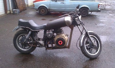

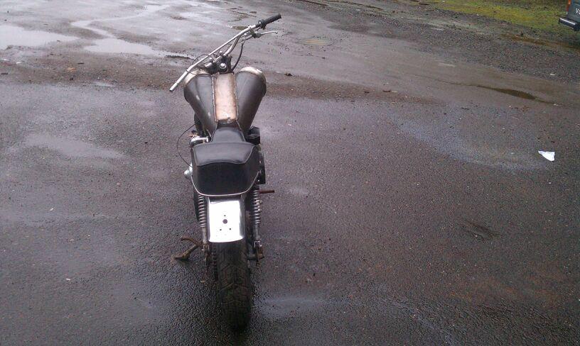

The Glupity Glup Gets Its Fuel Tank, My Turbo Diesel Hybrid Electric Motorcycle, 1982 Honda CM 450 Based. This is a 3 chamber fuel tank, the two side chambers are about 3 gallons each for diesel, and the center tank is about 2 gallons for the aquamist liquid intercooler water/alcahol ADI watler injection.... It has a 5hp permanent magnet motor, lipo4 2kwh battery, and exhaust waste heat recovery using peltier junction thermocouples.

here are some pics, for higher resolution detail.
