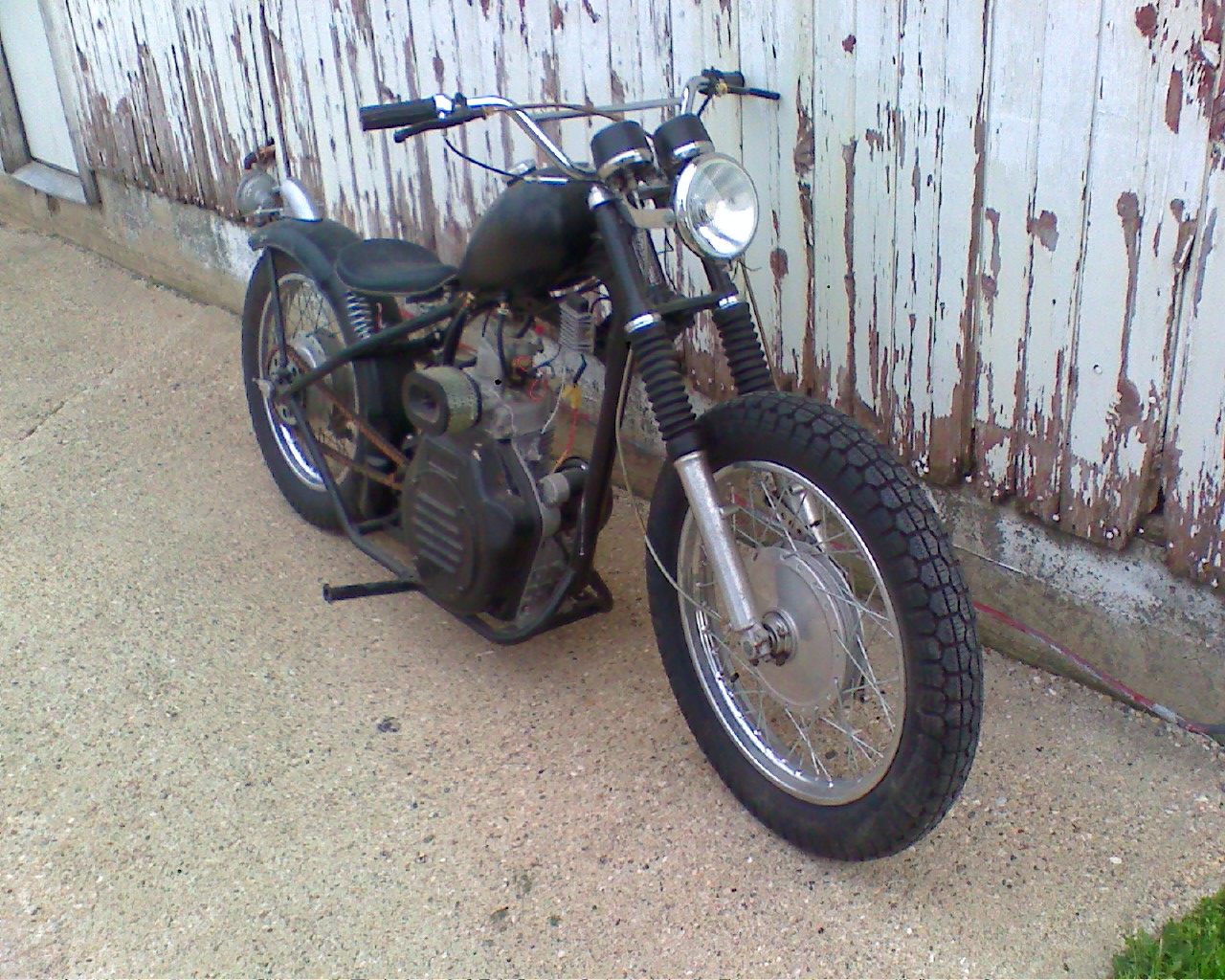

Hello all. I'm new to this diesel thing. I was born a gearhead, more so, a drag racer. I just did some horse trading with my pops for a bobber that he got to the riding stage, then moved on. My rig started life as a 1970 Honda CL450 street bike. I think dad paid almost nothing for it, and it had a current street title! The wheel assemblies were used, as well as the forks and front frame section. My father built his own hardtail rear frame section, and remounted the rear fender. I really dig it, but now I get to make it work correctly.
So, what's everyone think???

Looks like a light weight ride, when those clone engines are broken in, they rev right up...with that straight pipe, your ears will bleed from the noise You have a piece of sheet metal missing from the front right cylinder that wraps around the cylinder to the pto side. While driving out on open roads, that's not an issue, but in stop and go traffic, you might get a hot spot on the cylinder...just an observation. It you look at other horizontal shaft gas engines, they all utilize the same sort of sheet metal. Have you gotten it out on the road? What else does the bike need to be street worthy?

Thanks! I just picked this bike up from my father last week. It's been sitting for at least three years as it is now. I did see the cylinder cooling tin at dad's, but I left is with the spare engine. I didn't think I needed it, but I understand what you are saying. I think I will reinstall it. I'm pretty sure that dad zeroed out the odometer, because it reads 64 miles. I haven't even fired it up yet. I saw him ride it the last time it ran, in 2009. It needs the wiring started, and little odds and ends that I want to change. Different brake cables and holders, longer seat springs, kick stand, folding foot pegs, new tires, possibly a Triumph fuel tank (I'm a Triumph lover), possibly a different license plate mount, and the biggest thing is fixxing the jackshaft. Dad used a single seat post to mount the jack shaft on, and it flexs badly. That is first on the list.balboa_71 wrote:Justin,

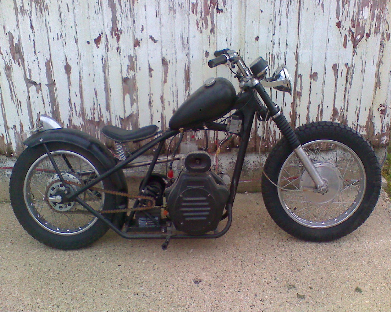

Here's an updated photo for anyone that is interested...
I'm still pluggin away at it. I've had it up to 55 so far, and I think that is about all she'll do. I don't think there is enough horsepower to pull the overdrive on the secondary clutch. But, it's all new to me, and I'm still learning. I do know one thing, this thing is stupid fun!!!

55mph is great and is just about the limit for 10hp. If you are not getting full shift out on your CVT put a larger sproket on the rear. This will give you more acceleration and not hurt your top end.

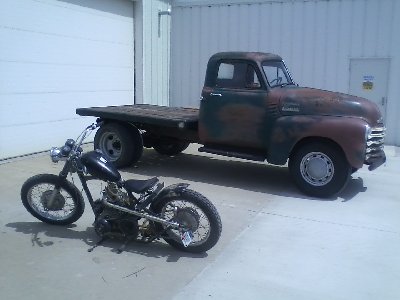

Well, the bobber is long gone. I traded it for a flattracker. I did manage to take it to a rat rod show. That was pretty neat!!
I readded the photos as pre request. Here are a few more...
