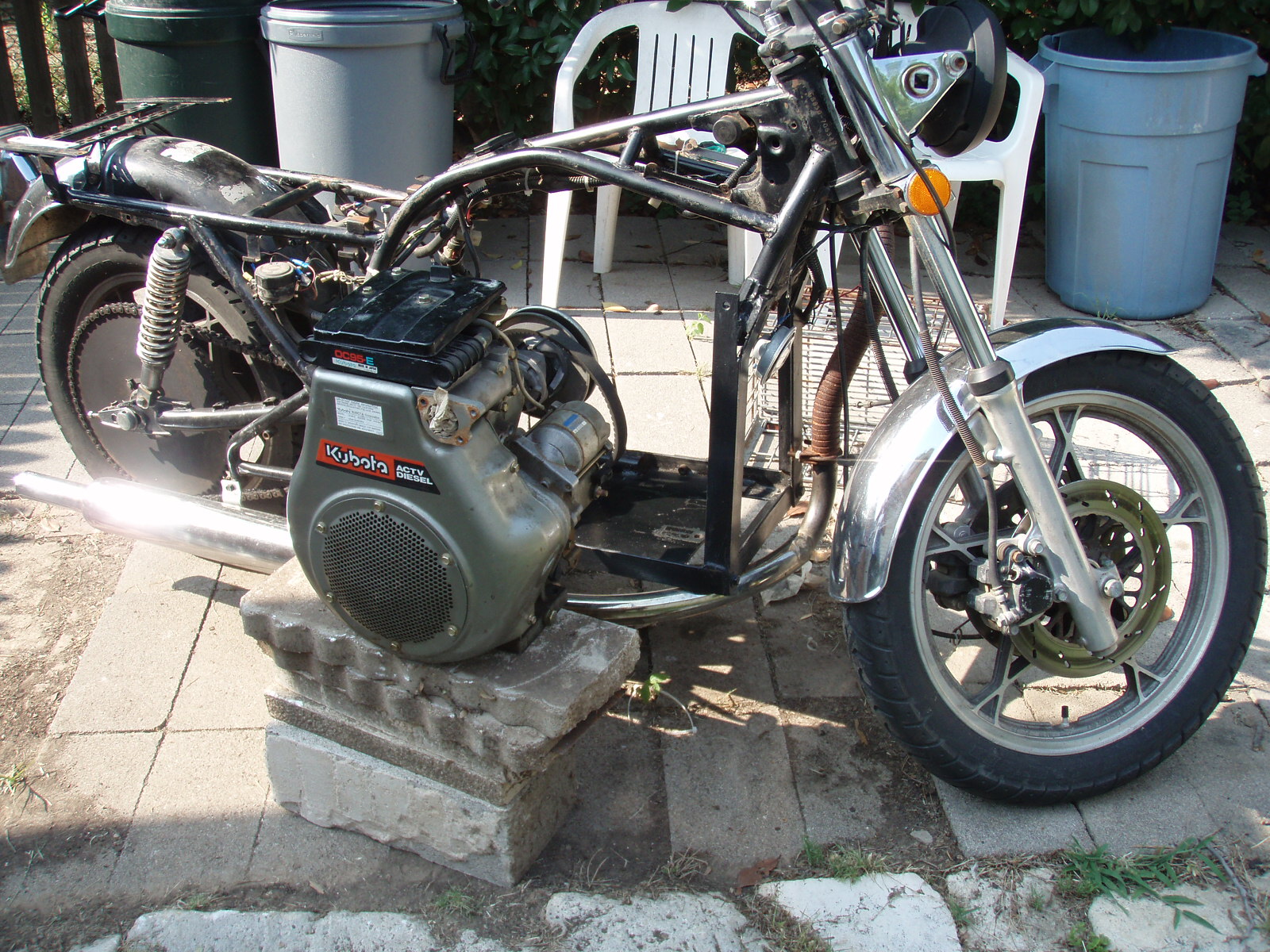

Okay, got my old engine out of bikes frame, took an hour under the 98°F heat here in Texas Kubota was stripped down earlier in the day just to see what other problems I'm up against. Aside from the flywheel being rusted to hell and back, and there is a good amount of red clay dust on the engine castings, I can't find another problem. Took some photos to post, but can't figure out how to do that....
Cris

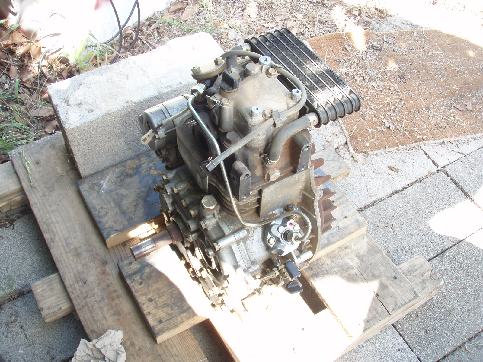

After the pics are on you computer and you know where they are..balboa_71 wrote:..Took some photos to post, but can't figure out how to do that....Cris
best pic size is cropped to the importan parts of pic and saved at around 800x600 and jpg format. there are several free programs for resizing and saving into jpg format as well as free websites you can upload to, convert it and download at new size and type
. start a new post.
. type in your text
. Scroll down BELOW the text box to the two tabs [Options]is on top [Upload attachments] is next layer.
. Click on Up [Upload attachments] to bring that layer to the top.
. Use browse button to find pic file
. use the [add the file] button to load it from your puter to the website. It will be added to the bottom of your post when your all done.
. repeate for other pics.

As you all can see, I'm about ready to get engine into place. After photos were taken, I had to drill and file extra hole to make it all work out. Took me a week of late afternoon HOT sessions, but I got it done. I'll post some pics of engine in frame tomorrow.
Cris

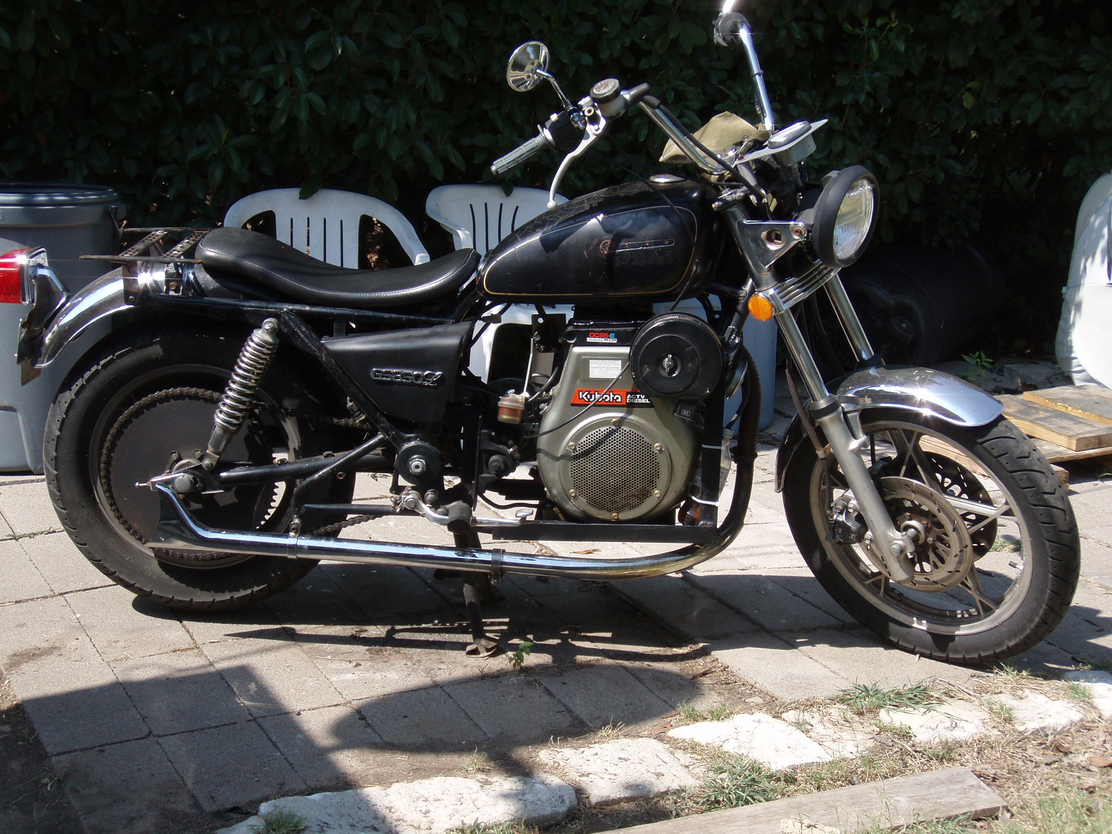

Okay, here are two pics of installed engine. Still have to do a few more things....

Yesterday, I took her out for a 2 hour ride with a full tank of fuel. I made several stops looking for some titty grips for the handle bars, but came up empty handed...sure miss the titty grips from the late '6o's Anyways as for a road riding report, here goes..... The OC-95 is either under stressed or tight. It will not drag my bike faster than 45 mph. I'm hoping it will loosen up in time or I'll go a different route. One thing I can say for that damn noisy Kama clone engine is it was happy to rev, but always sounded like it was going to explode. Personally, I don't like riding a time bomb, so the quiet nature of the Kubota is welcome, I just have to breath some life into it. I don't know about you guys, but a Kubota powered tractor is about as exciting as watching the grass grow. It just rev's up and doesn't do anything to get you off...kinda like a 3-1/2 hp B&S lawn mower. On the other hand, the clone engine teases you into thinking you're really getting somewhere on a wing and a prayer! So after installing my killer fish tail exhaust, I expected a lot of noise......no way, rather the distant low tone note of exhaust unlike anything I've ever heard. My clone engine would make your ears bleed, this engine is just the opposite. It seems like it takes everything it has to push exhaust out the end of the pipe. So after two hours of riding, stopping and rapping to Harley riders at our local "V Twin" shops, I got home with a fully charged battery and 1/2 a gallon less fuel.....ain't this a bitch?

Re: Need members advice, thanks
What a monster rear sprocket
I think the biggest reason your kubota is quieter is because it's liquid cooled?
Think that is an oil cooler on it in other pics thus not a water cooled.Sphere wrote:What a monster rear sprocket
Way I heard it, take it with a grain of salt, If a diesel engine is quiet (diesel kncok wise), particularly an older model... then its timing is off. The knock noise is indicative of the explosive force that occured in the combustion chamber? Quiet knock.... lower pow going on in the cylinder(s), lower output at the crank.
Engine is air cooled and Coachgeo got the oil cooler part right. Never thought about the timing being off, perhaps I need to remove a shim or two under the injector pump.....food for thought. I wonder if there is a good solid way to check the timing????

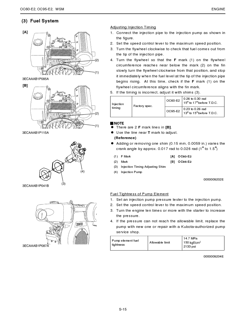

Your Kubota dealer (or the folk they shipped your IP off too) might can find out for you how to set "for diesel fuel" according to what their engine designer considers the best spec. Older MB for example uses the "drip" method. A tiny tube added somewhere and you meansure how much fuel drips out or something to that affect.balboa_71 wrote:... I wonder if there is a good solid way to check the timing????
Point is this ONLY sets it to a predetermined spec. One difficulty with tweaking for different fuels in a diesel such as veg oil fuels.... the spec. would be different and their is no "ordinary man's" tool to measure combustion to evaluate efficiency. Same would be for example if your using different injectors or your pump is really from a different model engine that you adapted to fit your engine orr....
Some I've discussed with use a uphill grade (but not a killer mountain) that does tax the engine a bit and drive it over a measured distance that they can use consistently and in easy reach of their home/shop. They drive it and measure speed over the distance. They keep toying with the IP till they get max speed.
The reason your engine is so quiet is because the head is oil cooled, surrounded by a sound deadening jacket full of oil rather than the amplifying effect of fins for air cooling.
If your only reaching 45 then it sounds like you are down on power but if the motor is new then it's not surprising as it needs 100 hours or so to loosen up.
If you have had the injector replaced then it should have been re-timed as manufacturing tollerances need to be accommodated in the setup.
It's not a difficult task to do, just takes a bit of care, but to be honest it's easier to do a running test after removing a shim and see if it improves.

In addition to the sound dampening effects of the oil, these quotes from the manual.
Regarding the pump element -
"The plunger is provided with a low speed retarder to maintain the combustion sound low under no load".
And with regard to the injector -
"Due to the use of a throttle type injection nozzle, the fuel injection quantity is small at the beginning of injection, and the fuel injection amount increases gradually for the main fuel injection. This type of injection nozzle features smooth combustion rise and quiet combustion".
If only we had those features for our clones.
