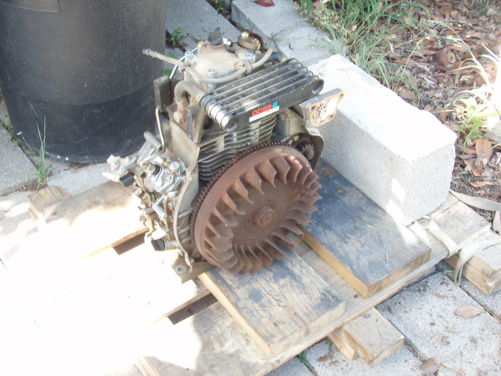

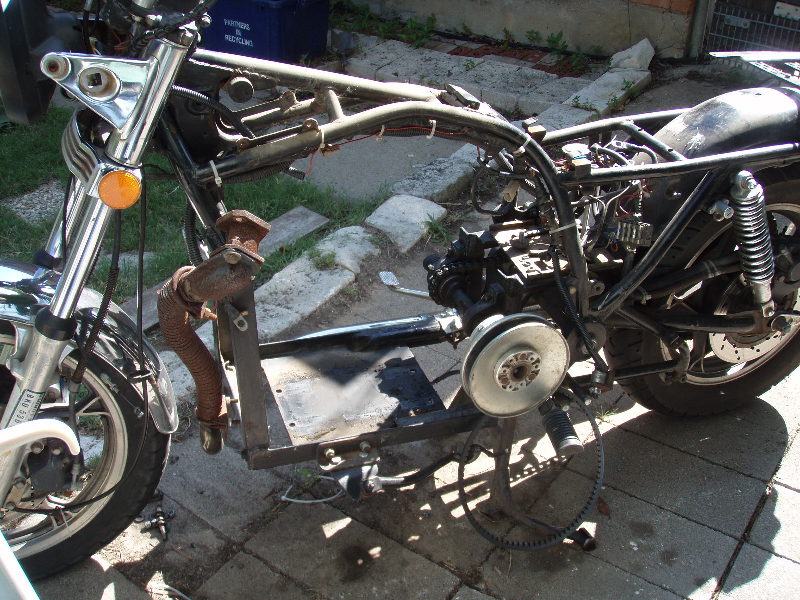

As you all can see, I'm about ready to get engine into place. After photos were taken, I had to drill and file extra hole to make it all work out. Took me a week of late afternoon HOT sessions, but I got it done. I'll post some pics of engine in frame tomorrow.
Cris
Another view
Another view
top of engine showing oil cooler
And yet another view
frame ready for engine
flywheel side of engine

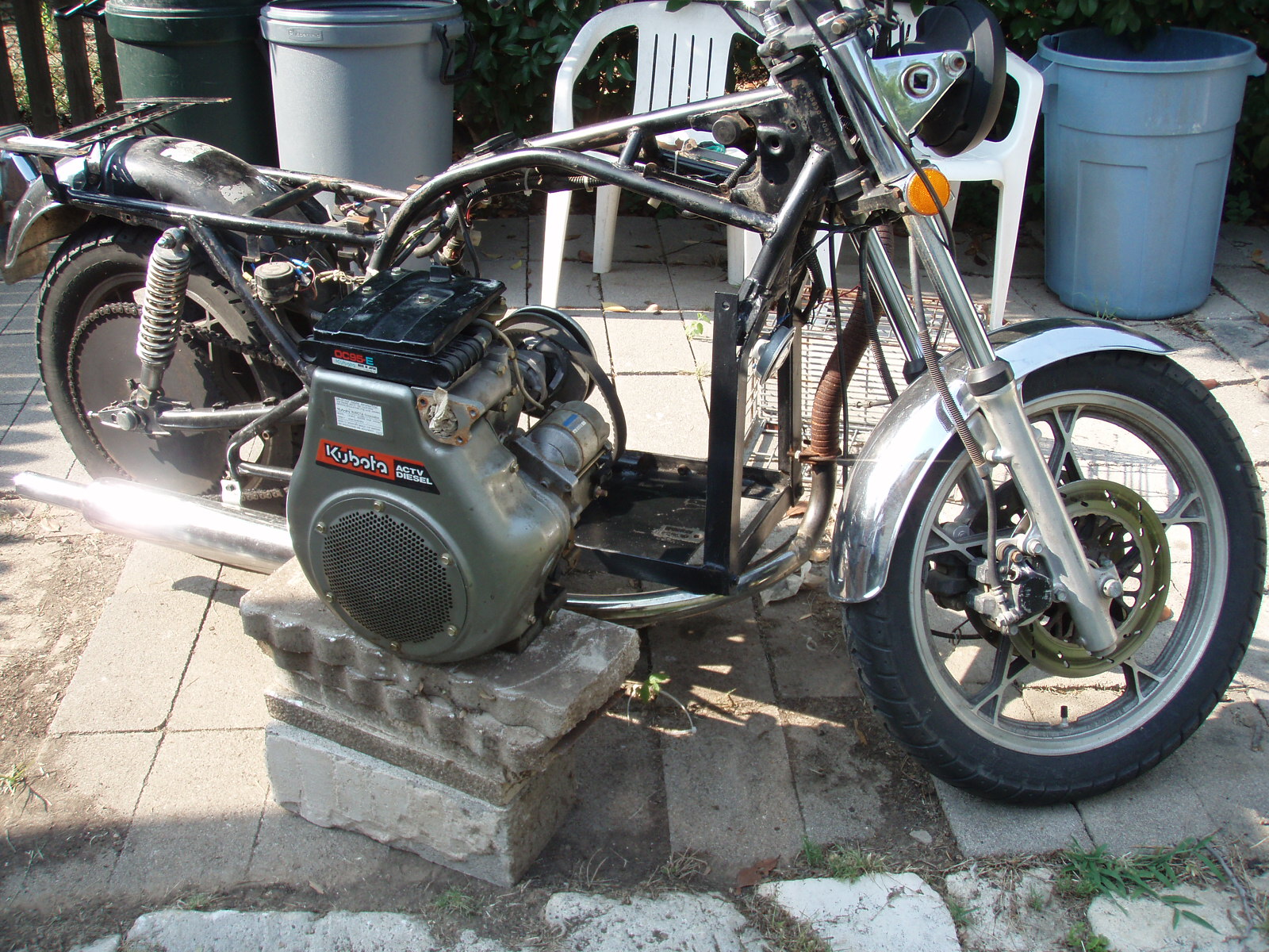

Okay, here are two pics of installed engine. Still have to do a few more things....

Looks really neat mate well done, cant wait to see how it runs :)
Re: Need members advice, thanks
yep looking forward to final build report for this phase and the road reports to follow
