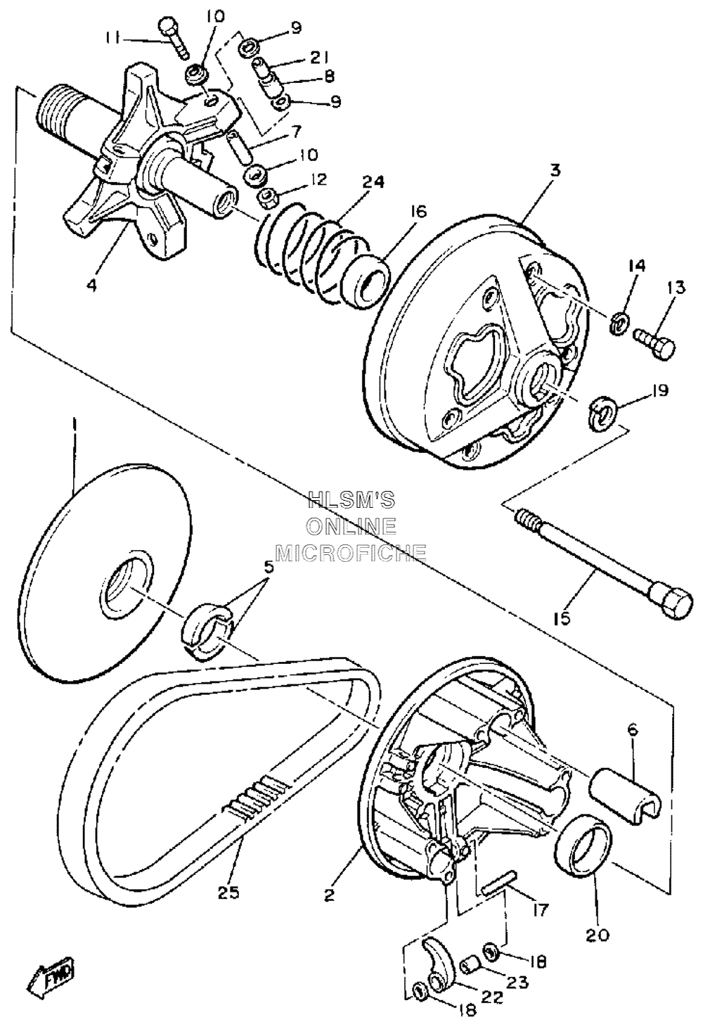

a whole sled is up for sale in the area might be able to use some other parts for the conversion but am pretty new to this concept.
kind of overwelmed to where to start, thought i could get a bulk of the pieces for the conversion from this sled.
i could save on some cash if it works but would i pay in hassle of making it fit and work?
i tried to add some diagrams of the clutch.
its from a 89 yamaha phazer 400= cc two stroke
appreciate any input.

Search out a shop that reworks Sled CVT's. Would expect it to take a total rebuild and tune to get a sled CVT to work on a diesel bike. Sled CVT RPM range is hugely different than a diesel engine on a bike. Thus the whole thing will need new springs, weights/rollers? to get the sled CVT tuned. End cost may be more than new cvt already set up from factory for your needs (700 to a 1000 buks?)

Hey welcome Nate. And this is the place to ask the questions. One challenge you'll have is that the tapered shaft typically has no keyway. Additionally, some are 26 MM which is quite uncommon and the taper is not consistent with the taper found on those few drive pulleys with a taper. Either way, you can't mount a CVT drive pulley directly to it. Therefore, your options are to pull the crank (which is not difficult at all) and have the crank turned down to 25MM/1" along with having a keyway cut in. Or................ cobble a keyless bush for a conventional pulley to a jackshaft on which the CVT drive pulley is mounted. The latter approach consumes both power and space. I say cobble because keyless bushes are not found in 26MM and thus you need to mount an additional bush between the crank and a larger sized keyless bush. Don't ask me why I know these things.
And as George noted, the sled parts are probably of little value for all of our combined reasons. Hang in there and we'll try to help out.

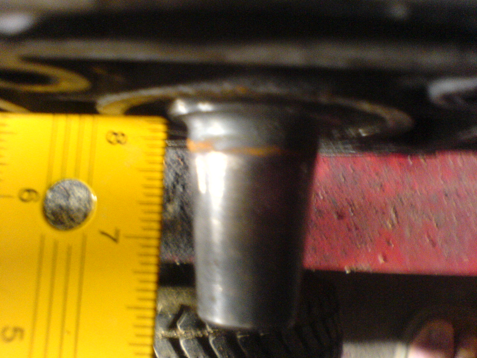

some pics of what i got,
don't know if i got enough to cut to 1 inch.
think there might be a clutch to fit a 3/4"?
thanks

Oops!! I'm afraid I assumed you had a tapered crank like several of mine. The ones I have are tapered on the end but have about 1 1/2" of straight shaft before the taper, which is the 26MM portion I referenced. Several chaps have machined a tapered hub to accommodate a taper such as yours. Also, check the various suppliers to see whether they offer in a drive pulley for a 3/4" shaft, should you turn yours down. A 3/4" crank might be pushing it with respect to torque loads. Perhaps someone else can speak to that.

I like the idea of making a taper to fit your crank. With a taper attachment lathe setup (or the cross slide on a larger lathe) it is not hard to bore either a tapered bushing to adapt to a straight bore CVT or to make a flange with a tapered ID to fit a larger CVT drive pulley. I would machine the crank for a half-moon key just to make sure that everything stays together, not a hard thing to do and with a little creativity can be done without pulling the crank. If you still have whatever was connected to your engine you could turn whatever it was down into an adapter bushing pretty easily.
