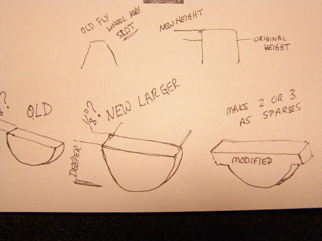

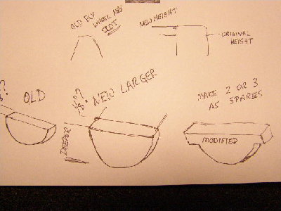

If the original key is an alloy make sure you use an alloy key to replace it with... there meant to fail to prevent crankshaft damage.
Common cause of shear pin/woodruff key failure:
1 rapid stop of flywheel (same as lawnmower blade which is part of the flywheel weight)
2 backfiring
3 loose flywheel nut
To remove the piece in the flywheel use a small pin punch and tap the inner end down into the flywheel the front end should rise up enough to remove the piece with side cutters or dykes.
The flywheel itself is a little harder to fix and will require you to hand file the slot a little deeper and square up the outside of the groove. It is possible to use a larger woodruff key and reshape the bottom to fit in the flywheel, just make sure the larger woodruff key fits tight into the flywheel, most are 1/8th or 3/16th
See the attached drawing don't go nuts on the flywheel just make it square
trial fit should go together without binding, binding will crack the flywheel (VERY BAD)
Make sure to use the proper TORQUE settings for the flywheel nut...
HOPE THIS HELPS A LITTLE.....
