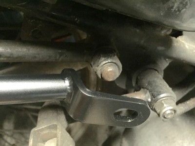

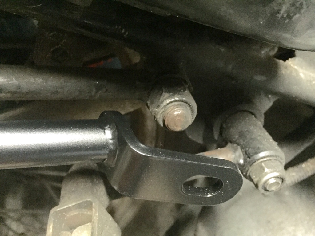

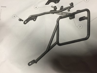

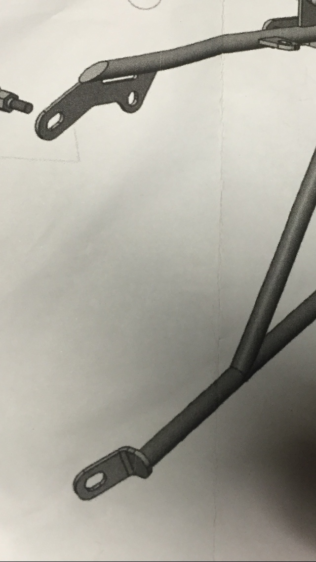

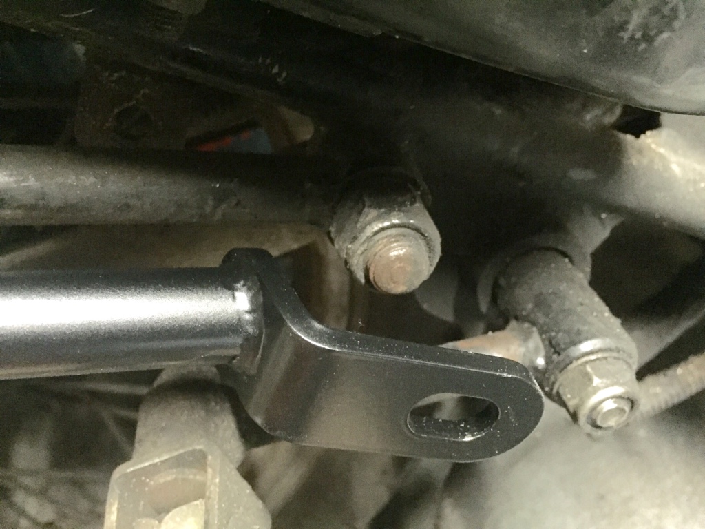

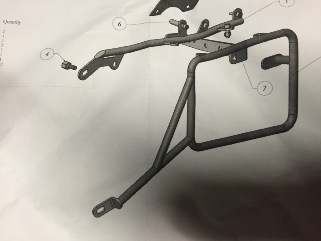

All holes line up fine except for the front lower, near to the rear foot rest. The fitment drawing supplied shows the lower frame bracket kicking inward (to secure behind the nut) but the frames we received has them welded the other way!
After contacting MM we were told that the frame was correct to their 'mechanical' drawing and that the fitment drawing only looked as it does due to Photoshopping to help assembly.

Personally, I think whoever made them has made the classic mistake of picking the incorrect part up before welding that bracket on. They have done what is known in the trade as a 180!
The upshot is that we are going to have to sort this ourselves.
I think they've had lots made wrongly & didn't inspect them correctly on delivery.
I'll post the pictures (taken from different sides of the bike - just to confuse things still further) and let you decide.

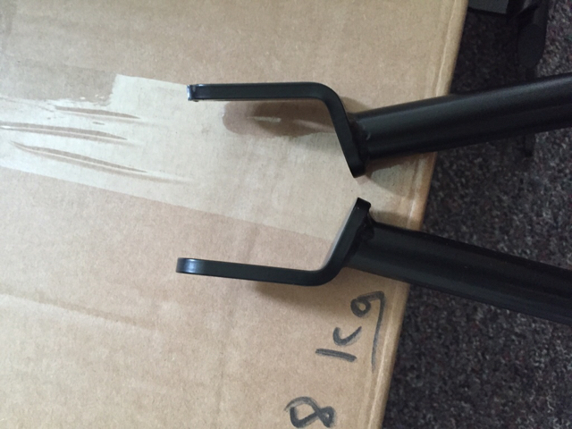

Here's another shot of both the offending brackets together.

Metal Mule only advertise one for the EFI are the older bullets different??
Also looking at your pics the angle seems wrong as the pannier frame tube to the footrest on other examples on the internet seem to come outwards(and the fitting illustrations) from the suspension units not inwards as in your last pic??
If you swapped them over in the last pic keeping the brackets parallel without any other info I would say that would be more like it?
Do they fit on the other sides of the bike ??
Bit difficult to see when it's just the brackets rather than a whole pic of the frames so apologies if I'm mistaken.

Their drawing doesn't look right yeah. True, they are for the EFI model Bullet but the bracket in the drawing is still 180 out to actual metalwork.gilburton wrote:Metal Mule only advertise one for the EFI are the older bullets different??
You can't fit them on other side as all top protrusions point inward correctly.
