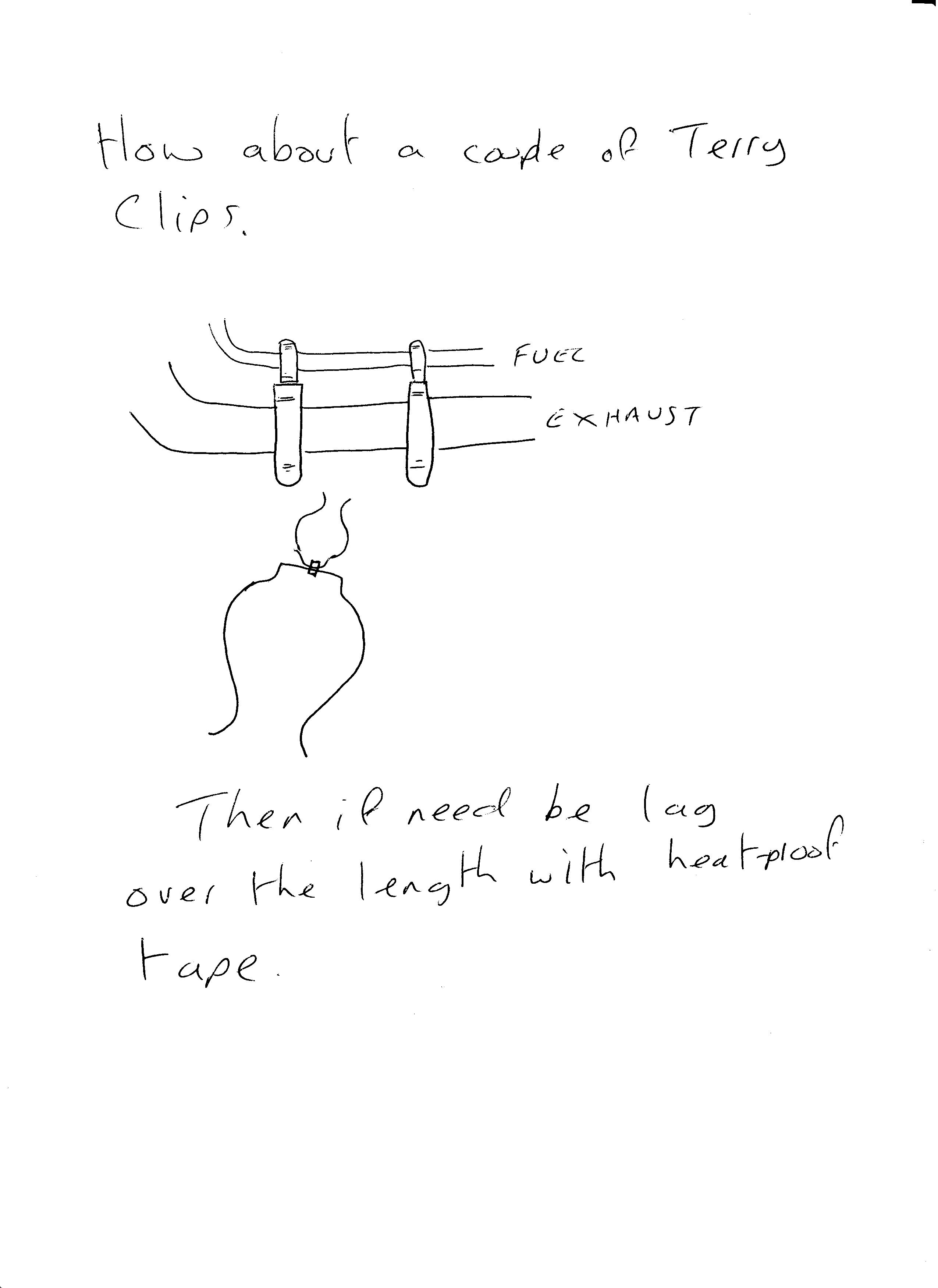

How about this idea?

Eddy Wane wrote:How about this idea?
Yeah, you could put Heatsink compound under the clips to help transfer.
I like that idea, althought I dont think it will put that much heat into the oil, I think the pipe would have to warp around the exhaust pipe, but then we have the issue of overheating the veg.
Re: A way to heat fuel
You would need to form the copper pipe in to a coil larger than the dia of the exhaust pipe so that it is not actually touching.
Possibly another idea might be to wrap the exhaust with a couple of layers of heat wrap which might bring the temp down to acceptable levels??
