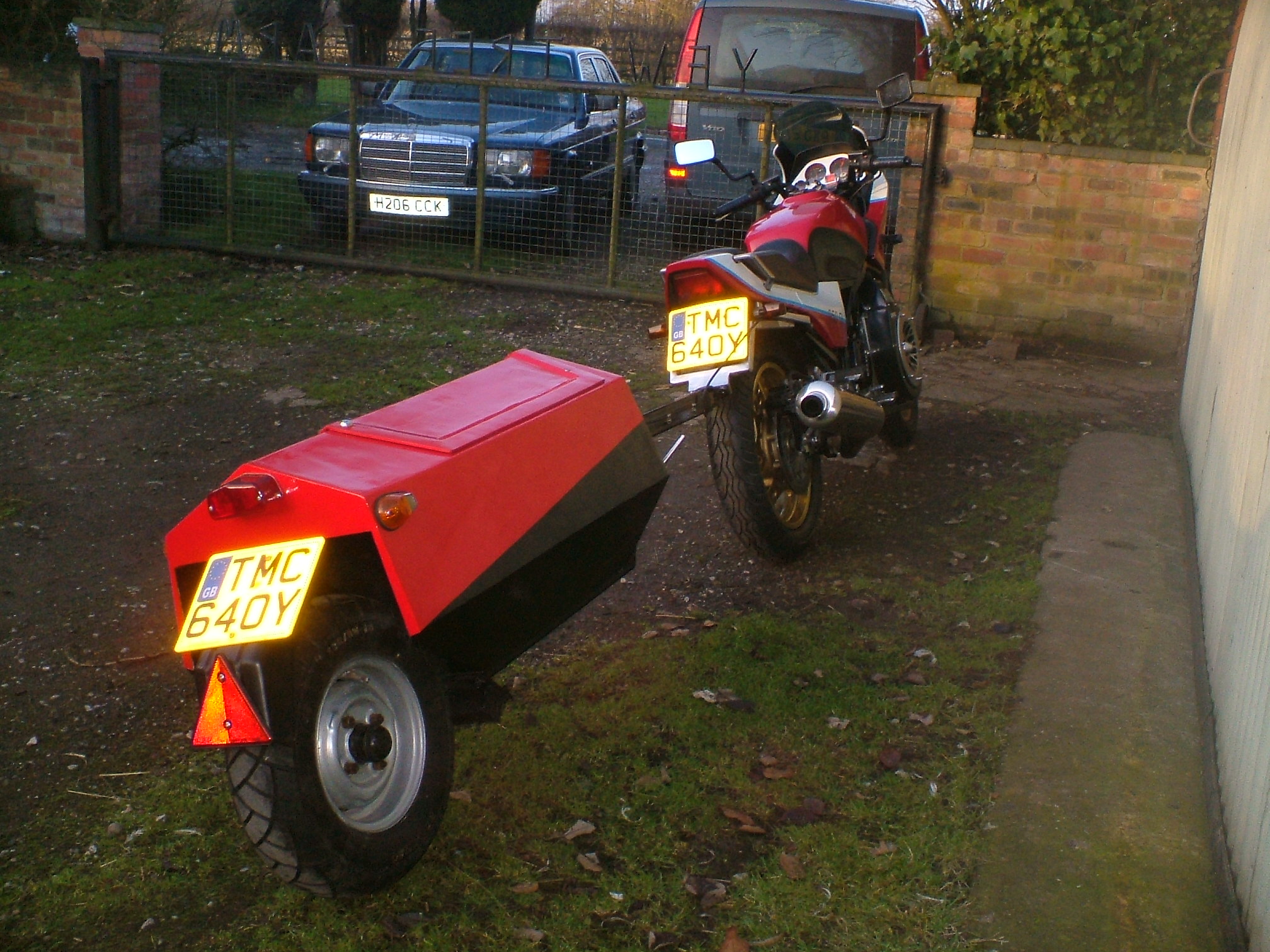

I use a standard ball hitch for my two wheeled trailer and it works just fine. OK so if the bike falls over it will pull the trailer with it but I live with that. I've seen others who make a separate swivel joint in the drawbar of the trailer but I've not followed that.
I've also made a flatbed trailer for the bike which I use a lot. for both two wheeled trailers I've basically taken a old standard 8" wheeled car trailer and cut them down to 1m wide
And as someone else said the vibration is much more than you'd expect so watch sensitive equipment or things that will show chafe marks if they vibrate against each other. Having said that I've carried PCs and electronics wrapped in blankets with no ill affects.
I've used these trailers for several years behind several bikes including on long motorway journeys and never had any interest from the police with one exception. Which was when stopped by the police with virtually no lighting on the trailer and no mudguards and I got a ticket for that. You may have seen it on TV
I also have made a 1 wheeled trailer using a cortina prop shaft UJ. Pulled like a dream.
