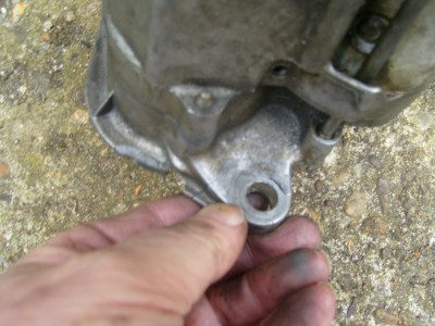

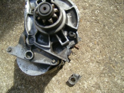

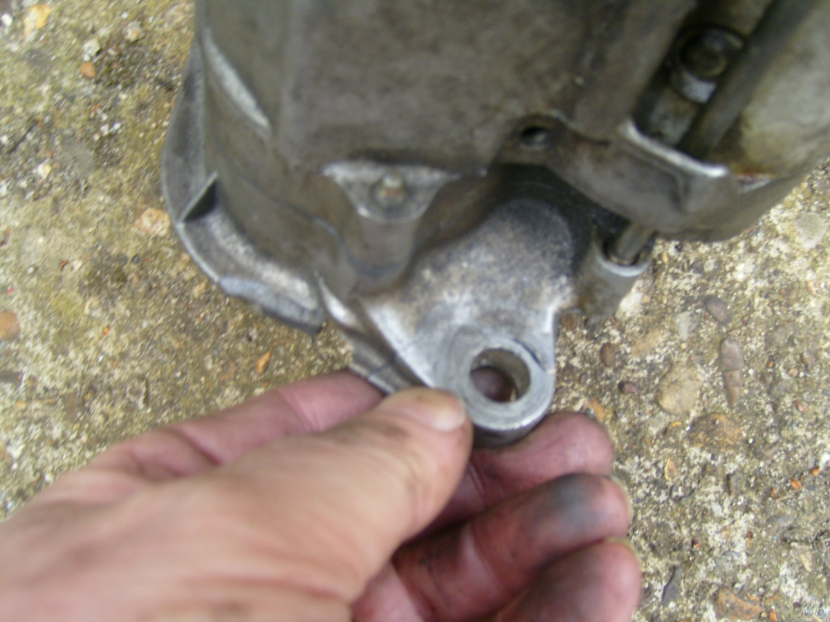

Here is an update. I've now removed the starter and have taken some pics. I don't see any reason why it couldn't be alloy welded. There is plenty of room around it for reinforcing particularly on the inside as the casting is hollow.
This type of starter appears to be a later type that is of higher torque and is mounted to a plate which is then mounted to the normal starter position and appears to be a genuine later type modification.
It's this adapter plate that appears to have been the problem as the bolts holding it have come loose which in turn appears to have allowed the starter itself to move causing the break The joys of diesel motorcycling
If a standard older type of starter could be found (part numbers above) this could then be bolted straight to the crankcases without the adapter plate which would solve the problem!

The starter casting is off and I'm trying to find someone local who could repair it.
Has anyone tried the low temp brazing method Lumiweld etc??

I eventually repaired the starter using low temp weld and a steel bracket sandwiching some chemical metal in between for good measure lol !
