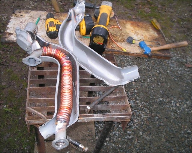

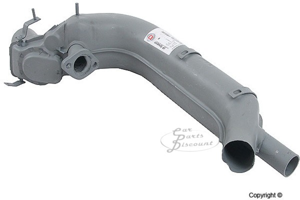

That's the kind of thing Coach. An outer sleeve to better use the generated heat. If only our exhaust pipes weren't so individual! I found a couple of pictures of the VW pipe here
