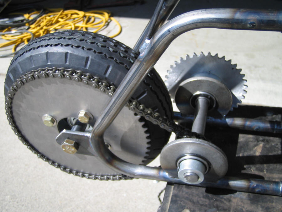

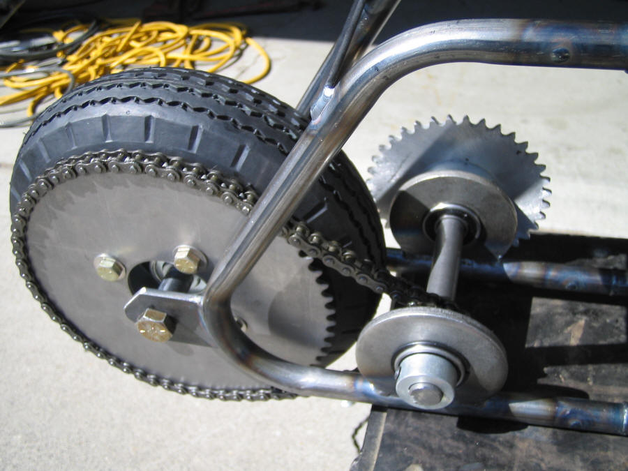

Re: Smallest lightest engine?
Well I would take the easy route and use a shaft. If you made up a flat plate type mounting(similar to the bicycle kit) but make it a bit longer with upright supports each side at the rear to take a shaft/bearings. This could then be mounted on top of your original mounting if you want to keep the bike original?? Looking at the bicycle kit it looks to have a small shaft protruding out with the sprocket.Maybe you could get something similar but extend this shaft a bit using a small coupling designed for electric motors?
I find http://www.bearingboys.co.uk to be very good for bearings/sprockets/bushes. You can get most stuff on Amazon as well and obviously your local bearing factor. You could try kart places for shafts etc. But I actually got my jackshaft kit from the US as you don't seem to be able to get them over here. You can get them made up though.
Enter kart jackshaft kit and once again look at images and wonder at how lucky the US is.
This is on ebay UK but still the US. It's similar to mine but I used pillow block bearings as I needed something stronger should be ok for you though? http://www.ebay.co.uk/itm/5-8-35-Jacksh ... 0983873882
