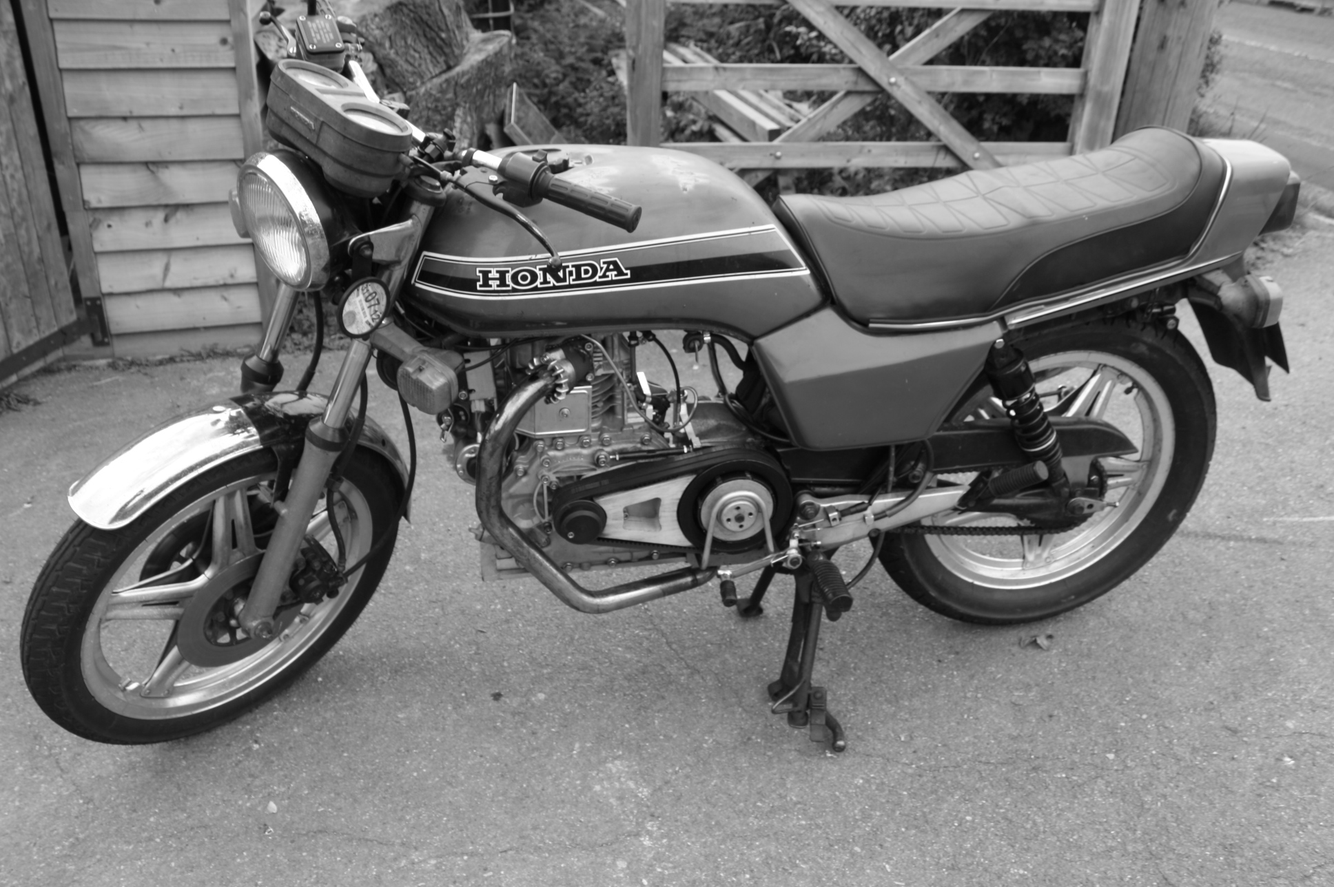

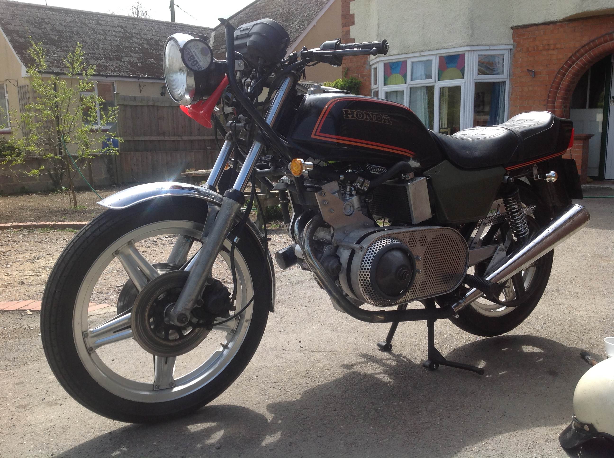

Kubota Z482 Honda Superdream from Somerset

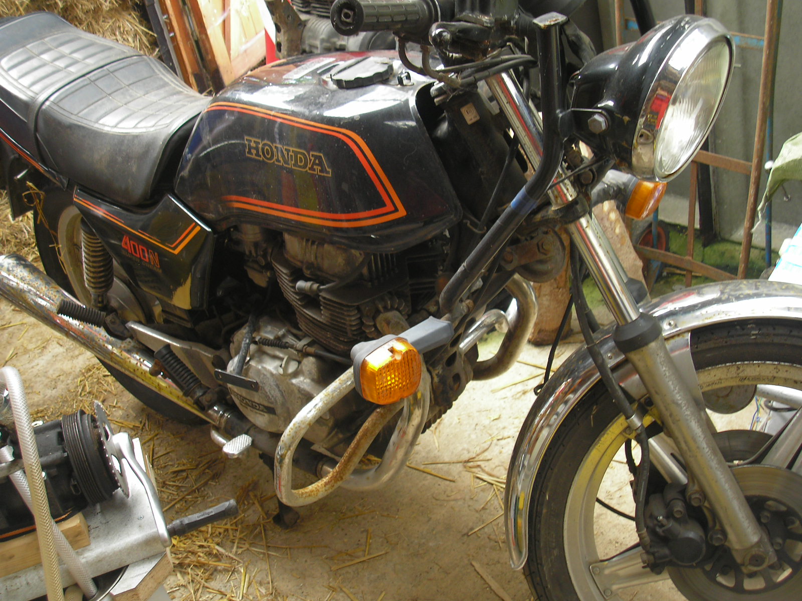

Hi all
I like my current Superdream fitted with a cloned Yanmar 186 engine . I fancy something swifter and smoother for the next Big Knock meeting.
Current Bike Specifications of the new build
Create a super simple conversion, requiring minimal technical and minimal machining skills. Low cost is a priority
Engine Kubota Z482-E removed from an Aixam car, Transmission CVT type belt drive from the same Aixam This 1990 model with gearbox problems purchased from Ebay for £300. Road Tax refund generated £90 and I sold the rest of the car for £100

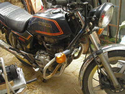

The Donor bike was a Honda Superdream 400 non runner with fairing and top box for £200
Bill so total
This makes the total outlay £310 for the engine , transmission and bike

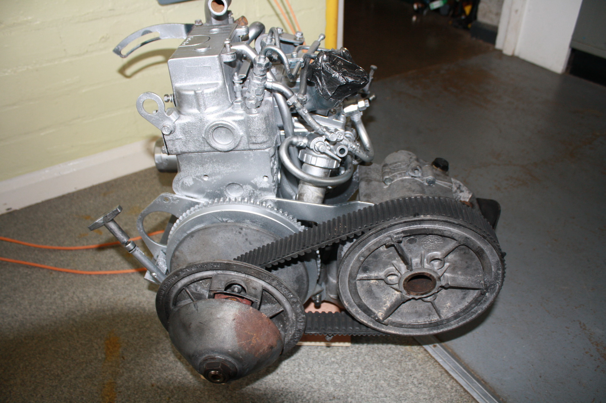

Using the CVT transmission from the Aixam will sort the clutch and primary transmission + ratio changes.
The Aixam transfer box will be replaced with a counter shaft fitted with a toothed flat belt drive to the rear wheel .
I am hoping there is sufficient width to allow the toothed drive on the same side as the CVT . If not I will flip the rear wheel to get the drive on the other side In a funny way the start for this project is the rear belt drive as preferred sizes and lengths means I will gear it for theoretical 78Mph at max RPM

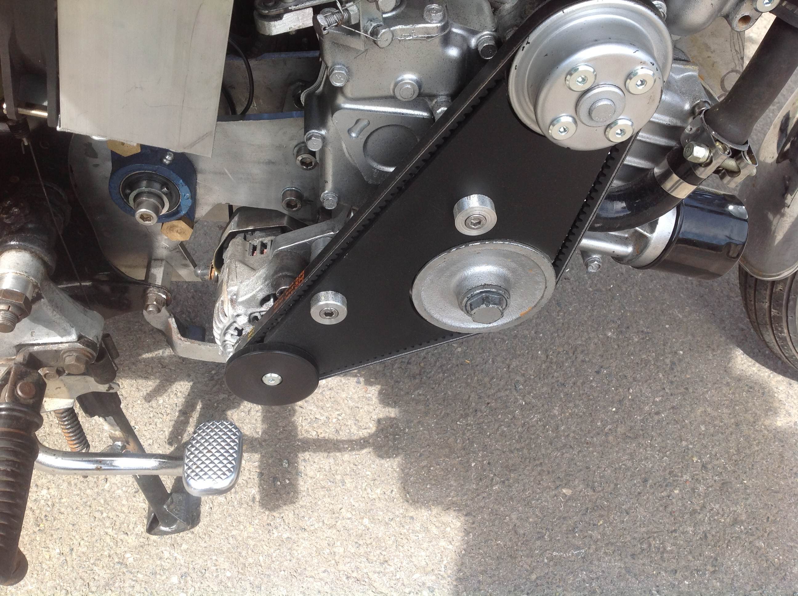

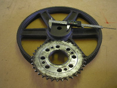

This translates to the final drive ratio of 6:1 and pans out to a 24 tooth front pulley and a whopping 144 tooth rear pulley and 30mm wide belt looks OK but will be tight in width clearance.
On the look up chart with 1800mm long belt the pulley centres would be 542 mm apart which is looking possible
Cost pulleys £120 for both + Belt @£25 Next job is to sort the jack shaft. This in mounted in two bolt flange self aligning bearings on 25mm ID the right hand 20mm ID

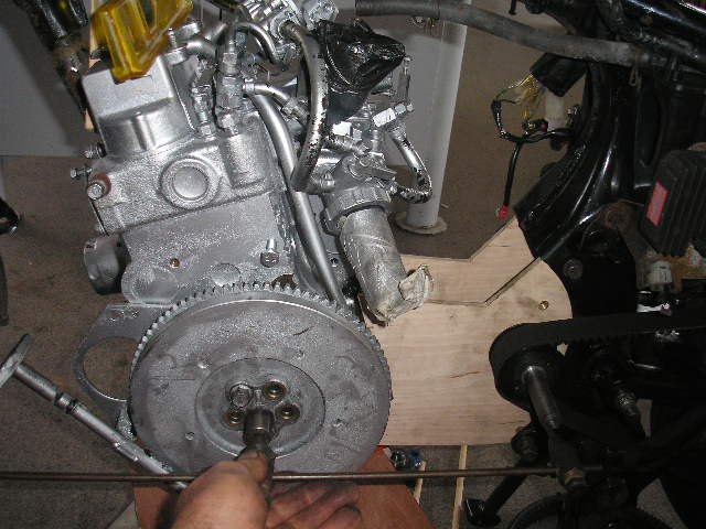

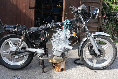

With this I can now make some ply wood pattern engine plates to sort out the alignment and critical distances before manufacturing the alloy set.
I have got over excited working on the build and failed to record the progress . Here is the finished product as yet untested!

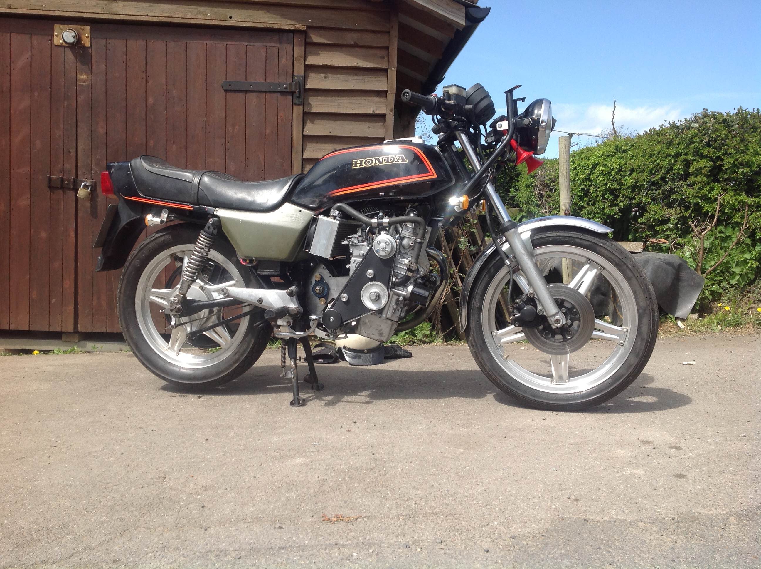

Looks good.
You wont be disappointed with the Kubota Z482. I've just clocked up about 15000 miles on my BMW Z482 conversion and the engine is solid and has never let me down.

Can you pull the part numbers off the Aixam drive and driven pulley? Wanting to compare and see (if these are made by CVTech like folk assume, which model they are. Do you have a source for these? Model number for Axiams of other Micro cars that used this set up would be helpfull too.

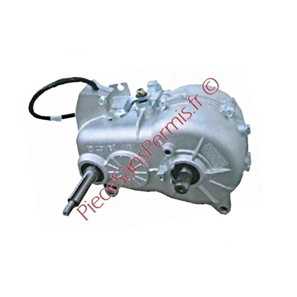

How does the Aixam CVT drive the rear wheels when its actually in the car? Are you going to have a belt drive to the back wheel?
Just seen this, glad you are going through with the Z482 superdream as I am also doing something similar with an XJ600.
Re: Kubota Honda
The aixam is front wheel drive. It has a gearbox that gives forward and reverse and a small diff to the drive shafts.I believe Tim is removing the gearbox and discarding it and mounting the rear pulley on a jack shaft. Mine is a 3/4" jack shaft. This is mounted on 2 pillow block bearings on a vertical steel plate and the final drive sprocket or pulley can be mounted on this shaft also.
It might be possible to keep the gearbox and lock up the diff and mount a sprocket on a drive shaft output?? but this would depend on available room and these gearboxes aren't known for being reliable

Aha I see what you mean, I did think that block was a diff of some sort. Seems relatively easy to get a sprocket off the end of that.
If I can pickup an Aixam engine+gearbox I can use the existing CVT to either use it in that form, or use the CVT to make an adapter to drive my gearbox
Re: Kubota Honda
Hmm yeah it will also introduce drive train losses.
Does it a take drive from a splined shaft that comes from the CVT? I could pull the box apart to get the shaft, depending on what is available.

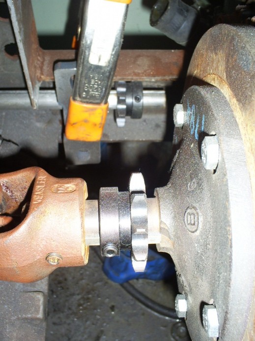

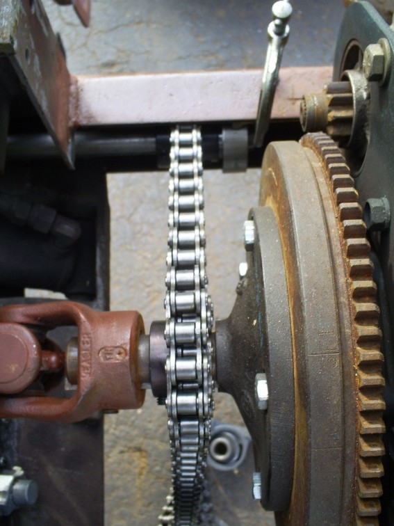

If you look at Tim's pic, the one with the flywheel facing you and the plywood mounting brackets, blow the pic up and you will see the small tapered shaft that the cvt pulley mounts to. This is just bolted to the flywheel bolts. You could get a round plate welded to this so that would accept sprockets?? I believe these are available commercially at industrial drive suppliers.
Or get a 1" or 25mm stub made up with a key way and weld that to the adapter then you could fit taper lock sprockets.
If you hunt around industrial machine suppliers you will probably be able to get a straight adapter to fit the Kubota.

I would look for Kubota dealers in the UK and possibly in the U.S. as well(I got my jack shaft from there) as I expect it will be expensive over here.
I enquired about an adapter for my Robin engine and they quoted £75 for one!!!!
Possibly someone on the forum who has access to machining etc could help you out when you get the engine??
As I have said on a previous post it would be better to get the complete engine/transmission as Tim has done then you can sell off the bits you don't want.
If you get a complete car you will also get the radiator,alternator etc.

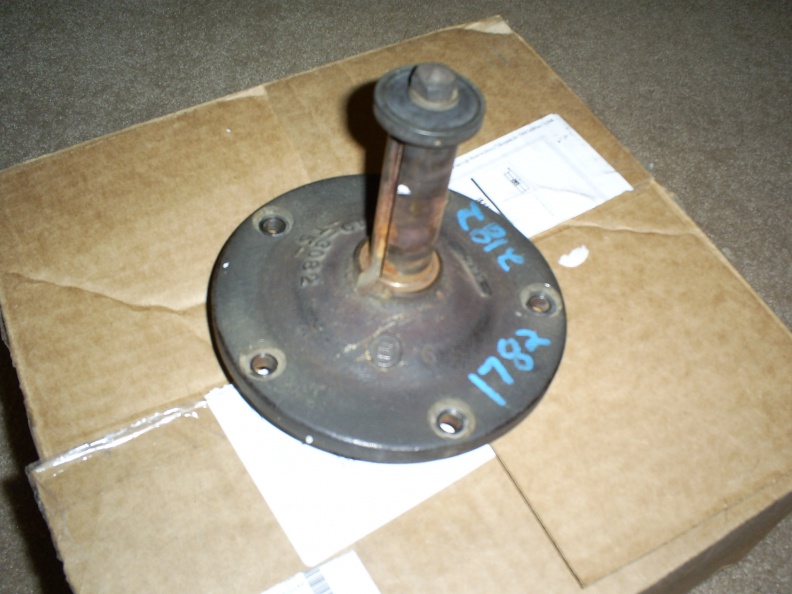

It would be great if there was just an adpater i could buy, bolt to the flywheel, and have a sprocket on the end! sorted!
Kubota does indeed make a stub shaft adapter for the flywheel as seen in the pics below. Not cheap from Kubota. But these engines were used a good deal in refrigeration applications where the compressor was driven by a pulley on the flywheel. You might also consider snooping around a breaker who specializes in such things to see what they have. Mouse might know more about that sort of thing. And if the flywheel is drilled to common SAE dimensions, any number of companies supply SAE stub shaft adapters. But again, not cheap.
gearhead1951
- Posts: 129
- Location: scotland uk
Re: Kubota Honda
That adapter looks like fairly simple part to make on a lathe , two piece if needed !!

And here are the dimensions if it's the B1 flywheel pattern.That adapter looks like fairly simple part to make on a lathe , two piece if needed !!
Bolt Circle: 130 mm (5.12”)
5 bolt pattern: thread hole size M8 thread pitch 1.25
Pilot Diameter: 106 mm (4.17”)

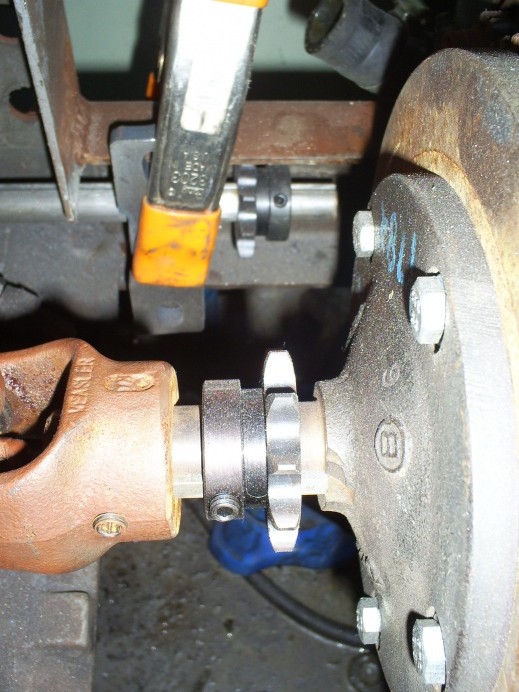

I made one for a kubota with 1/2" plate and 1-3/4" shaft tapered to 1-1/8" for the comet 94c.

Re: Kubota Honda
You could try this:
https://www.dieselbikeforum.com/view ... haft#p7023
I'm going to use this sprocket:
http://www.surpluscenter.com/item.asp?i ... powerTrans

What are you using for an alternator?
Sorry for the slow responce I have shoved it behind the engine. I may need an idler if the belt wrap on the crank pully is not sufficent and slips !
