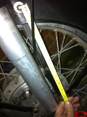

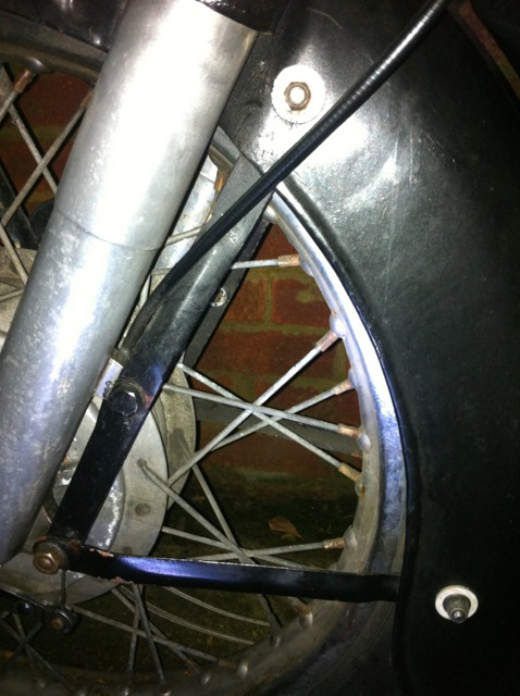

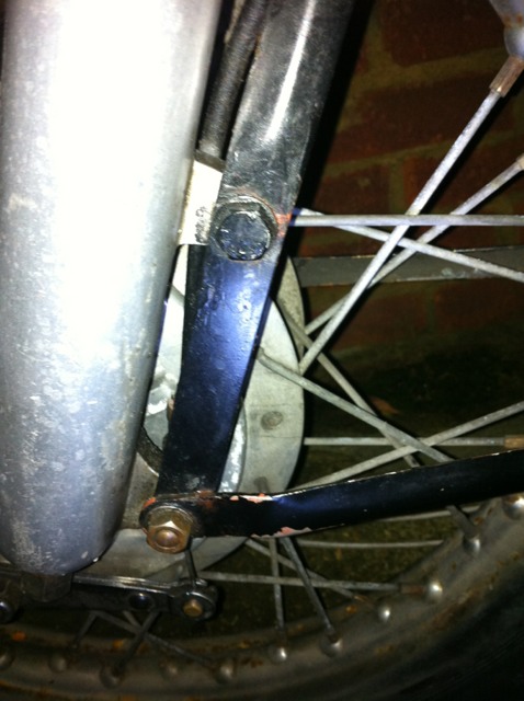

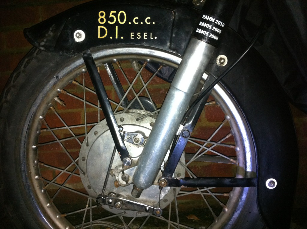

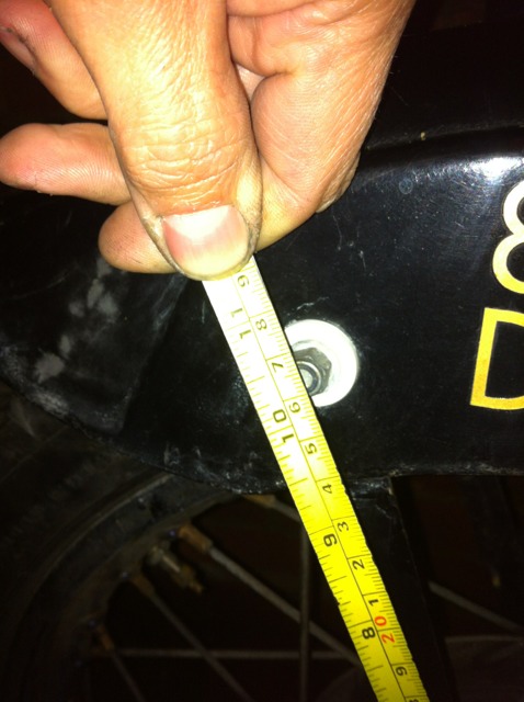

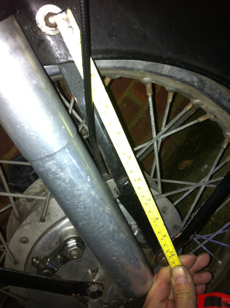

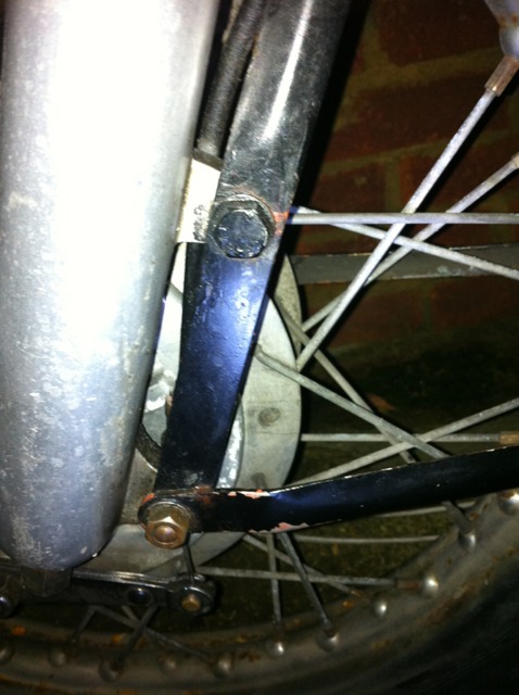

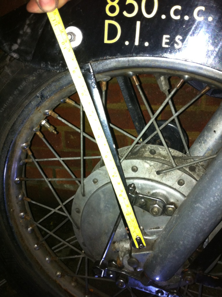

Ok, here are the Dim's for the Ruggerfield's front mudguard struts. I've measured centre to centre. Note that there are slight bends in some.
Front vertical is 10 & 1/4 inch.
Second vertical (bolted to rear of forks is again 10 & 1/4 inch. Measuring up from the bottom, it's drilled at 4 & 1/4 inch point to take 2nd fork fixing.
The horizontal rear strut measures 8 & 3/8 of an inch.
Second time today I've been under the tarp taking shots of the old girl :-) She must think something's up, all the attention she's been getting :-)

Thanks Stuart, this will save me a lot of time balancing the mudguard on blocks to approximate the required lengths. :D :D :D
Regards, Phil.
