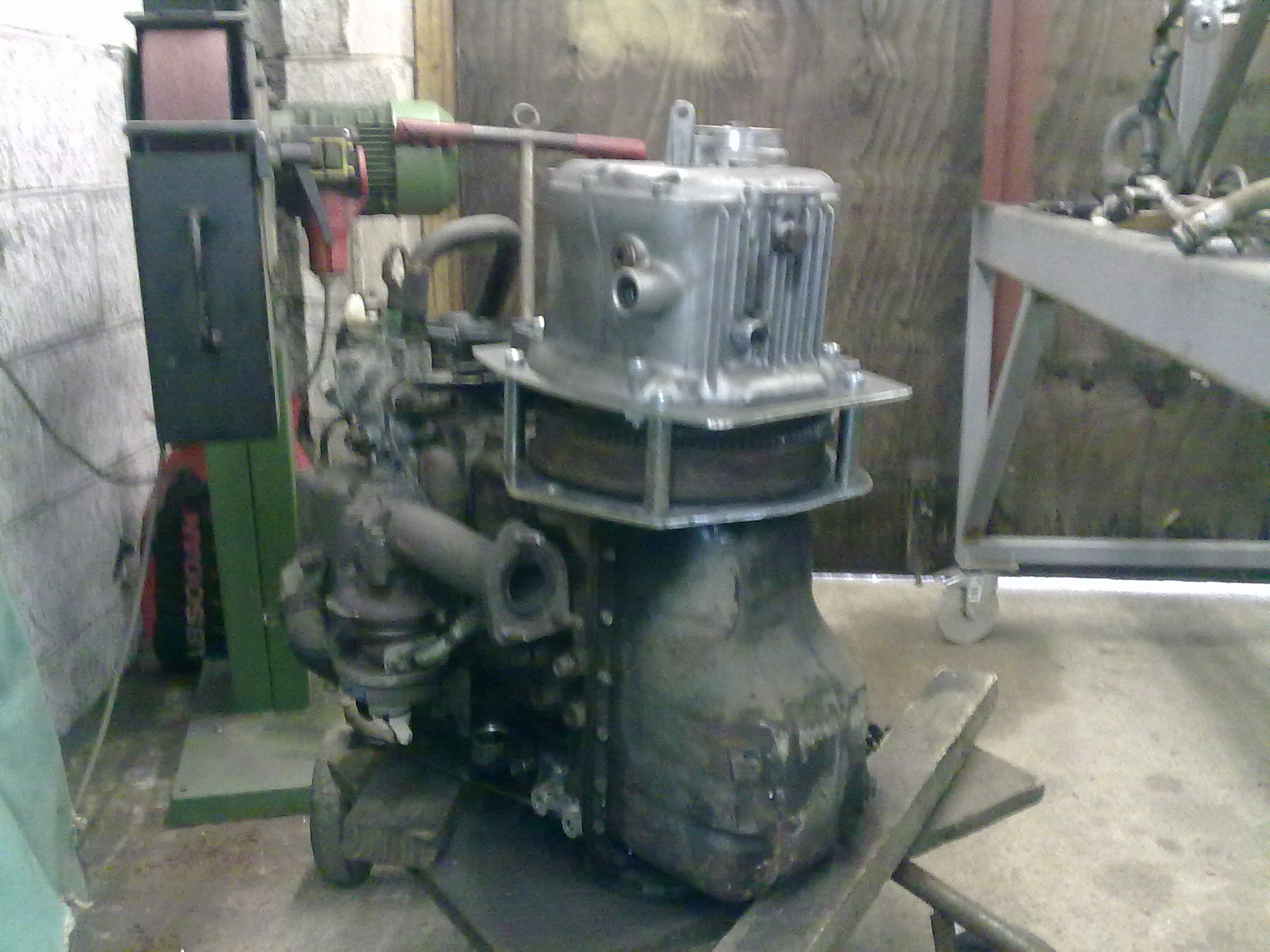

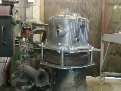

Hi all, got a bit done on my outfit so, hopefully some pictures. The engines laid on its front but thats not how it will be in the bike :lol: That gearbox does look big but its a bmw R65.

Hi Mark, flywheel is machined and clutch is mounted, and the way the engine and box fit together there may be no need to make another ring gear. In its original position the starter was in the side of the daihatsu bell house, but it should sit central above the bmw gearbox and mesh onto the ring gear to start the beast. :P
