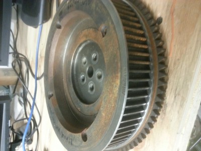

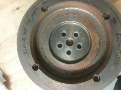

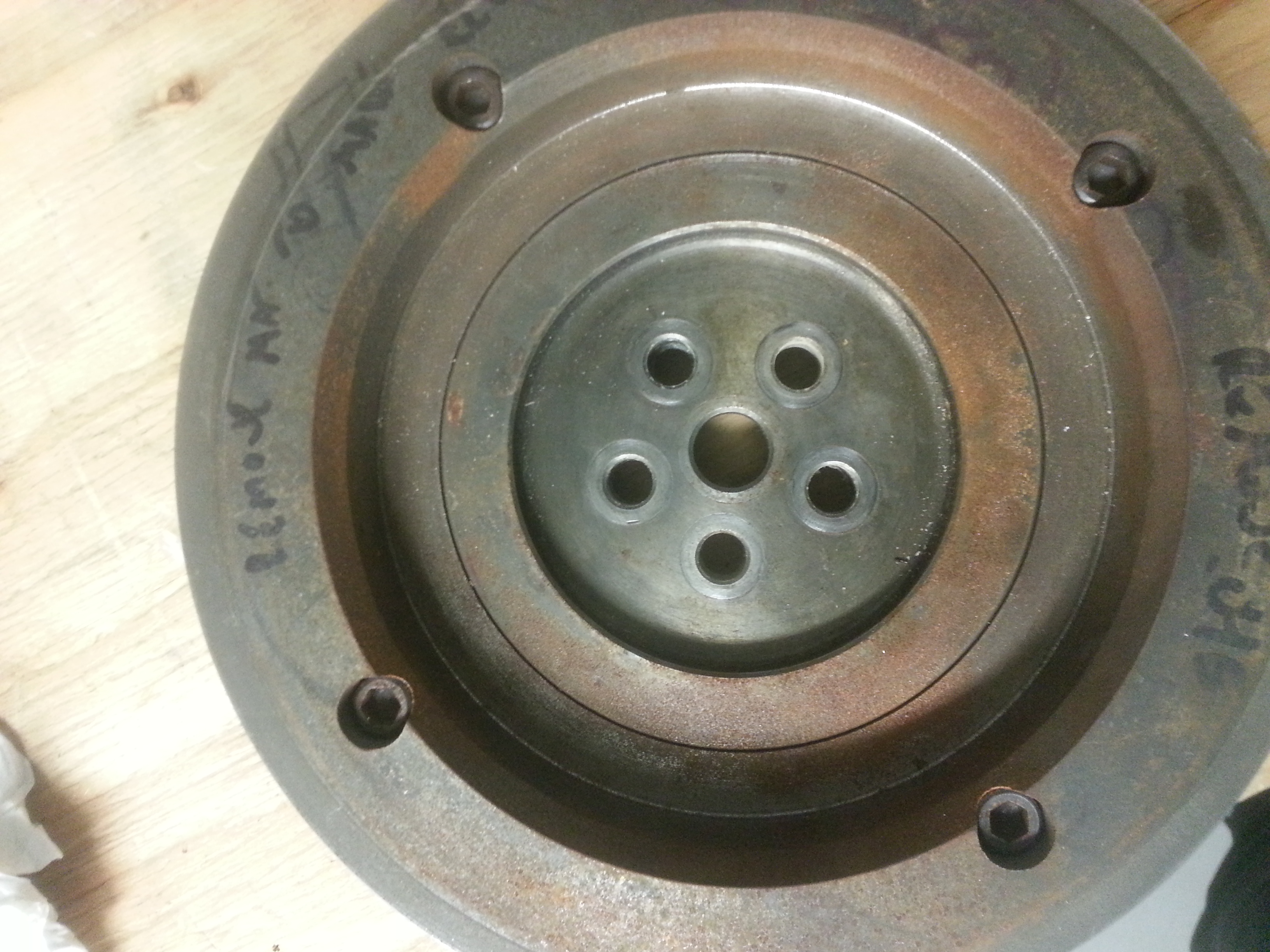

Yes, I have studied his contraptions. I even suggested using an R80 gearbox in one of my earlier posts.
The BMW gearbox, doesn't have a kickstarter and kubotas come with a one way mounting of the flywheel as I think that has to do with the external balancing as spoken off before.
The bolt holes are offset by a few degrees so it only mounts one way. BMW flywheels are not offset.
That and I do not think there are readily available gears for an R80 gearbox to change the gearing.

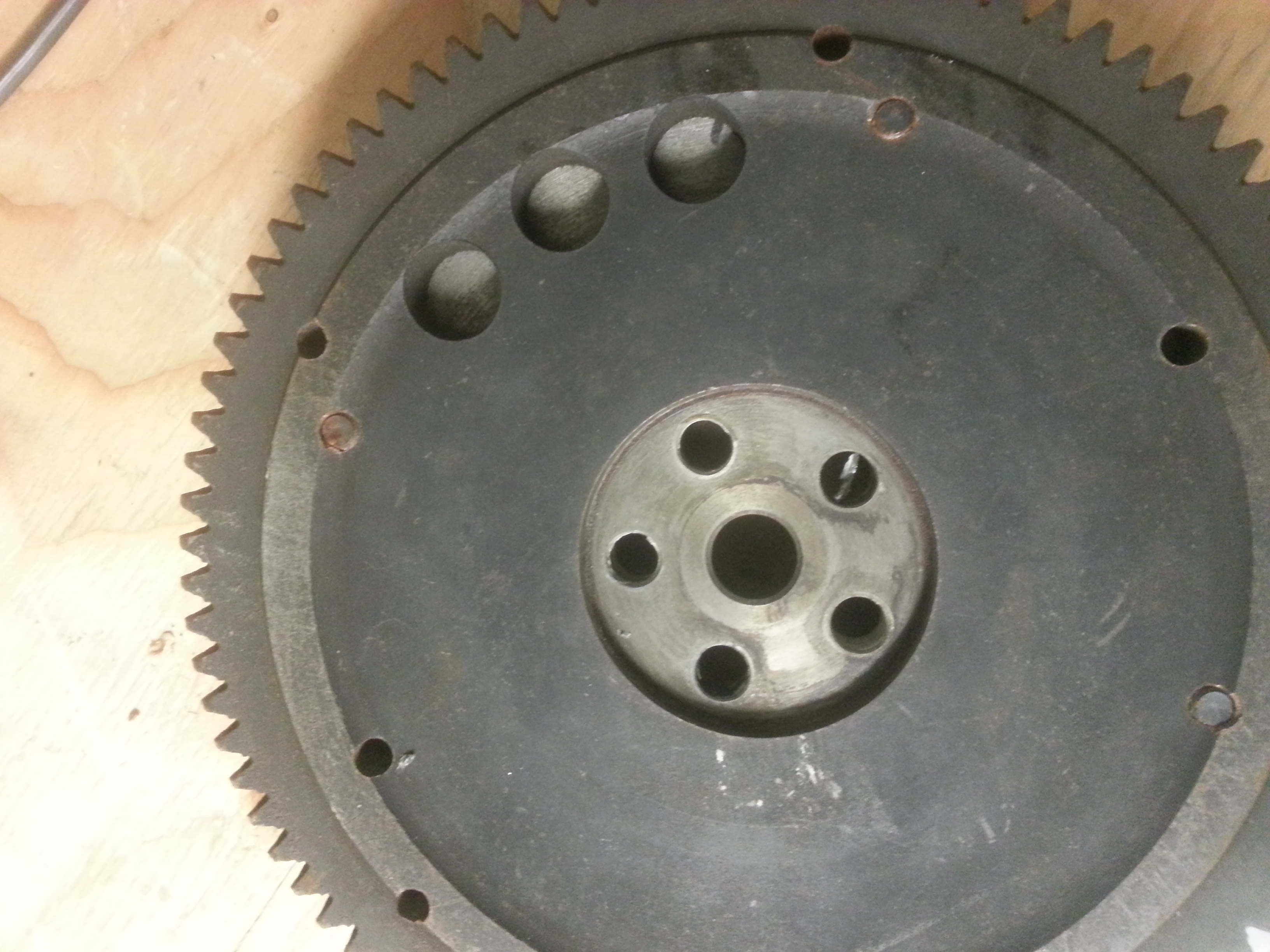

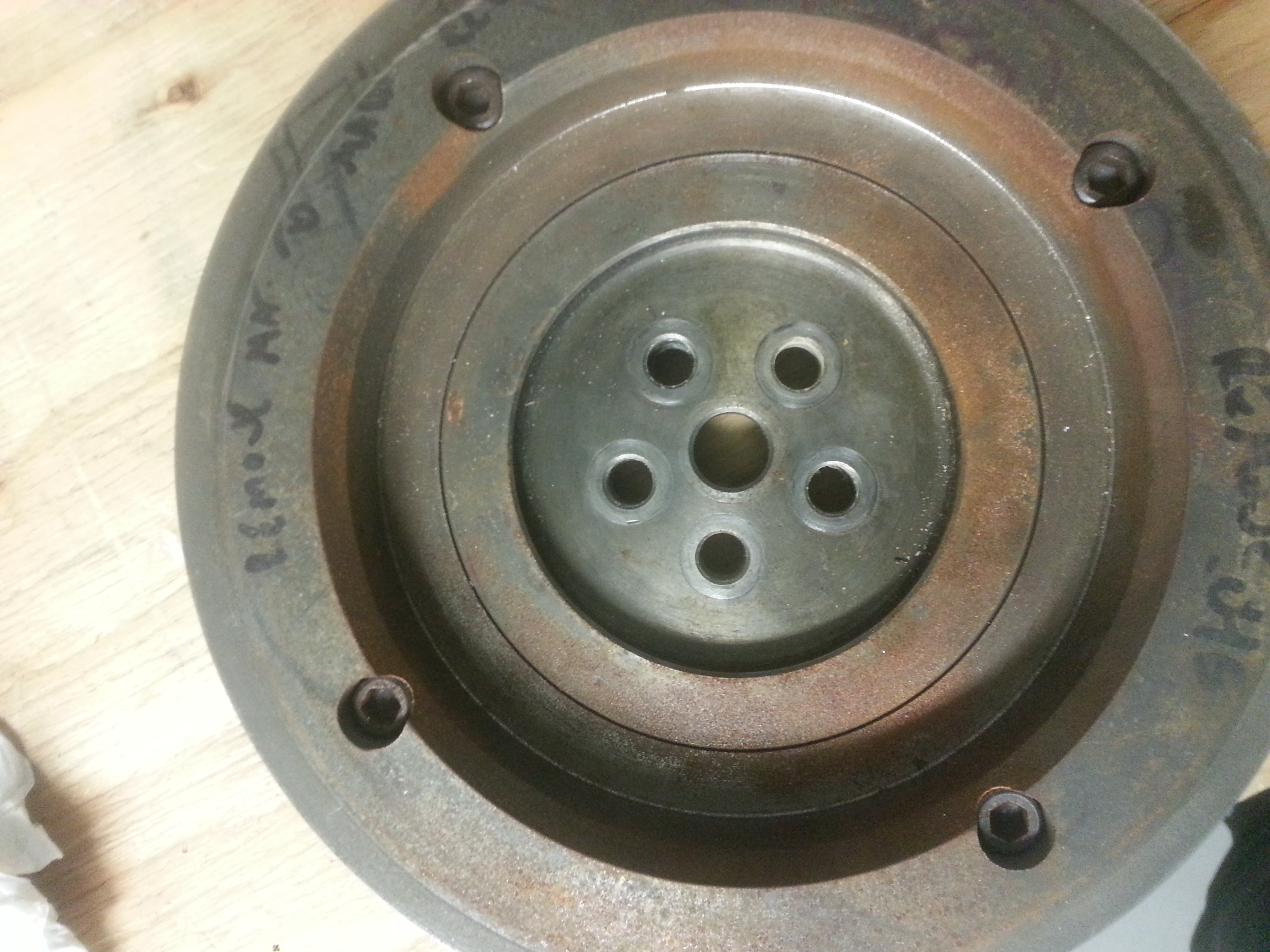

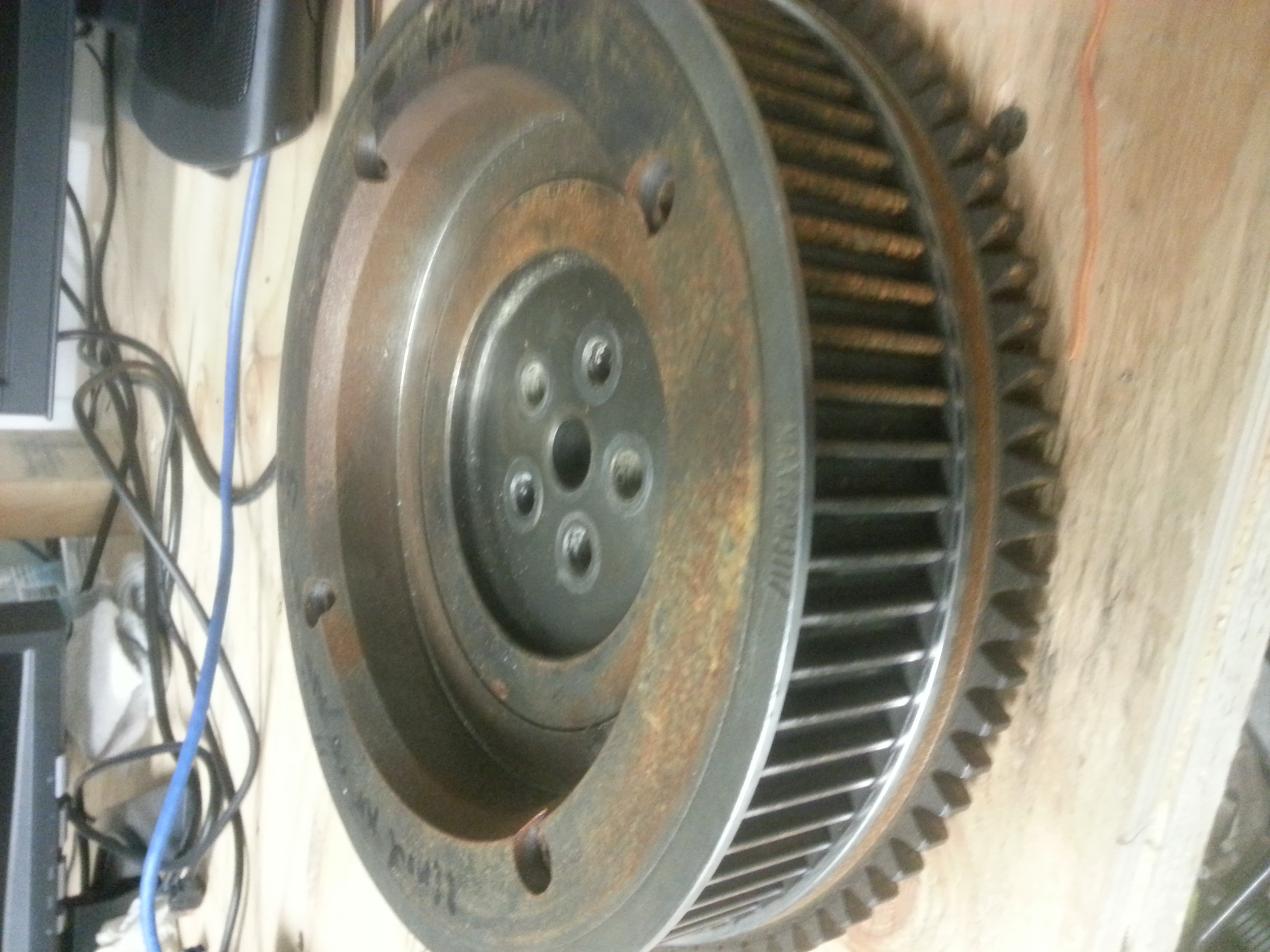

I vote for the kink frame design. Thay way you keep your ground clearance and room for a gas tank around the top frame tube. Second choice would be the double tube design.
My D722 came with a starter which doesnt have the housing on the front, maybe you can modify one or get one similar to mine. This way your third try would work. The 4th try could work well too if you cant solve the starter issue. [/img]
For my bike I mated the flywheel to a very big and heavy htd pulley. The kubota flywheel was machined as much as possible while keeping clearance for the starter cog. A centering ring was left on the kubota flywheel for the machined htd pulley to fit over. The center of my htd pulley was machined out for secondary clutch clearance (nose spins inside of the hollow). The finished combo was lighter than the unmodified pulley by far and close to the original flywheel weight. Doing it this way, mating them together, you know the spring holes and clutch pins are all perfect positioned. My machinist threaded holes through while they where mated so 4 allenkey head bolts hold them together. In machining the flywheel, a small portion of the balancing holes was removed, about 2mm. In the picture you can see the backside of the pulley through them. I would have prefered to machine the holes back to stock but a forum memeber pointed out that the pulley likely had enough imbalance to cancel the small amount out anyways. If you were to premeasure the depth/volume of the holes, you could machine them back to stock size once the two were mated.

Best case scenario would be to check the balance of the flywheel before modifying and rebalance the assembly after to match. This only needs to be done if you machine enough off to reach the balancing holes.

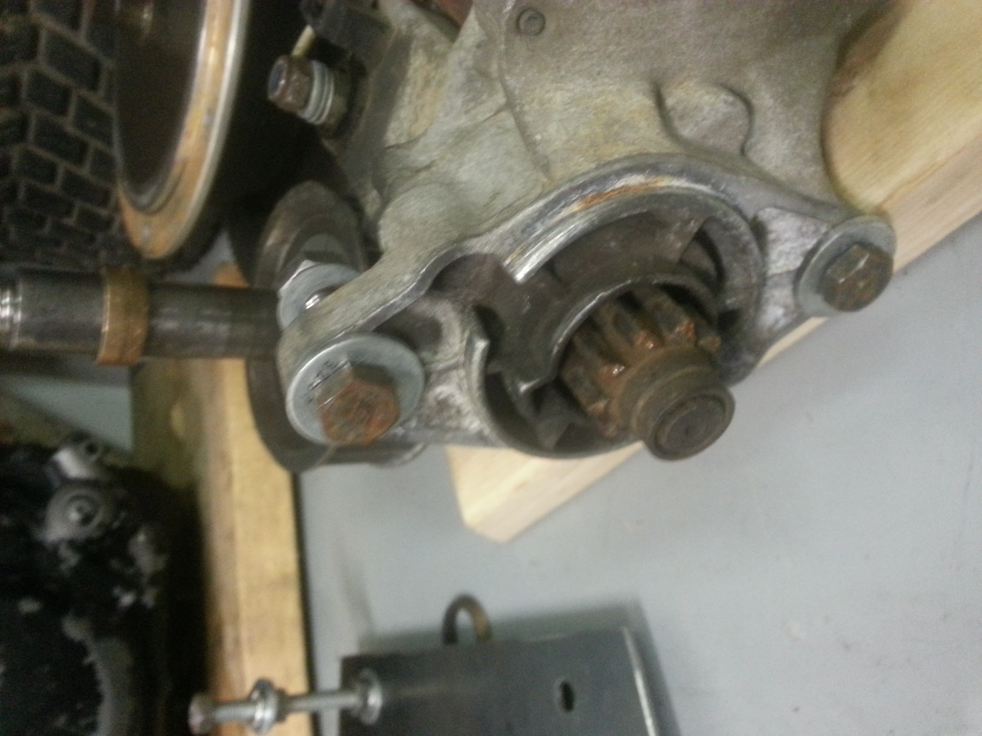

That'd be great, because that housing is really causing me a headache. Yes I was also thinking off using the kink frame design, just wondering if the frame is strong enough the hold the weight. And I'll lose the cool gas tank then...garbs wrote:I vote for the kink frame design. Thay way you keep your ground clearance and room for a gas tank around the top frame tube. Second choice would be the double tube design.
My D722 came with a starter which doesnt have the housing on the front, maybe you can modify one or get one similar to mine. This way your third try wold work. The 4th try could work well too if you cant solve the starter issue. [/img]
Hmm, maybe you got lucky in the balancing? Maybe its possible to re-balance and machine the proper "imbalance" back into the custom flywheel? Eitherway any space saved in that clutch adaption is regained at the front of the engine for other stuff.garbs wrote: For my bike I mated the flywheel to a very big and heavy htd pulley. The kubota flywheel was machined as much as possible while keeping clearance for the starter cog. A centering ring was left on the kubota flywheel for the machined htd pulley to fit over. The center of my htd pulley was machined out for secondary clutch clearance (nose spins inside of the hollow). The finished combo was lighter than the unmodified pulley by far and close to the original flywheel weight. Doing it this way, mating them together, you know the spring holes and clutch pins are all perfect positioned. My machinist threaded holes through while they where mated so 4 allenkey head bolts hold them together. In machining the flywheel, a small portion of the balancing holes was removed, about 2mm. In the picture you can see the backside of the pulley through them. I would have prefered to machine the holes back to stock but a forum memeber pointed out that the pulley likely had enough imbalance to cancel the small amount out anyways. If you were to premeasure the depth/volume of the holes, you could machine them back to stock size once the two were mated.
Thanks for your detailed input, that housingless starter has given me hope on that front. See if I can contact the supplier about this.

My engine is out of a reefer unit. The tag on the starter says
Carrier Transicold
25-35465-00RM
Carrier Transicold
25-35465-00RM

I googled the part number and got good results. Cheapest i found in a quick look was $90. You may be able to get a used one or they may be cheaper in your area.

Yep thats the bit. Your conumdrum with the starter made me realise I am going to have the same issue with my z482 hitting the toothed belt when i bolt my first drive system to it. My z482 starter also has the housing on the end.

Is the housing removable? Because if it is, and it still works, that makes things easy.garbs wrote:Yep thats the bit. Your conumdrum with the starter made me realise I am going to have the same issue with my z482 hitting the toothed belt when i bolt my first drive system to it. My z482 starter also has the housing on the end.

No it is cast into the one half of the starter body.

Im sure it could be removed, cut or machined off. But I wonder if the internals are different than the non housimng version and the shaft needs the support of the housing at the end of the shaft. The non housing ones may be made differnet to not need that extra support. I really dont know anything about starters so just a thought. I can get some pics of the housing version if u want.

In terms of actual design, Boutje suggested using a car clutchpack to fix the starter ring problems along with a custom flywheel.
He said, that he can machine the original "imbalance" into the new custom flywheel and also move the starter ring over.
This will also make the entire thing way more compact.

Well then, I've gotten the starter engine to work!
Seems the bendix was stuck... ...What a rubber mallet can't fix in this world...
