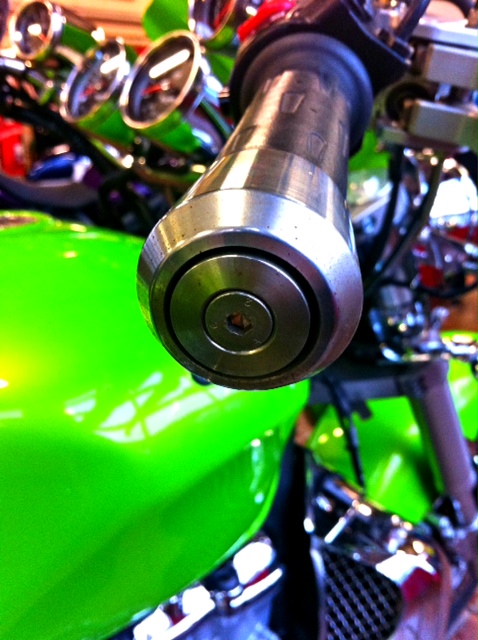

I made two new inserts in the end and the Bar ends are on the bike now. They work better than my homemade jobs probably because of the heavier weight I'd reccomend them

I linked this thread over to my BMW forum and there have been a few inputs that might be of interest here...

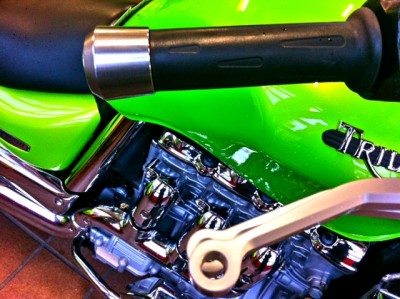

I spotted these on a Rocket 3 the other day. Slightly different shape so maybe different weight? Whatever, Triumph seem to like these

I may still look out for Rocket 3 bar ends though as their heavier construction maybe just the thing for low frequency vibes.
