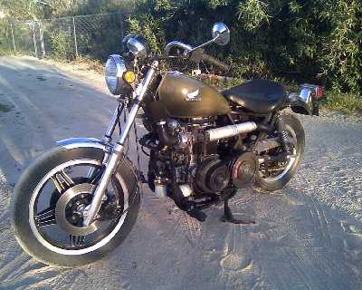

I got the old Ruggerini/Honda up and running back in Sept. of 2007. 30,000 miles and five (5) sets of clutch shoes @ $100 a set later, clutch is sitting on a shelf while I get my Hatz/Dnepr on the road.
Did it work? It got me on the road, better fuel mileage than a CVT, could have used a 2 or 3 speed box to be more user friendly, stop and go traffic heated the clutch up, starting on hills was a pain.

That's a nice looking bike, even if the clutch didn't work out well. Yea, a little 2 or 3 speed would have been nice, kind of like my old Chevy II with the 6 cyl and 2 speed auto trans. It would start off at pretty high RPM, then shift and be back down to about 1,000 rpm until it crawled up to speed but it worked well. Maybe a 2 speed and the Centrifugal would be work well on a Diesel if there weren't a lot of hills to climb due to the Diesel's narrow power band, unlike the old 194 Chevy 6.
Is that an old '80s CB350?
