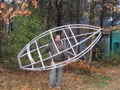

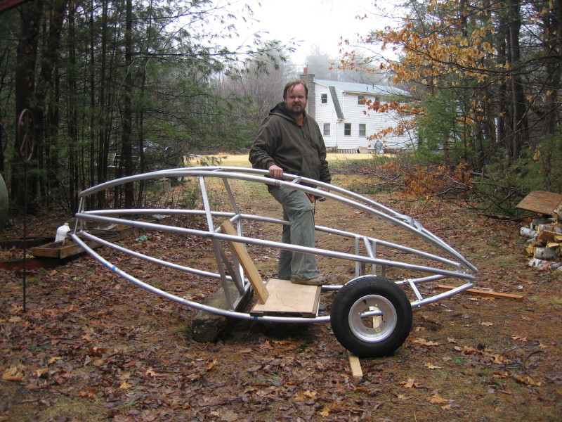

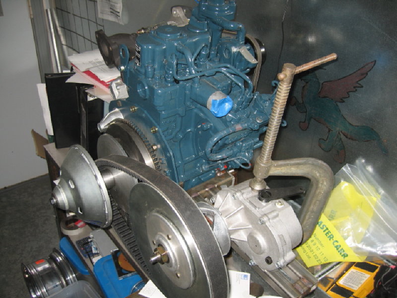

Just thought I would let you guys know...I have added a buch of info/pics to my "construction progress blog" on http://www.roopod.com and thought that it might be worth a gander...here are some pics of the frame "off" the jig for the first time! and one of my Kubota z482 + comet 94c + comet FNR gearbox...
Roo

Roo,
How did you attach the 94 drive pulley to the Kubota's flywheel? That setup is super cool and a great way to get power out of these engines. One thing most people do is gear their bikes to high (for high top end) and this really stresses out the Comet. Last, what kind of tranny are you feeding power into???
thanks,
Cris

Hi there, Balboa...
I got a stock Kubota stub shaft adaptor from a Kubota engine dealer....
I had to cut it off a bit to be right for the Comet...
I have set my Final drive ratio to 4:1 with a 21.2" tire
with the Kubota's 3600 RPM and the CVT ratio, it should go 65mph...or so...I hope it's not too high gearing...
I am using Comet's Reverse Gearbox in place of a jackshaft...
there are tons of pictures of everything at my website http://www.roopod.com if you want to see pictures...
I am just about to weld my swingarm together and set this baby on the ground maybe today or tomorow....
Thanks, Roo

Nice work, Roo! I hope to see that machine running around the streets of Amherst (and beyond) soon! I didn't know a stub shaft was available "off the shelf"- saves a bit of work. My Kubota engine has a splined shaft that ran a hydraulic pump, not very useful for my use but I think the flywheel is drilled.

Roo,
Let us know how the gear box works out....I'll look for pic's on your website...maybe I missed a few. I didn't know Comet had a gear box.

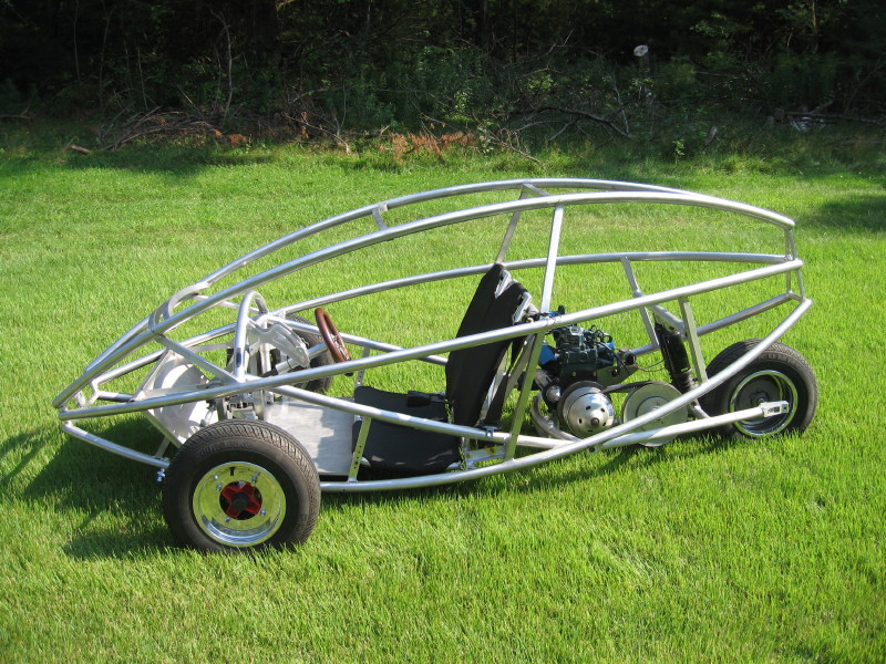

hey guys, thought I would post some new pics...see much more at my blog www.roopod.com not long now till we fire this baby up!
