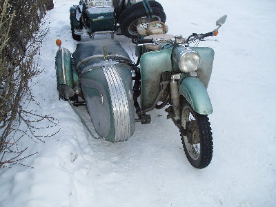

Voshkod looks nice - everyone says electrics are terrible! What about your MZ ES250 picture, with Stoye sidecar - is that yours too?
