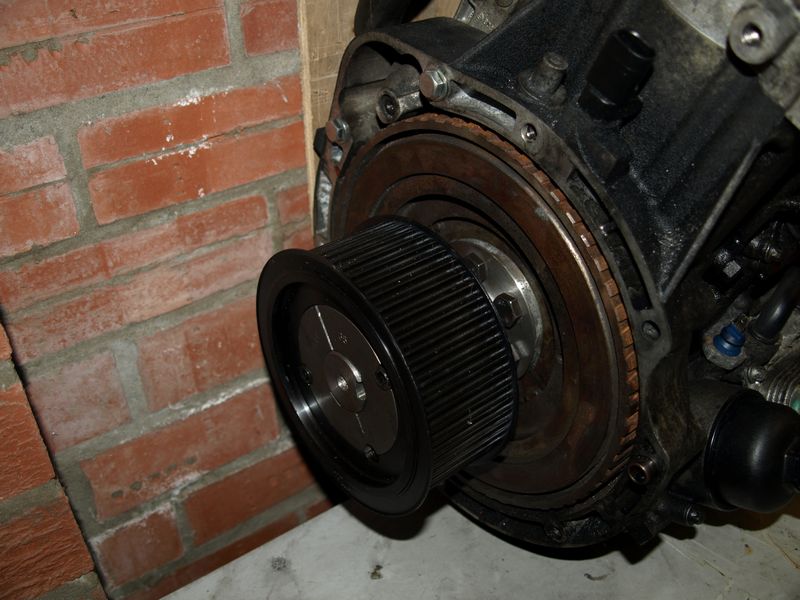

Today I managed to get my grubby mitts on a suitable front pulley. Took a while in coming but finally sitting here in all its glory. What I hadn't bargained for was the fact it weighs about 5kg! I guess it won't wear out any time soon though maybe should have researched an alloy one or something. Still, got it for a measly £20 which I thought was excellent compared to online prices. Tempted to drill it or something but thats maybe not the best idea so I'll use it as is for now.
I've also to make up a bearing carrier and plate to hold the engine output shaft going into the front pulley. Have got the bearing so far, just wondering what thickness alloy plate I could get away with to hold it. Am guessing 10mm for now.

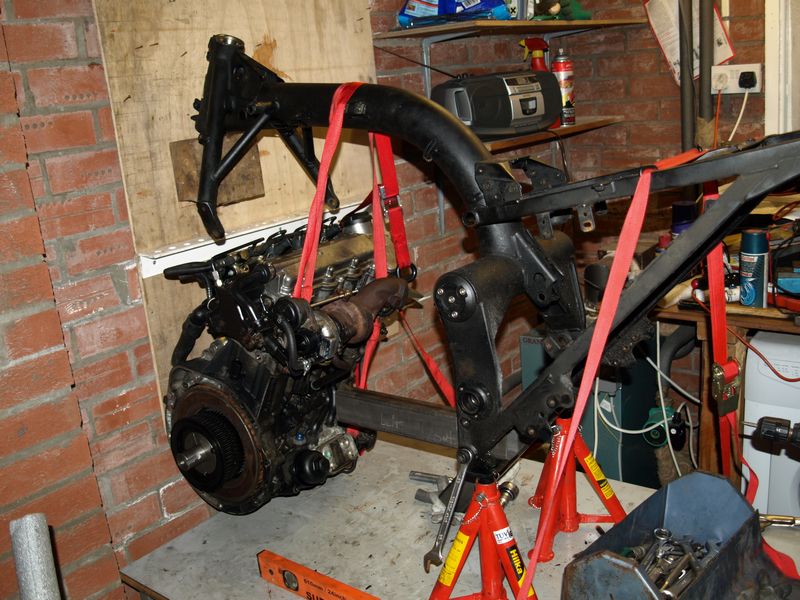

Some progress - just need to keep momentum now. Engine up on the bench along with the other frame and some bits. Gonna be fun trying to align it while hanging mid air! Make a jig? Invite some mates round? Hang it off roof? :) Note the precision engineered jig for holding frame at the back and also block of wood on the wall at the front (works suprisingly well). Now to fab up the gearbox mountings and then onto the engine.
Had some fun getting the custom made engine output shaft to fit properly, but it was a lot easier than I had been worring it would be. Seems straight too which is a bonus. This is getting interesting now as opposed to all the engine hassle...

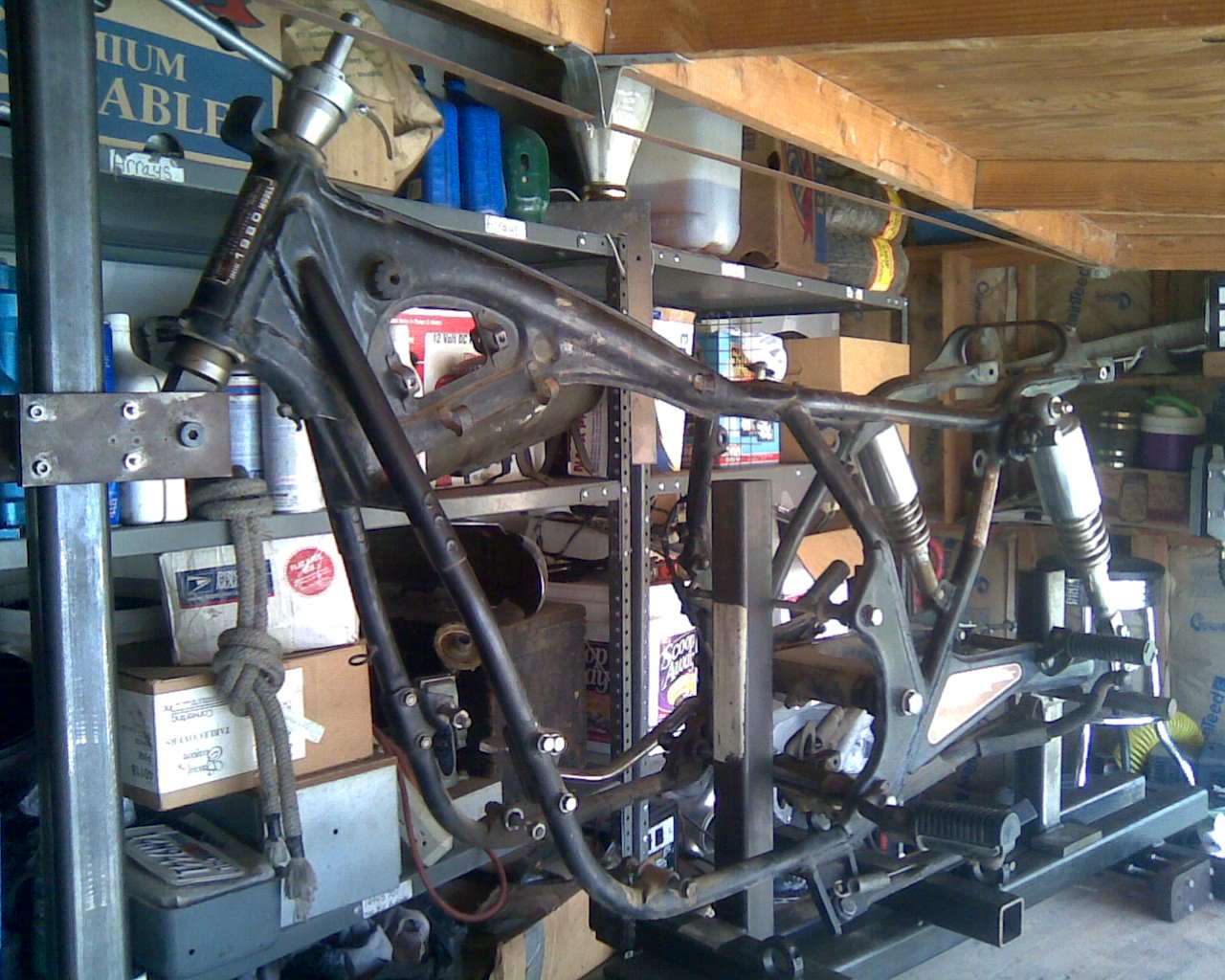

Keep your eye open for a frame jig, I got lucky a couple of months ago, and picked this brand new custom built jig for $200. Good luck, and I wish you well on your project.

Another couple of pics. Engine and gearbox trial fitted to the frame and (very) thankfully the pulleys still line up ok. It seems like the full day spent tweaking the alignment of things was well spent since the original panels still fit (had to loose the original fuel tap though). Onward and upward :roll:
