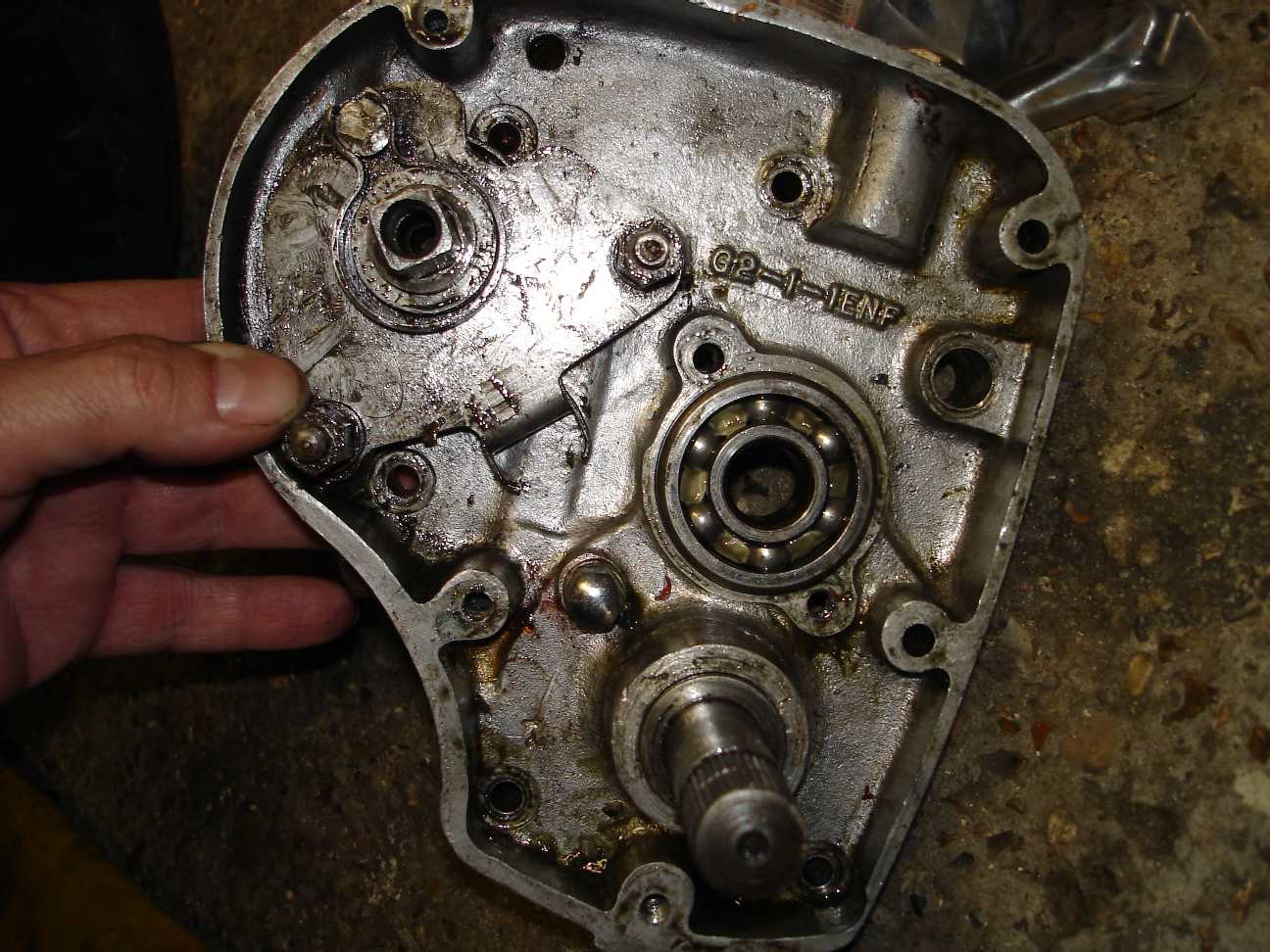

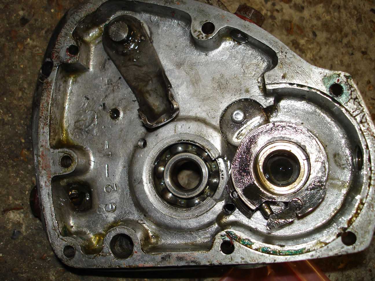

As some of you know the Ruggerfield recently suffered when the gearbox seal sprang a leak and dumped all the grease/oil out. As a result the gearbox went crunch on me and I can no longer select 4th.
The bike is going into the shop to have the box fixed and refurbished but in an effort to keep costs down I've dismantled it part way so the mechanic can get the insides of the box out ok. That meant exposing the sprocket, something which I wasn't quite sure was possible without removing the engine.
As you can see from the shots it was and I managed to remove the bearing carrier assy that sat behind the clutch. It's a nice piece of work, machined from a solid block of ally and carrying two bearings not one. It even has a little breather pipe on top.

Well after much hard work old Sluggy's gearbox was completed it's rebuild today.
I replaced the bearings with new sealed European ones and layshaft bushes with Hitchcocks Phosphor Bronze ones.
The casing bush is dead easy to replace but the other end runs inside the kickstarter shaft and this is a real pig to remove, I had to cut it twice with a broken hacksaw blade and chisel out the reminants. The new bush was pressed in with the vice but turned out to be almost 1/2mm undesized for the shaft. I had to bore it out on the lathe to fit the shaft.
Still, all done now and my own special mix of engine oil and grease mixed to the consistency of elephant poo.

Well, my mechanic gave me a call today and said come look at the gearbox damage. Ouch
See what no oil does. New sleeve and shaft we think
(Sorry about the dodgy camera phone piccy).

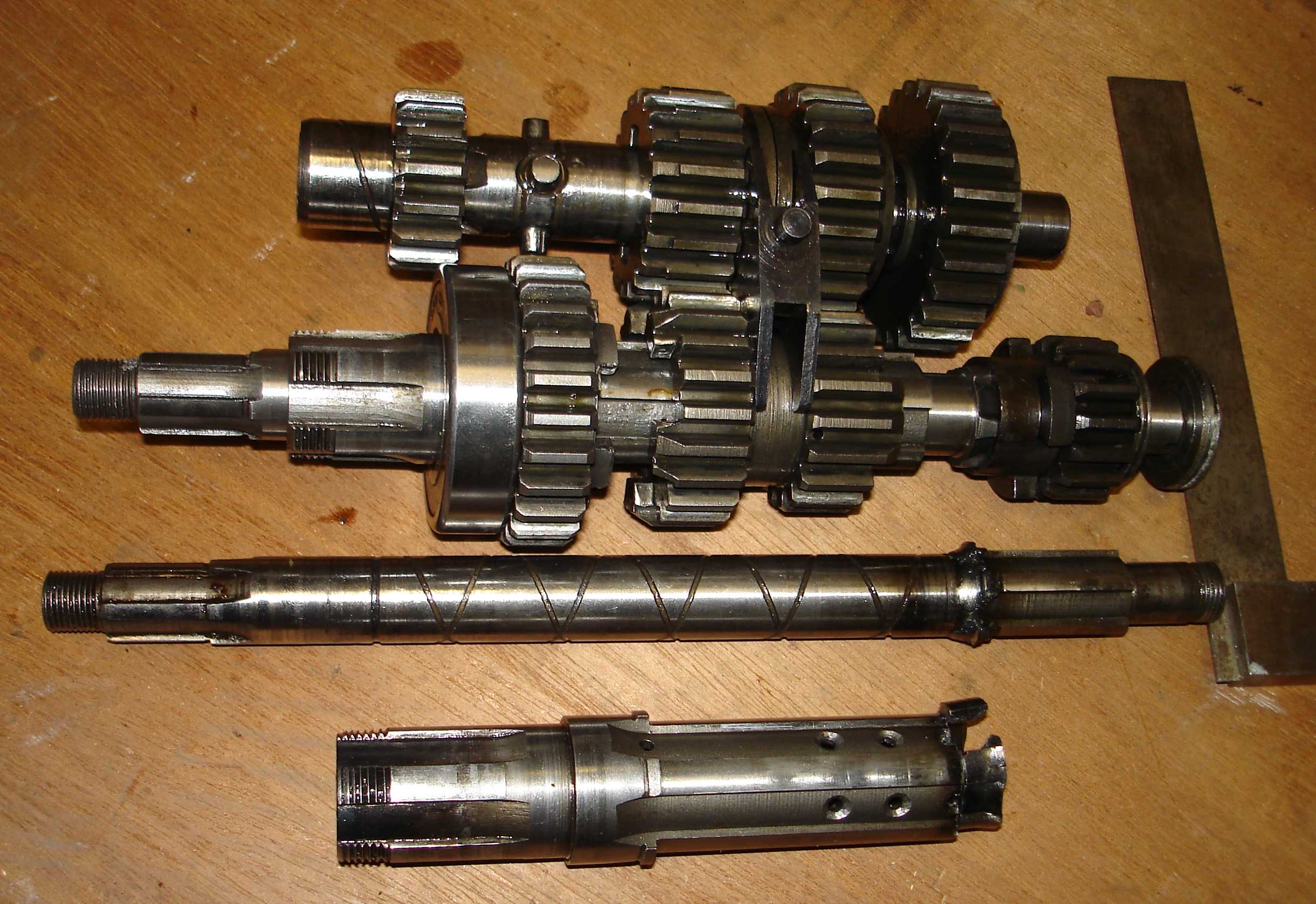

Here's the differences:
Fig 1: shows both the ‘Old English’ version damaged sleeve against the new Indian one which won’t fit. Notice the keyway length is way different. My old one has grooves about 42mm (1” 6/12) long whereas the new Indian one is only 30mm (1” 2/10)
Fig 3: shows my damaged main shaft and sleeve together. This main shaft is 288 mm in length (11” 3/10) unlike the Indian one which is smaller at 280mm. My damaged sleeve is about 6" long.
Fig 5 shows the damaged English parts against the Indian parts assembled into the cluster. That’s as the shop gave them back to me.
The Diameter of the main shaft at the kick start side is 15.9mm on my English version. It is 17mm on the new Indian version.
My box has some numbrs on it. 4741 and HDL 456 if this helps ID it.

Ok, I've opened her up. There appears to be a seal (new) fitted sprocket side for the main bearing there. I loosely put the bearing in as you can see in the shot. There are a few felt washers in the refurb kit so that should help. Ian, I do have 15 teath on that end cog (phew) so no worries there. There does appear to be a problem with the kick start mechanism clouting the middle case. It has taken out a bit of the case on the outer edge of the smaller bearing that end. I don't think that will be too much of a problem if I put some seal there just in case.
Dave, I see what you mean about there not being much in there.
- Posts: 549
Re: Ruggerfields gearbox
Oh my god it's filthy! You’re supposed to prep the patient before surgery.
I use a kitchen sink size bowl full of white spirit, leave the whole lot in there for a while, that gets the crud of .
Is that bronze bush new? It looks like it has a fair bit of wear at the end, or is that just the photo?
This is what happens when the kick start is bolted on the shaft too far forward, by the time the right leg has gone down to the bottom of it's stroke, the shaft inside bangs in to the case and eventually exposes the small bearing. Basically the shaft's gone around to far. It should be ok unless there is no hair line crack around the bearing housing, tap out the bearing and take a gander.
As far as loosing oil is concerned, this shouldn’t be a problem as you still have the cover to put on the other side, just use sealant in side the bearing housing, there’s no point using it in side the box as it will just com off and lodge it's self in to something important (open bearing is usual), unless it has a crack it should be ok.
