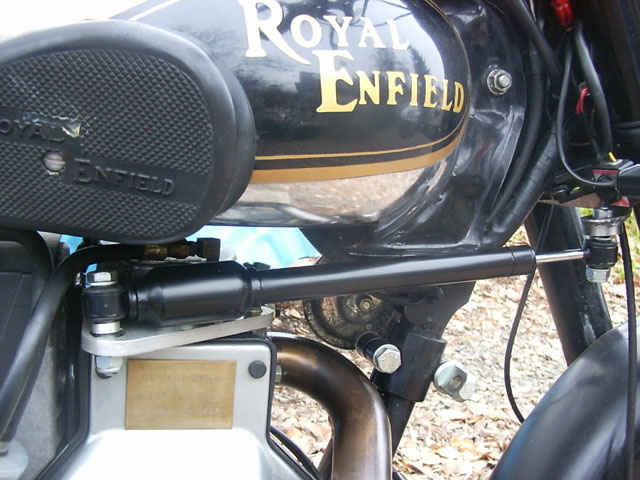

On the German Enfield wiki there is a mention of using an Audi absorber in the frame mounted to the cylinder head:
http://www.enfield-wiki.de/index.php/Flatterd%E4mpfer
Re: Enfield 1996 frame reinforcements
Cool idea,
A bit of overkill on the shocker size!
An old Enfield rear with the spring removed might be more descreet.

I thought it was only the rocking motion of twin engines that caused this problem?
Maybe this is a bit of hysteria.
The bike in the pic has a single cylinder engine, a bit like yours Dave, how many miles have you done and have you spotted any frame problems?
For twins, I'm wondering if welding a thick steel plate running from the underneath of the backbone, back of the head stock, and down the down tube would do the job?
