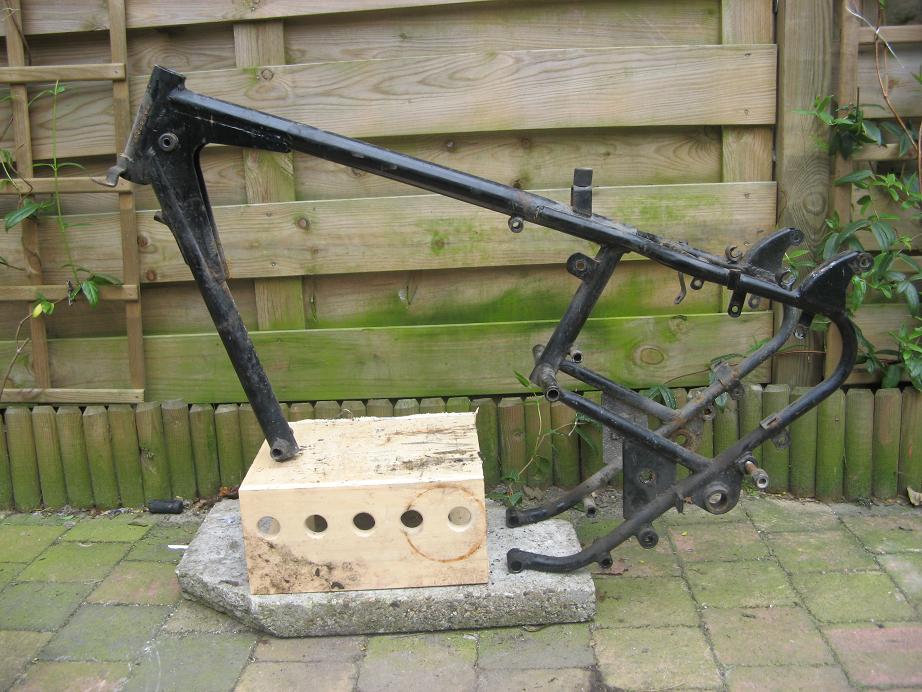

I'm sure glad that I don't have to put it back in, because it was a pain in the you know where to remove it. Solo. Without a front wheel. No straps. What surprises me is the number of nuts in annoying spots.
Thanks a lot for the pointers.

It was a beautiful sunny day today A perfect opportunity to take a walk with the family... wait!
Scratch that, there's a frame I need to strip
I'm genuinely surprised by the amount of metric nuts I encountered. A lot of 13, 15, 18 and 24. Unfortunately I killed/nicked/dented/tore 2 bearing races. Seems they were as sturdy as tin cans
