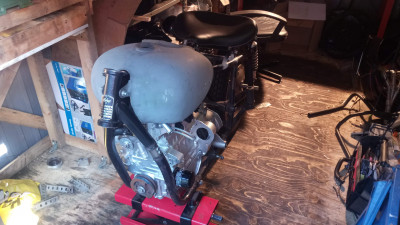

Hello all, quick update. The build isn't dead, as some might've tougth. Due to various reasons I've been neglecting/not been able to keep this thread as well updated as I should have, my apologies.
Here's a sneak peak of where to build is at at the moment.
Currently I am waiting on part for the frontfork and transmission, once those are done I can continue the build.

Looks like you are on the path to one of the nicer, and very squared-away looking "Frankendiesel" creations here. Bravo.

Thank you Jeronimo, one can only try.
I have not been sitting still. The past few weeks I have been sorting out the electronics and making more progress on the Forks and Gearbox.
Hopefully soon starting on the cooling system.
