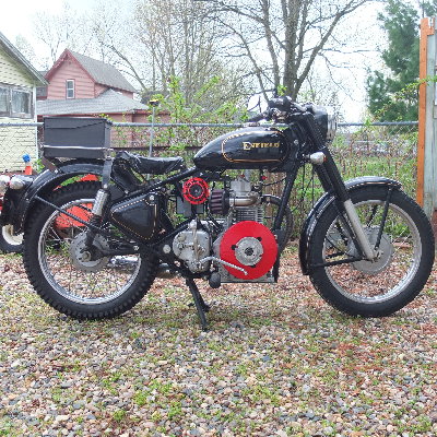

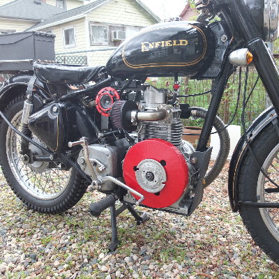

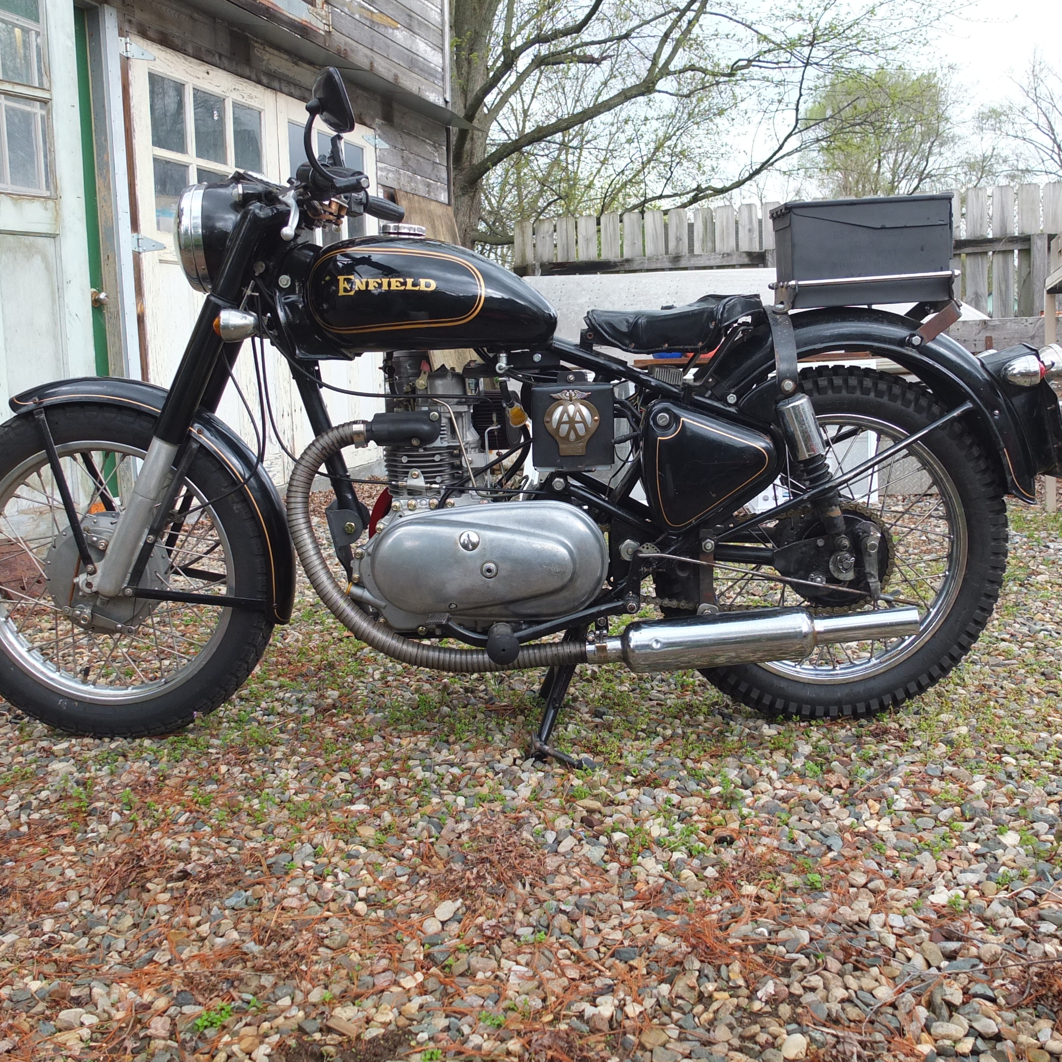

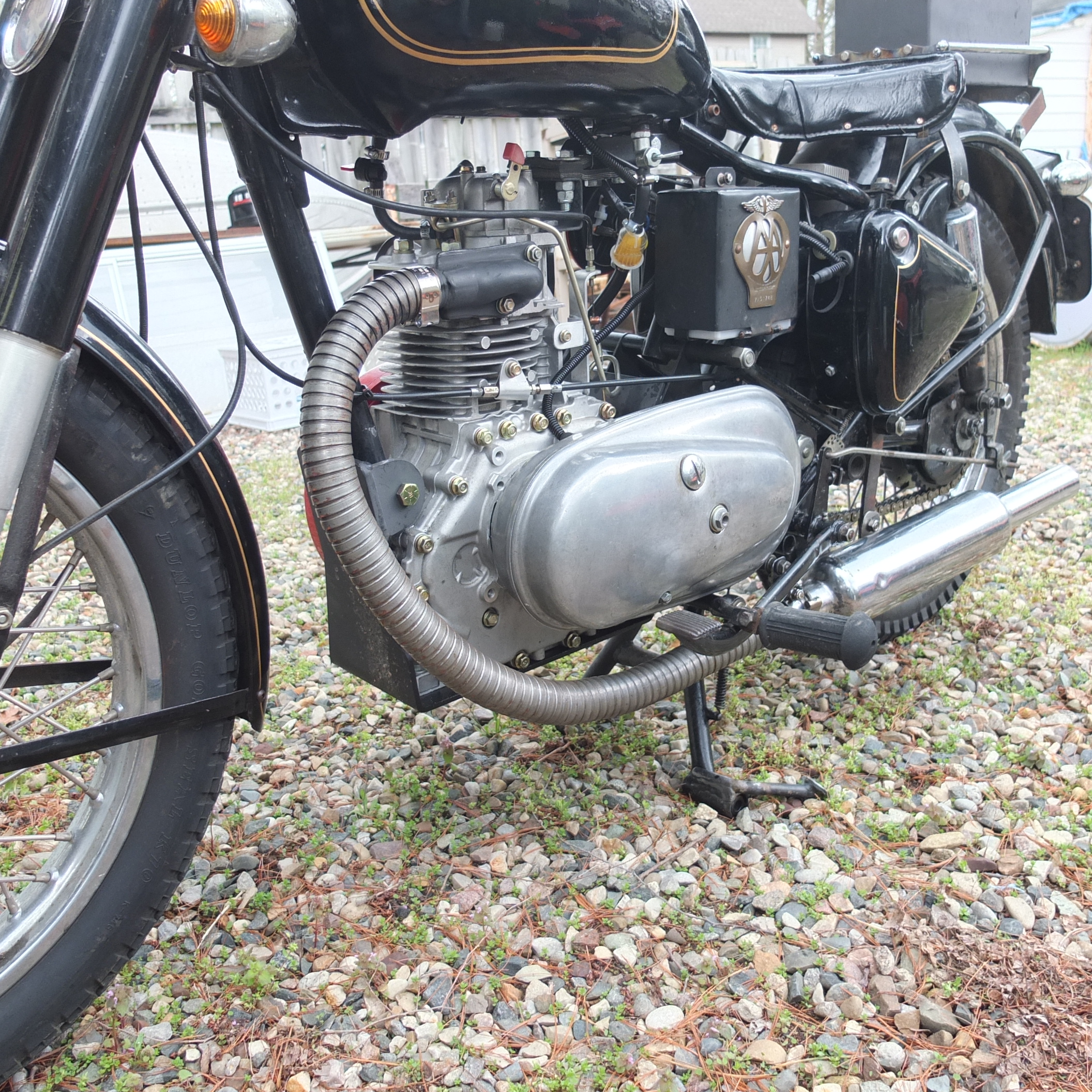

And in case you'r wondering WTF.
Was a 99 iron barrel Bullet with a fairly hot engine.
Head, cams, carb, exhaust, Etc.
Would do the Ton.
Long story short I am nearly deaf so when the spur gear on the oil pump
shaft went out it wasn't heard till the engine was full of microscopic metal
shavings. No back flush was possible and complete rebuild was not my choice.
Thus the conversion to a 10HP Chinese diesel. 750 trouble free miles so far.
Will only do about 55mph but gets 120mpg and is more fun than any motorcycle
I've owned in 60+ yrs of riding.

Hey Ron;
great to hear from you. Free air works great. Doesn't seem to get hot at all.
