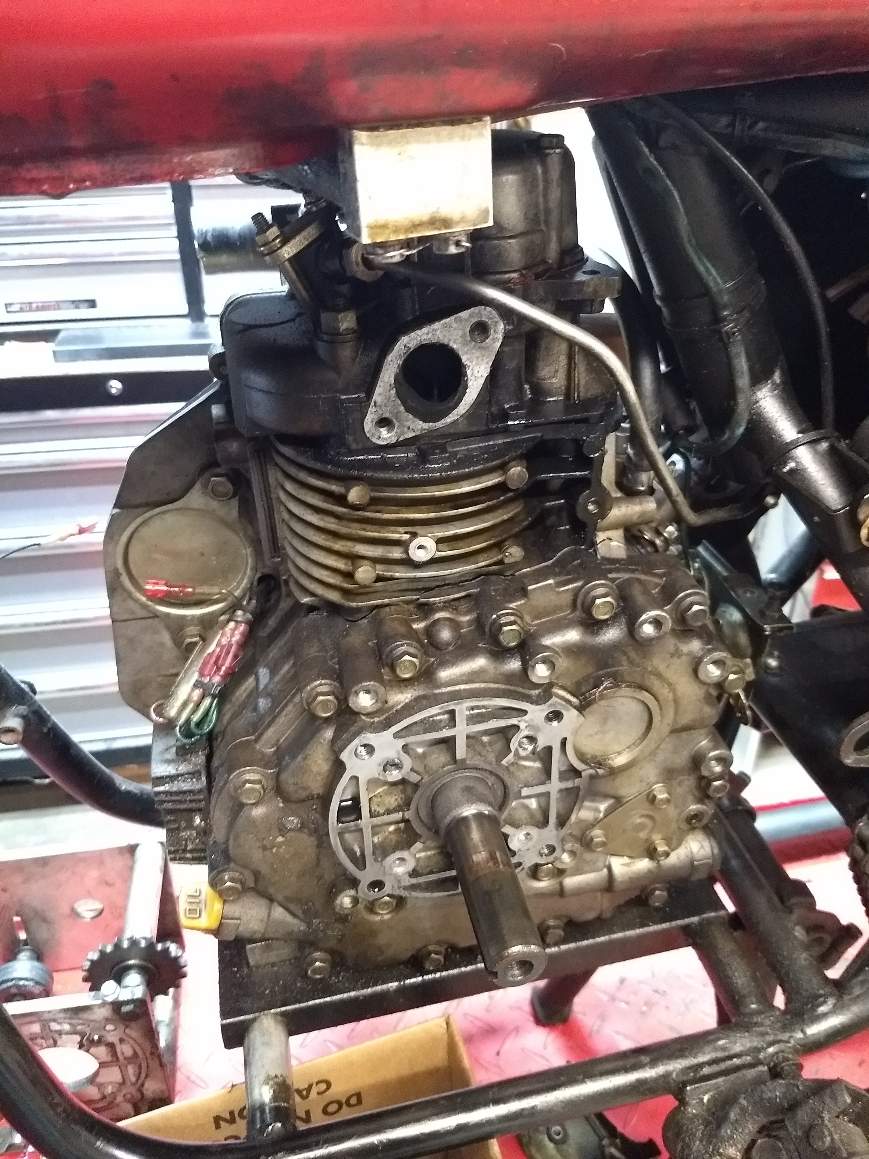

I finally worked through my backlog of other projects, and the KZ400 diesel is now back on the bench for a rebuild. The first step was to disassemble the drivetrain, clean the frame, and improve some of the mounting hardware and wiring.

I finished stripping the engine, and was able to examine the inner assembly for the first time. Overall, the components are in excellent condition, the only major issues being excessive carbon buildup in the combustion chamber, and wear on the output-side plain bearing.
I also inspected the camshaft, and found no evidence that the stronger valve springs had caused any damage to the lobes.

Progress! I've refurbished the original engine internals, deburred the new crankcase, and installed everything with fresh bearings and seals.

Engine reassembled and tuned!

I brewed up some caffeine and locked myself in the garage for a marathon reassembly session last night :D

Finished reassembly and received a fresh NYS inspection. Finally ready to ride again!
