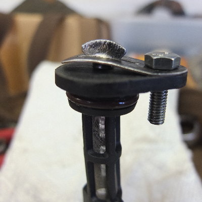

Dave;
not familiar with the Greaves you have. Must be it's hard to access filter also. Was expecting replies from Yanmar owners as I know they are impossible to remove. Here are some pictures of my solution.

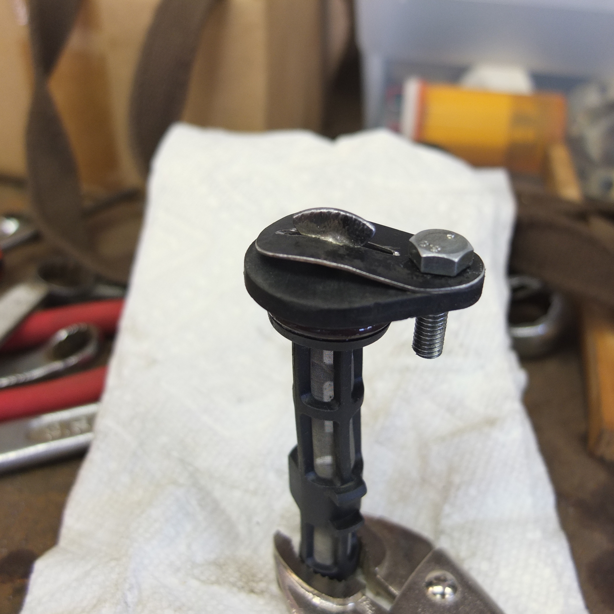

File the end of the filter flat then drill small hole to insert screw with silver soldered thumb screw.
Can't remember size but it self threaded as plastic of filter is semi hard.
Made safety clip from package strapping. Star washer on retaining bolt and ready to test.
To clean park bike on slight incline. Remove retaining bolt, safety clip and center screw.
Pull filter out 1/3 way. Insert long thin spray tube of electrical contact spray cleaner to front of filter
through the center hole. Spray on full and withdraw at same time. Drink a cuppa.
Preoil the O-ring and put her back together.
