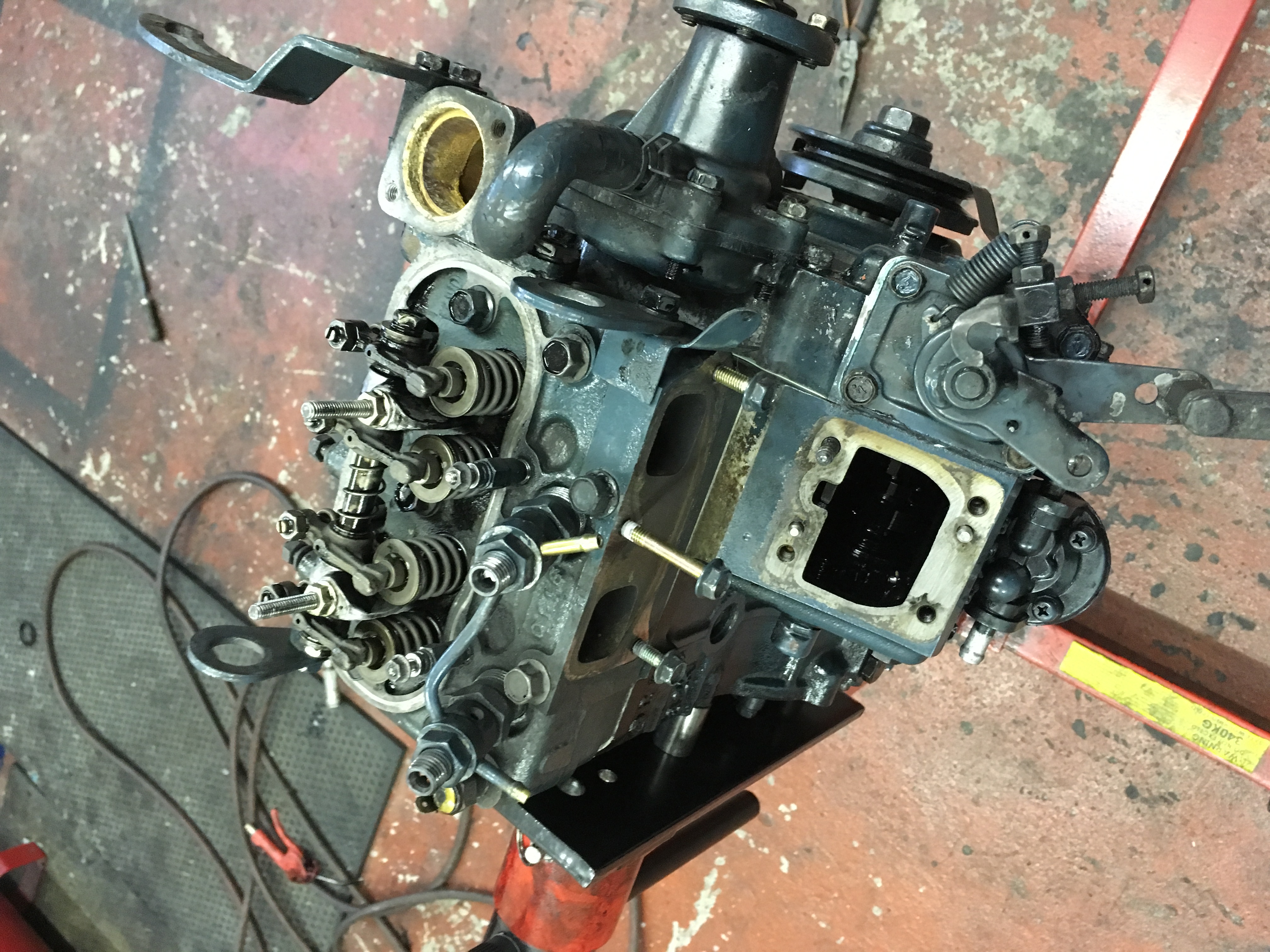

Sub-frame with engine pulled out ready for a clean up, clean out and general heath check! just trying to find a engine crane I can borrow, don't much fancy wrecking my back in the interest of haste.
Progress from here will be a little slow for a while, I need to get Christmas out of the way before I can save any money again unfortunately and then i'll be on the look out for a donor bike.

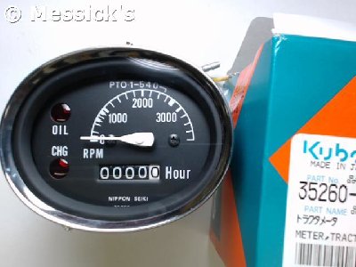

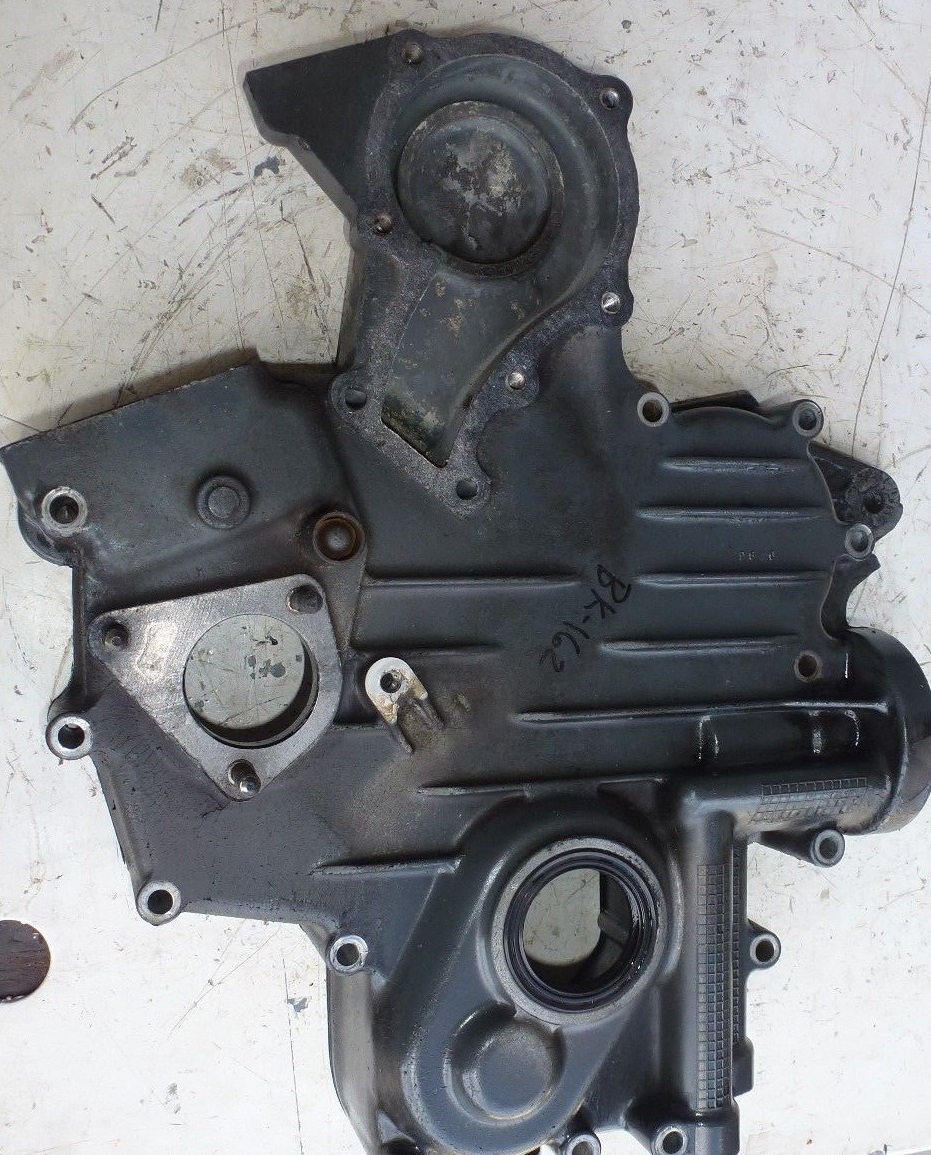

The slickest and quickest tach would indeed be as Sam has suggested. However, if your preference is for a mechanical tach, there are Kubota OEM options available that couple to the front of the IP cam and bolt to the timing cover. You'd need to drill and tap your timing cover or swap it out for a D722 one that is, as in the pic below. Unless you can secure one from Fleabay, the price from Kubota for tach, drive and cable will be snuggling up to $200. The bonus of the little oval Kubota tach is that is comes with an hour meter and idiot lights for oil pressure and charging. That said, Sam's option is still the quickest and least expensive.
http://www.messicks.com/part/35260-34602/meter-tractor
https://www.ebay.com/itm/Kubota-D640-Ta ... Swcj1Z9IY3

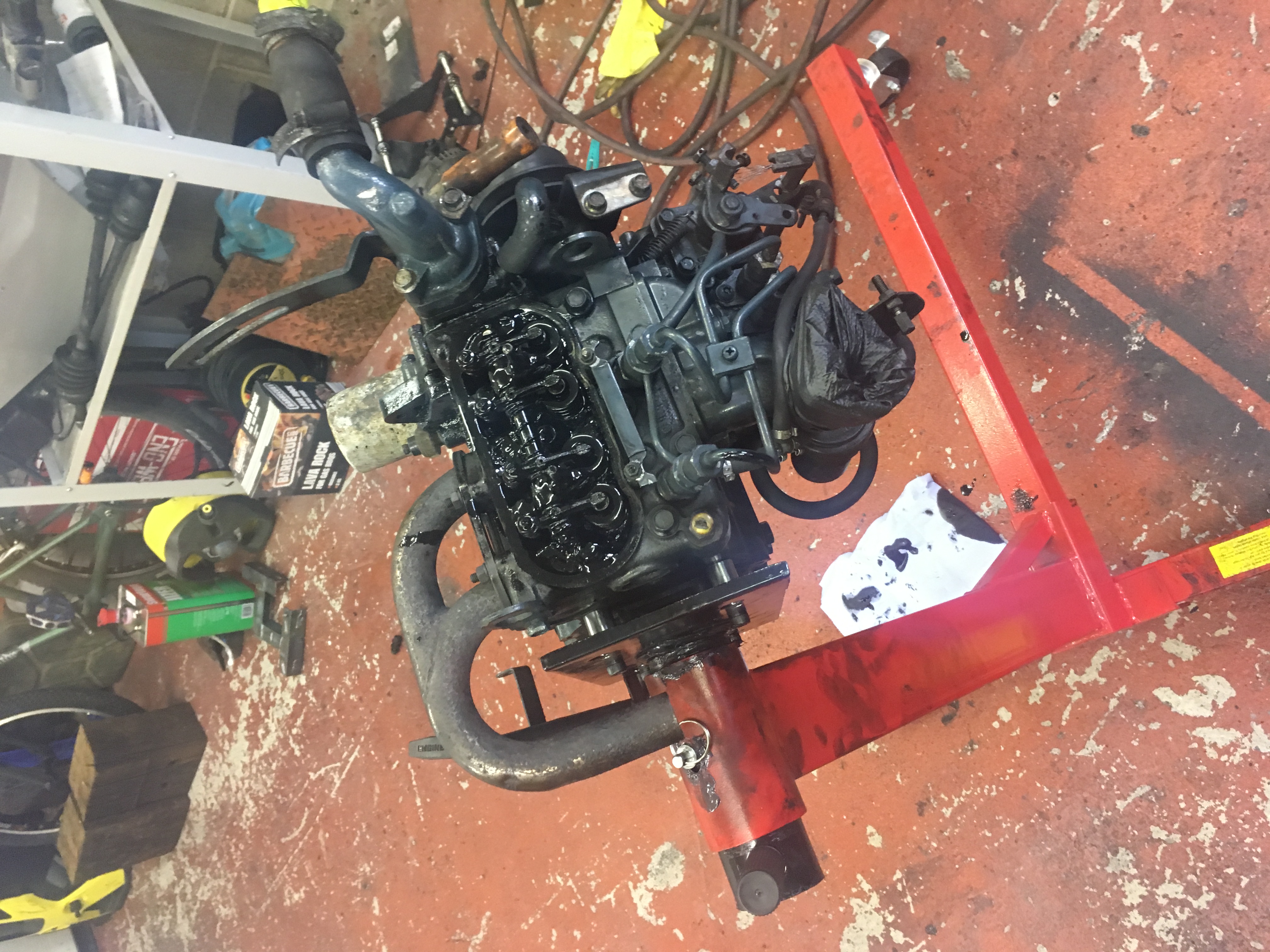

The upshot of all this is I managed to borrow an engine lift/crane so the engine is now out, just need to mount it to my engine stand I managed to source cheap locally, saves me building a temporary wooden frame anyways!

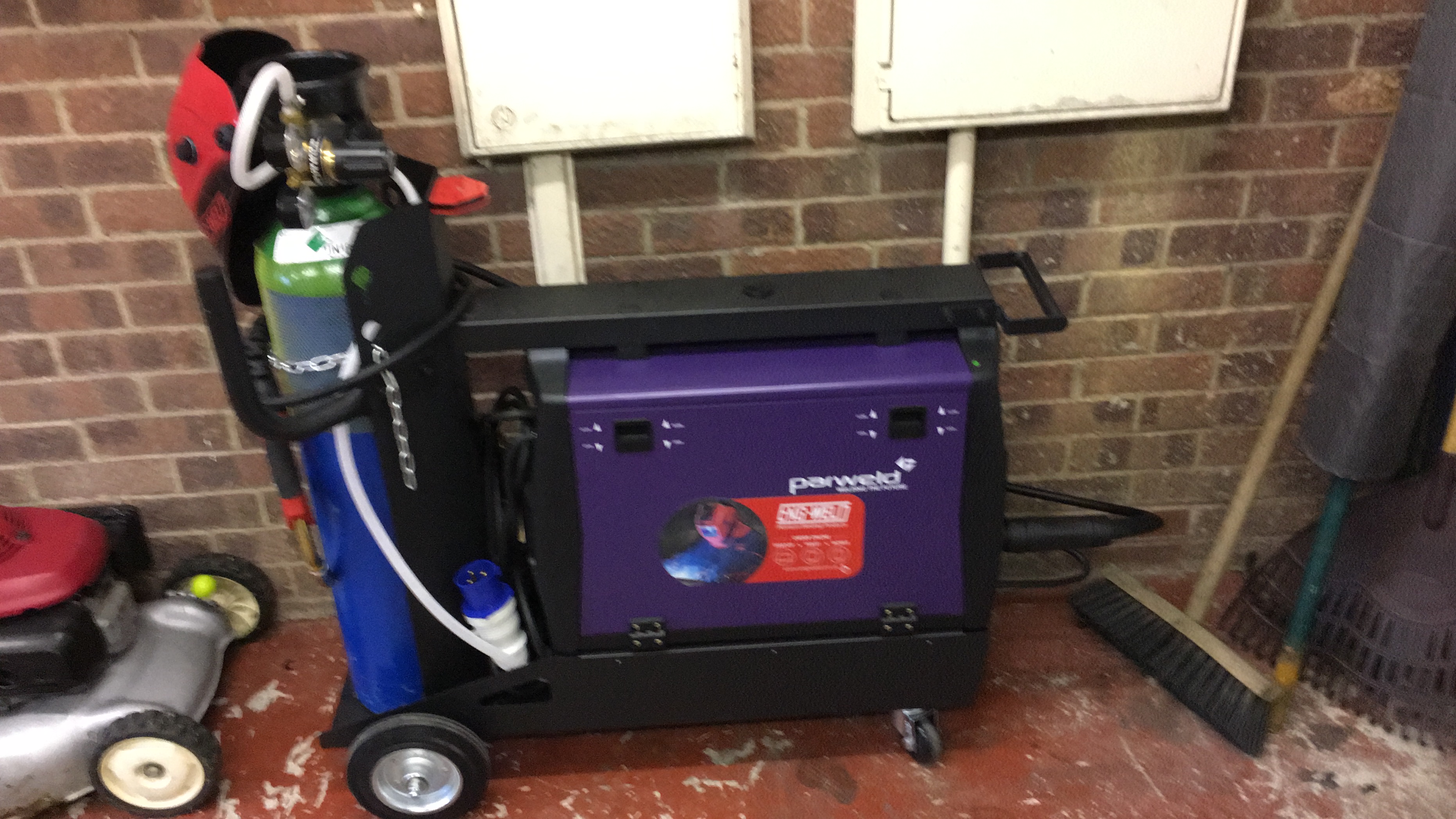

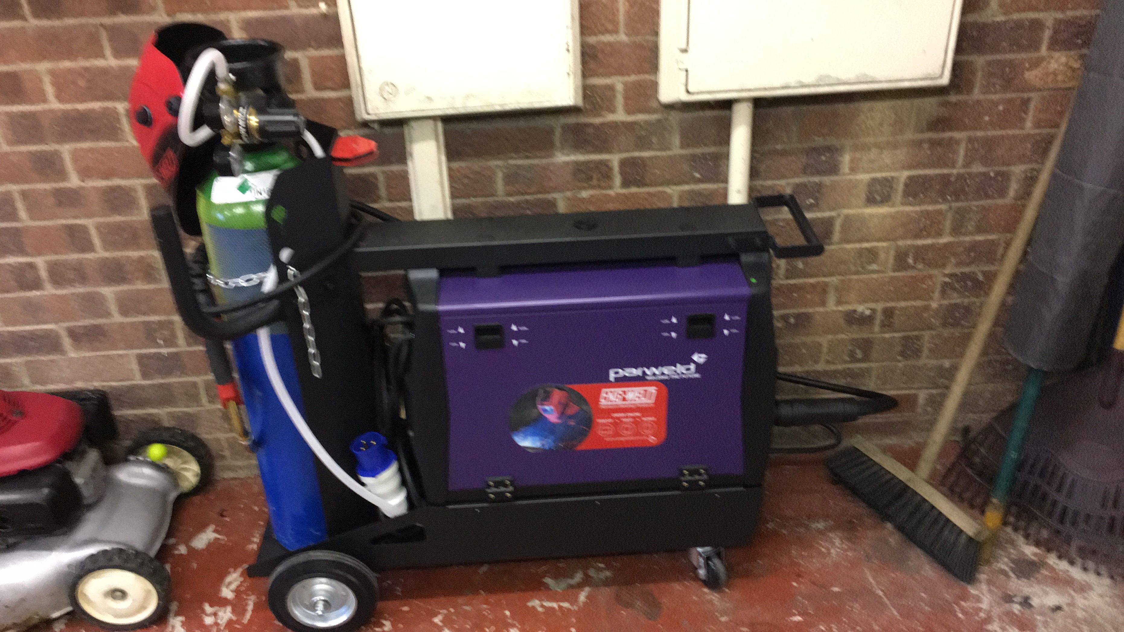

Buying the welder this week!
Proper piece of sex! Actually looking forward to welding with some decent tackle, all my previous welder have been total garbage (£100 jobbys)
Parweld XTM 182i Synergic Mig with DC Tig and MMA should I require :o
I have welded with decent tackle of my friends and the difference is day and night.
If I'm going to be riding this Frankenstein and putting my life in its hands I want decent joints and although the biggest factor in that will be my skills with the torch it helps if your not fighting a loosing battle so worth the investment I feel, plus its garage tackle, there's not such a thing as too much garage tackle.

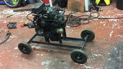

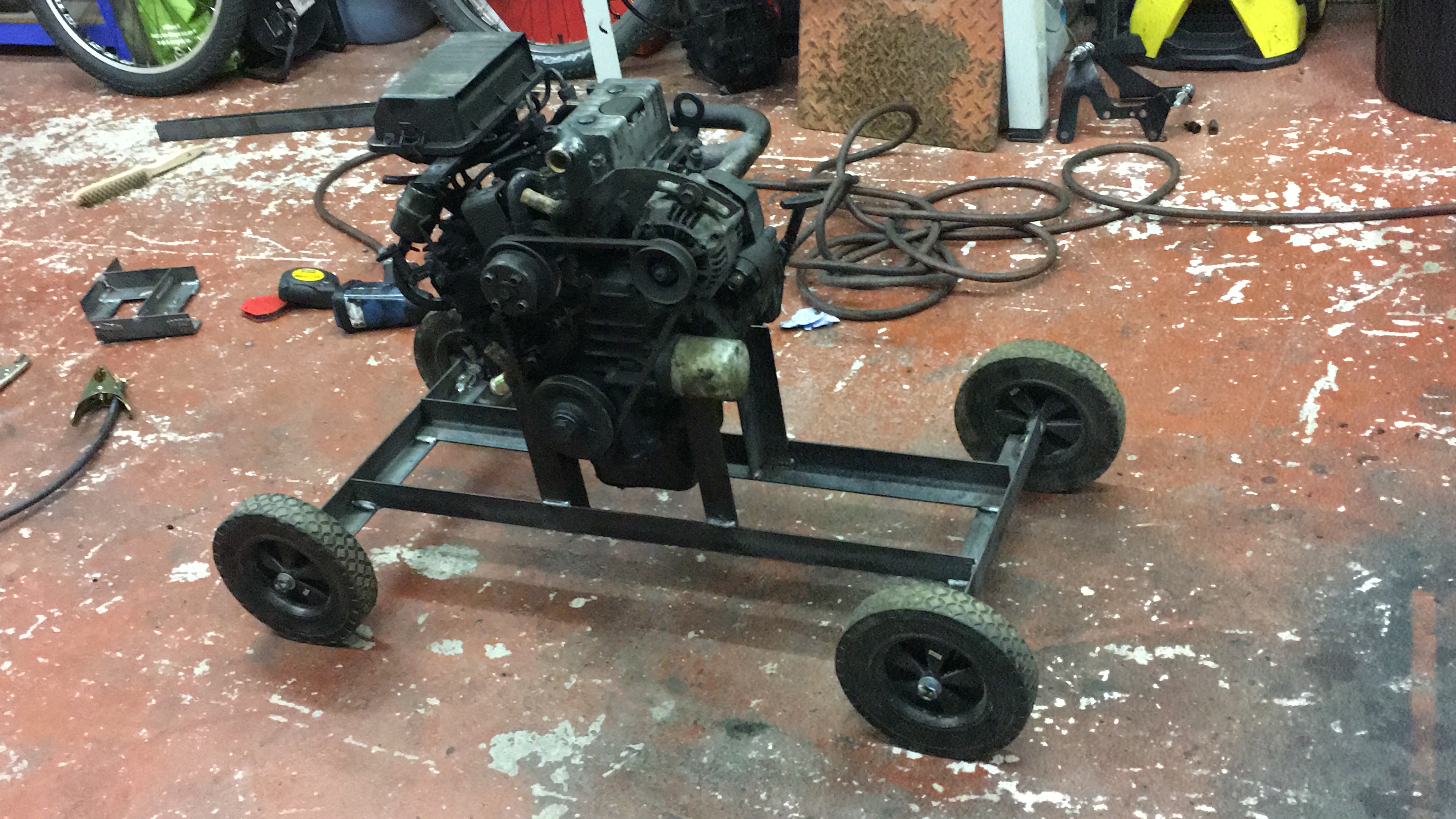

In the meantime I've had a play with the welder and lashed up a temporary engine stand I can move around my garage to clean it up and service it and also fired it up for the first time since I removed it from the car. Very "Heath Robinson" or "Ghetto" depending on your preference but it worked :mrgreen:
I had quite a disturbing discovery however - I'm getting the same false dipstick readings reported by Mouse albeit mines the opposite way - tells you its empty when its full.... ( although I suspect it just reads one level continuously even if it was empty) think this needs some investigation as the first time I started it (having topped it up with oil) it exploded oil all over the garage by blowing the fill cap off :oops:
Turned out with my 300ml top up it had a total of approx. 5L in the sump!!!
I drained it and refilled with fresh oil of the volume specified in the Aixam owners manual to play safe at this point.
It only has a capacity of 1.8L or something (cant remember exact figure without checking, could be 2.8L) either way this 300ml was the straw that broke the donkeys back, when I bought it there was obviously too much oil in it however it wasn't showing any sinister signs :roll:
Think I will probably be going down the sight glass/tube route though to be honest as I progress.
Never mind, it runs very smoothly so its apparent no (noticeable) damage had been done (Praise the lord, Hallelujah!!) :lol:

Been a while since I gave an update but with very good reason.
So... That false dipstick reading...

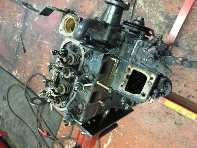

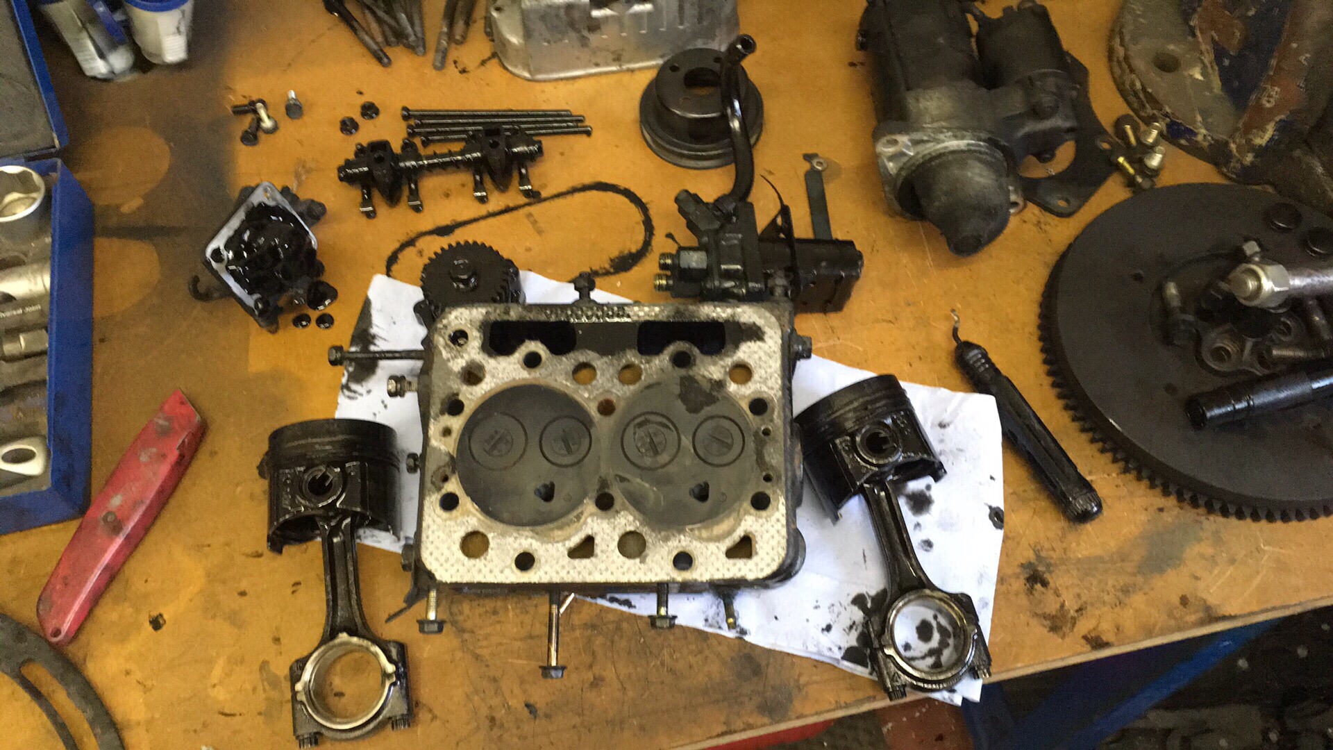

Basically the following day from my last update I fired it up to warm it up prior to draining the oil in preparation of a service, about 5 minutes of it ticking over it started knocking like a really load high pitch "clack" honestly thought it had thrown a valve or something it was that bad :shock: I assumed the worst, however once disassembled it turns out it was oil starvation, only just got to the point you could tell in that moment when one of the galleries became fully blocked
So the basic service I was going to give it turned into a full engine rebuild - the old head gasket also looked questionable when stripping :roll:
Its internals we're covered in tar like gloop.
Check your sumps guys...
Sludge round the Valves
Stripping it down...
Almost Rebuilt, Look at the cleanliness!!! 8)
Words of advice for all with false dipstick readings or sludge build up....
Check sump this will be an instant tell tail, if you have sludge I suggest cleaning it in the following area's as these we're particularly contaminated and I don't think any amount of engine flush would clean it, I was literally spooning it out :oops:
Clean the following if you want to avoid a full rebuild:
1- behind the throttle control plate
2- behind the fuel pump
3- Sump strainer
4- on the head around the valves/rockers
5- This is the cheeky unexpected one! - remove the splash/windage plate from the rocker cover, behind here was vile!! if you don't clean this the crank case can't vent as it was completely blocked off raising crank case pressure this will probably cause it to burn oil ect...
This maybe wasn't a bad thing in all honestly - although I could have done without spending money on a full gasket and seal set + oil and filter (approx. £150 in total), once the engine was all stripped, cleaned and inspected turns out there is literally no internal damage, no scoring of the bores, rockers, valves and head are all good, all the bearings are in great condition and all-in-all its a fine example!
I assume it has just suffered some prior neglect with oil and filter changes, it does however gives testament to Kubota build quality!! :lol:
I am happy to report now its rebuilt it starts so easy, sounds sweet as a nut, has a very smooth and slow idle, revs effortlessly and has no smoke!!!
ALSO - The dipstick now reads correctly as the dipstick pipe isn't FULL OF sh*t!!!! :wink:
I'm guaranteed its got plenty of life left in it yet! :mrgreen:
hopefully more updates in the coming weeks/months as time and finances allow - still need a donor bike :cry:

So... Kubota Z482 in full working order (with transport frame) as per this thread so no hiding anything here and also the brand new CVTech Transmission.
£1000 OVNO takes the package.
Thought id offer it up on here before listing on eBay as I know this is a desirable combo and seldom is there a "band new" CVTech CVT up for grabs.
This is a pretty special CVT at that as CVTech actually set this up for me in the factory based on my calculated bike weight, engine application and desired top speed based on the final drive ratio.
In other words, you can bolt this to a Z482 in a medium sized bike frame and as long as your final drive target is about 70mph from CVT output shaft then its already tuned for this application - not like the ones pulled from the cars/sleds ect.....
