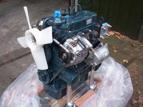

I finally bought in! You can only read so much and then you have to BUILD something.
After reading for hours about all of the options to consider when building a Diesel motorcycle, I spent my mad money on the following parts.

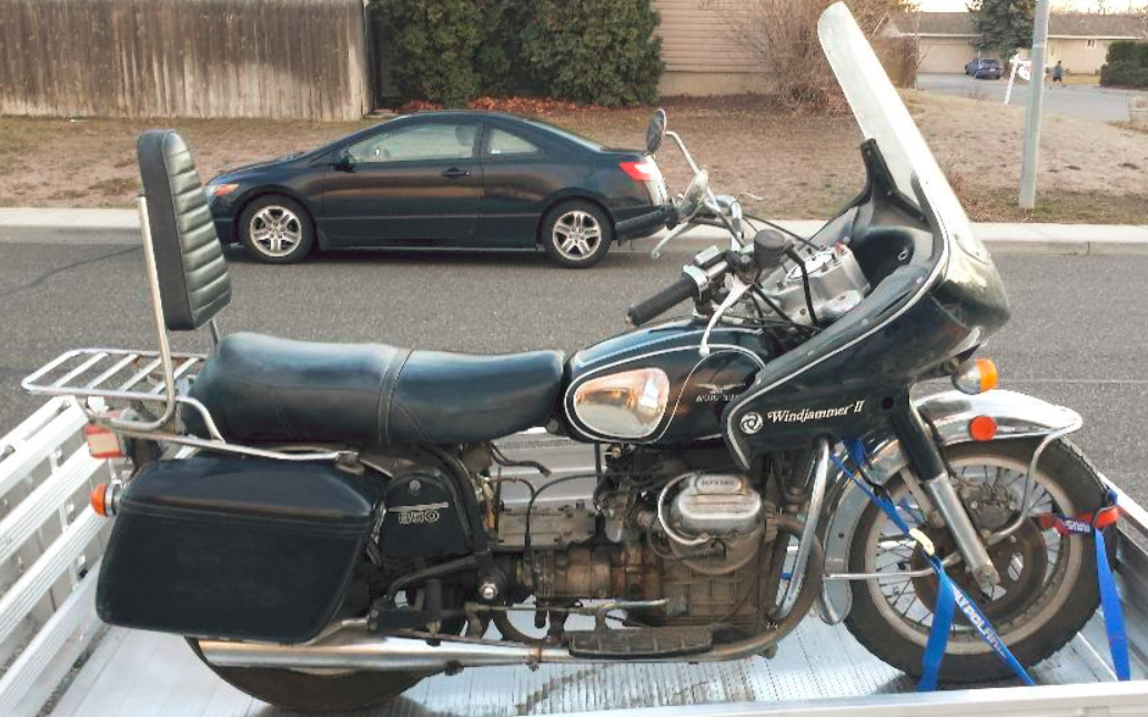

1. Donor bike - 1974 Motoguzzi GT800. Why? It has a Huge hole where the engine can go. Heavy frame (over built). It was inexpensive($2000). Shaft drive.

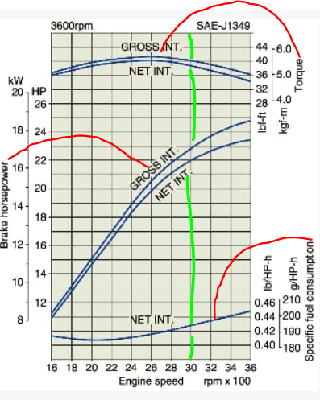

2. Engine - Kubota D902 - $1700. Why? Super mini series. Small foot print engine. 892 cc, 160 lbs , 22 hp, 3600 rpm. Might need turbo..

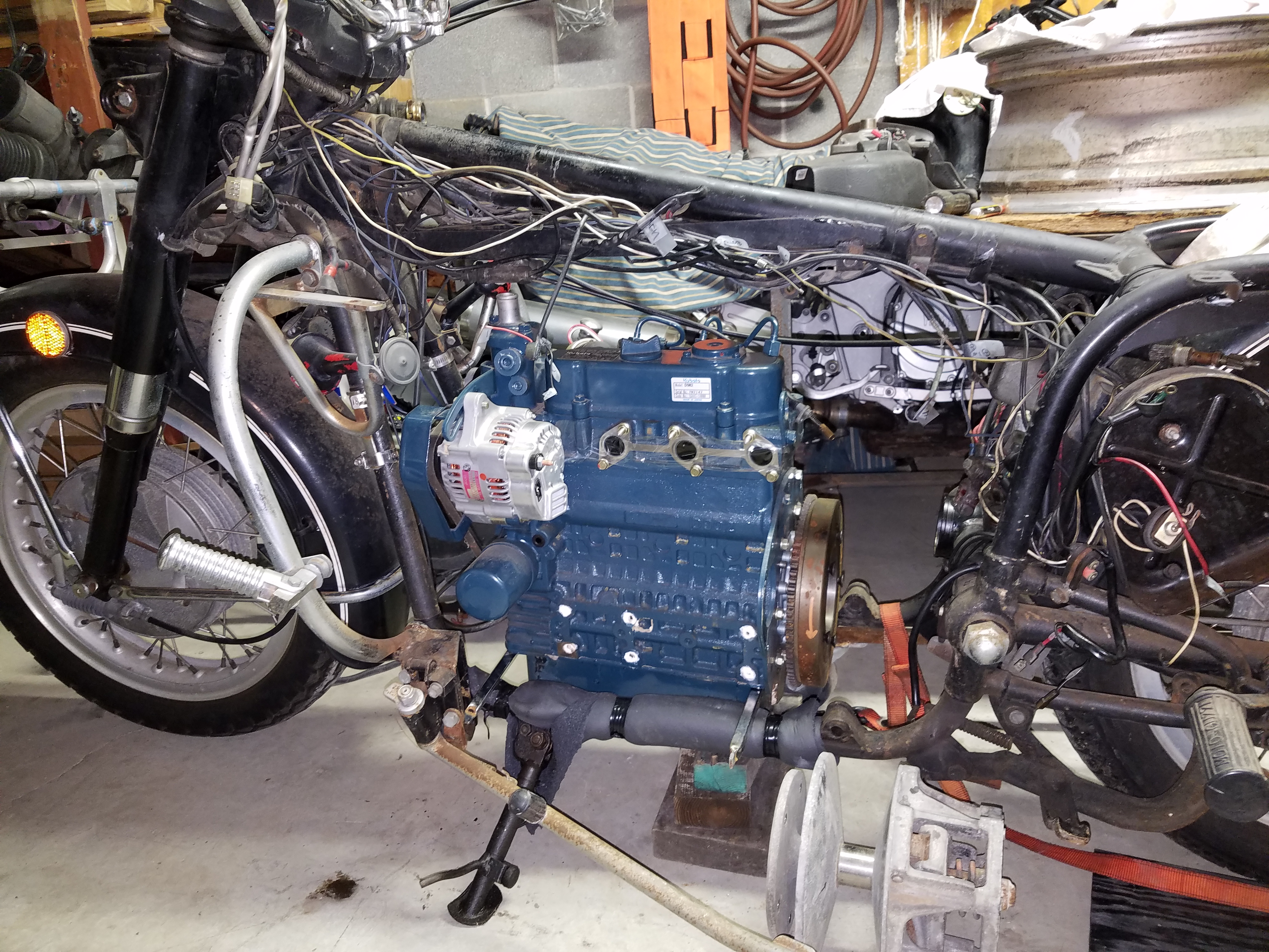

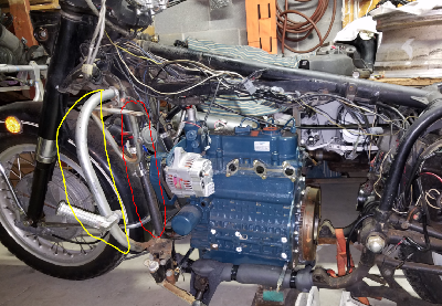

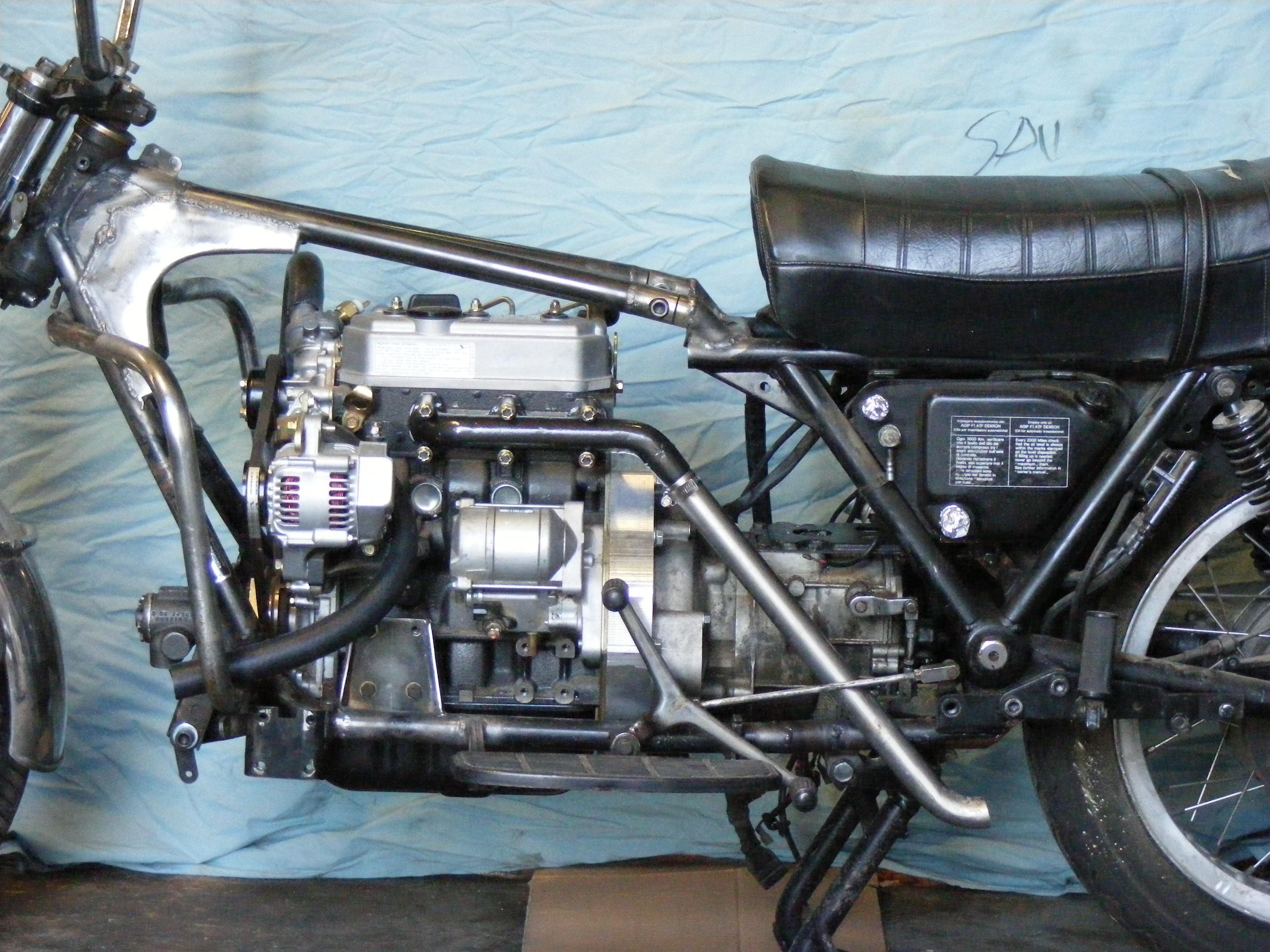

The new engine is hanging in the frame.
Hurdles
1. CVT or Harley gear box. The stock gear box is to long.

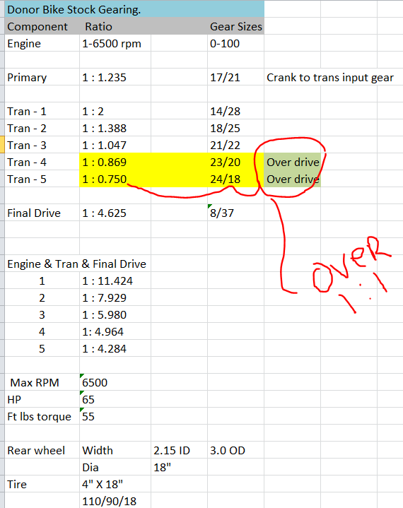

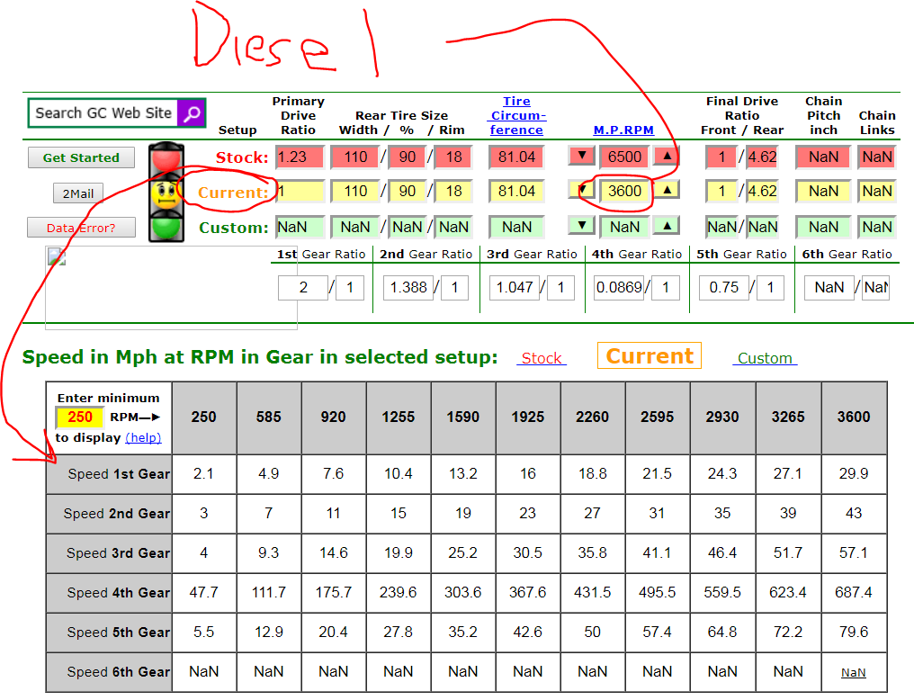

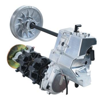

2. Calculating the proper gear ratios. I would love to speak to someone the understand gear ratios. I have all of my number.
3. The never ending question.. What gear box? I spent hours looking at various ATV, snow mobile and Harley transmissions..
ALL of them have too large of a gear reduction to accommodate the diesels like of RPM..
I would love to speak to someone about plotting the optimal gear box.. ratios.

Your affliction seems to be quite advanced Kenneth. And the prognosis suggests a permanent condition. That said, great to see you diving right in. I agree the 902 is an excellent choice given the power-to-weight ratio. BTW, great price for that engine. And while there are turbo plug-and-plays, don't rule out the Aisin supercharger option (personal bias rooted in laziness). I've got a 902 in reserve waiting for the next build.
I suspect you've looked at Garbs 722/cvt combo in a CX500. Would be down-sized version of what your building. However, he was able to shoehorn the Comet 40 in since, with the 18 hp rating, it would handle his 722. Not so for you. Nonetheless, it's a good study in engineering.

And then here's a discussion to puzzle out what you're pondering utilizing a Harley box with limited space. You do appear to have a good bit of space topside.

Good choice of engine and donor but you are going to run into the same problems as me with my D722 and Dnepr donor.
If it is at all possible keep the original gearbox, (and its location!), and see if you can change the gear ratios.
Some ways I used to achieve this is:
-Bigger rims to fit larger tyres, great advantage of spoke wheels.
-Bigger final drive ratio
-Changing the actual gear ratios in the gearbox
-Machining the clutch-flywheel package to be as small as possible to create more room in front of the engine
-Modify front suspension to make room for the engine sticking out (I'm putting in an leading link fork).
-Put the engine in at an small angle leaning to the left, you'll clear the injection-pump-rail and you can relocate the alternator and oilfilter.
I'm sure I missed something but here's my build thread: https://www.dieselbikeforum.com/view ... 67994b6dcd
Best of luck!

Allow me to filter through the questions:
1. Ron- Turbo and super charging - Hopefully by going with the larger displacement of the D902 force air will not be needed. This will avoid expense, complexity and promote longevity.
2. Ron- Have I seen Garbs 722cvt CX500?.. YES..Amazing work..I would love to speak to him about the end result.
His set up is the way I am leaning...right now..
3. Ron - A Harley Gear box.. Because of the numerous aftermarket providers, custom gear ration can me bought.. Pricey tho..
3. Ron - Gear box or CVT - I think I prefer the CVT. But tuning the slow speed characteristics of a cvt can be difficult.. With a conventional clutch you can slip it until you pull away.. CVTs do not like to slip.. The CVTs critical issues will be over deceleration braking and the slow speed to neutral release point..
4. CVT negatives.. People, we love to hear the sound of our engines.. I had a CVT- Ridley mini harley. The sound of the 700 v twin was amazing.. It also made one hell of a sound when my friend reached over to blip the throttle.. Just as the word "NO" left my mouth the bike went through the garage door. Live and learn.. yes I know put it on the side stand..
5. Ron- Frame modification- Nothing is off the table.. The Guzzi group will disown me with they find out I am butchering a running Guzzi.. Shhhhh
6. Tet - Using the Stock gear box.. yes that is an option.
Pros: 1. it matched the Drive shaft input.
2. mounts are inplace
Cons 1. large, heavy
2. Custom gears sets are EXPENSIVE. No other stock gears are available that I have found
7. Tet - Bigger final drive ration - Bigger the final gear ratio is already to tall for the diesel engine. ??
8. Tet - Putting the engine in at an angle.. That is one option I am looking at to allow the CVT room..
Thanks for all of the great input..
I would LOVE to have a Final Gear ration conversation.. I have read so much about ratios.. I have confused myself.
Primary ratio? I can not figure out my stock primary ration.
Gear box ratio? The goal is to find a CVT that can create the same range.
Final drive ratio? I might have to switch to chain drive to compensate for the lower rpm of the diesel.
How do I confirm the ratio number?

Re: New build- 1974 Guzzi Eldo and Kubota 902

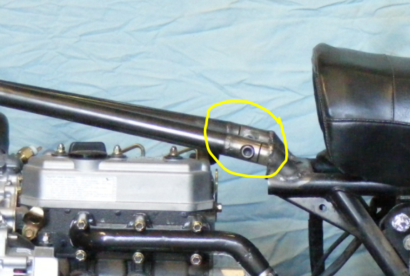

In the 2nd pic with the engine across the frame does it not have to be round the other way to get the correct rotation?
In the inline position it looks as if it will go further forward if you eased out or fabricated some bowed out down tubes.
However you are still left with the fixed ratios if using the standard gearbox.
Going across the frame would allow a Harley or other gearbox but you would then require some sort of 90 degree drive if keeping the shaft drive.
You might get an inline engine with chain drive gearbox in there but you would have to lift the gearbox up with a chain/belt drive to gearbox from flywheel then another chain/belt to the drive shaft which would need a small jackshaft to mount a sprocket and outrigger bearing.
The beauty of adding in a chain or belt will instantly give you an easy and cheap way of altering gearing.
A lot depends on your fabrication skills and available machinery. The simplest way would be across the frame with a Harley box and possibly a small jack shaft to bring the final drive/gearbox in line.

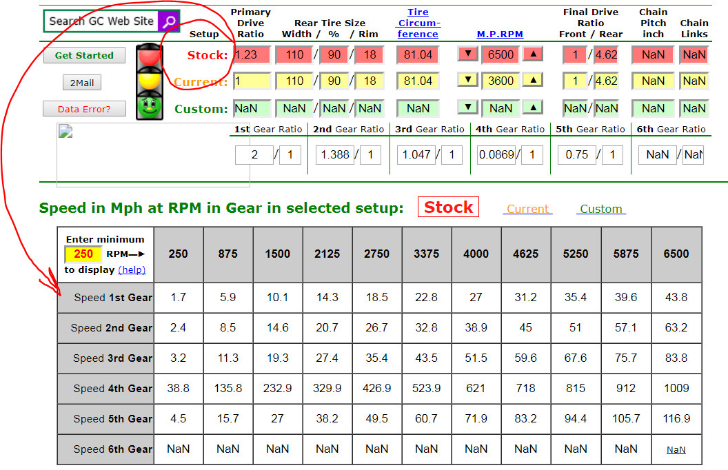

The numbers from your gear commander screenshot seem off but you can count your gear ratios and calculate it yourself.
The ways to do that is as follows:
I'm using the final drive unit for my Dnepr as an example
#1 Counting teeth
I know its an 35/10 set.
Meaning that the Pignon (INPUT) gear has 10 teeth
and the Crown (OUTPUT) has 35 teeth
Simple devision:
OUTPUT devided by INPUT = Final Drive ratio
35/10=3.5
For this gear set the INPUT (Final drive shaft) will have to turn 3.5 times to turn the OUTPUT (Wheel) once.
#2 Counting revolutions
This once is easy but not as accurate
Turn the INPUT untill the OUTPUT has turned once, whilst counting the rotations of the INPUT.
So for my Dnepr FD unit I'd turn the Drive shaft (INPUT) 3.5 times before I have turned the wheel (OUTPUT) over once.
Using this you can calculate just about any gear ratio be it final drive or gearbox
Can you tell me how many rip-ems (RPM) the bike did when traveling lets say 60 MPH. If its below 3600 rip-ems I'd, REALLY advice you to stick with the stock gearbox.

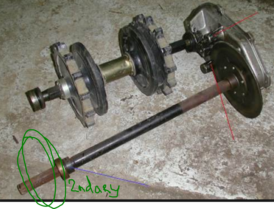

I suspect I will end up with a lay shaft..
I think it is the best solution to fine tune the final gearing.

"In the 2nd pic with the engine across the frame does it not have to be round the other way to get the correct rotation?"
Maybe.. the engine turns anti-clock wise ( looking at the flywheel). The drive shaft turns clockwise ( from the engine side).
"In the inline position it looks as if it will go further forward if you eased out or fabricated some bowed out down tubes."
Correct. I can get about 5" more with a frame modification
"However you are still left with the fixed ratios if using the standard gearbox.
A lot depends on your fabrication skills and available machinery. The simplest way would be across the frame with a Harley box and possibly a small jack shaft to bring the final drive/gearbox in line."
Good Idea.. This is what I am thinking after studying it last night. .THANKS for the ideas!!

"I doubt that the current FD ratio is to tall for your diesel but if its really that high up, don´t change anything."
It is this assertion that has me confused.. This is why I am trying to pin down the drive line gear ratios"
I will redo the gear chart.. I am going to start with the Stock motorcycle with stock gearing.. And the try to back in my application.
From a layman perspective.. it appears that since the diesel engine runs at 1/2 the RPM as the Stock engine, I simple need to Double my input speed into the drive line to maintain the same final ground speed.. MAYBE that is OVER SIMPLIFIED????
The stock bike engine had an RPM range of 0-7000 rpm for a ground speed of 100mph...
IF my diesel engine only spins at 3500 rpm - I will need to over-drive the stock trans/final drive to maintain the same ground speed?? AM I wrong with this logic ??
#1 Counting teeth
35/10=3.5
I have a 8/37 ring and pinion. Stock Guzzi Gearing.
Thus a 1 : 4.625 ratio.
One rotation of the wheel takes 4.625 of the engine ( with no transmission)
The number I have right now say 60mph at 3300. If this is true.

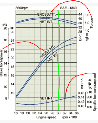

This is not the proper top gear ratio for touring?? I have the engine specs for the D902.
Based on the HP, fuel consumption and Torque Curves it would appear I should target 3000 rpms at 75 mph.
This will should put me in the sweet spot of the engine and limit the engine vibrations???
This machine will have to run on the US interstates. 75 mph is needed.
PLEASE Point out the ERRORS in my logic.[/color][/color]

I have the Specs for the stock motorcycle gear ratios.
Do most motorcycle transmissions run greater than 1:1 in the highest gear?
Click to zoom in..
4 gear is 1 : 0.0869
5 gear is 1 : 0.0750
If I am reading them correctly 4 and 5 gears are greater than 1:1.
Meaning over drive - output shaft spinning faster than the input.
This is correct?
If it is correct I am surprised to see a bike of this era (1974 Guzzi) running over square in the transmission.
Are you?
CVT considerations ..
I dont think a CVT can recreate the hi and low gear range.?? Low 1:2 Hi 1: 0.75
Everything I have read indicates 1 : 1 to be the HI on the CVT..

Woah, loads of stuff.
klwinter2 wrote: "I doubt that the current FD ratio is to tall for your diesel but if its really that high up, don´t change anything."
What I meant is; gasoline engines normally run higher rip-ems than diesel engines. Thus, if anything, the gearing will be to low for your diesel to attain the speeds you want. (See further explanation below)
klwinter2 wrote: From a layman perspective.. it appears that since the diesel engine runs at 1/2 the RPM as the Stock engine, I simple need to Double my input speed into the drive line to maintain the same final ground speed.. MAYBE that is OVER SIMPLIFIED????
IF my diesel engine only spins at 3500 rpm - I will need to over-drive the stock trans/final drive to maintain the same ground speed?? AM I wrong with this logic ?? [/color]
You are talking maximum rip-ems. To attain the same speed with less rip-ems you will need to LOWER the gear ratio of the entire drive train. So you will have to put in less rip-ems for the same speed.
klwinter2 wrote: I have a 8/37 ring and pinion. Stock Guzzi Gearing.
If that's what you want, go for it. Don't let me stop you.
But keep in mind that these engines were designed to run at 3600 rip-ems all-day.
klwinter2 wrote:I have the Specs for the stock motorcycle gear ratios.
Nope. Most run higher, because rip-ems are fun.
klwinter2 wrote: If I am reading them correctly 4 and 5 gears are greater than 1:1.
This is correct?
Eh, kind off? But I think you're using the terminology wrong here.
When we talk overdrive for vehicles it means that the engine rip-ems is lower than drive wheel rip-ems.
So you need to calculate your total drivetrain gear ratio for each gear.
Here's your top gear:
(Final drive ratio) Multiplied by (Gearbox ratio for that gear) = Total drive train ratio
4.625 * 0.750 = 3.469
Which is nowhere close to overdrive.
For each turn of the wheel the engine will turn over 3.469 times.
Honda VT600 C Shadow
H̶o̶n̶d̶a̶ ̶C̶B̶R̶6̶0̶0̶F̶2̶
Mercedes-Benz W123 300D Sedan

1. A "high" ratio final drive is in regard to the ratio (e.g. 1:5). The RPMs delivered to the wheel are 1/5 that of the engine RPMs. A high ratio final drive should not be confused with thus producing a "high" speed. Quite the opposite. It will result in a much lower speed than a "low" ratio final drive for the same engine RPM.
2. A "low" ratio final drive (e.g. 1:3) will produce less torque but potentially a higher speed for the same engine RPM
You are correct.. I was incorrectly swapping terms.. HIGH GEAR does NOT equal High ratio. My bad..
3. Here in the colonies, the term overdrive has historically meant that the RPM delivered to the final drive is greater than that of the engine and separated from any reference to the final drive ratios. That is, the output shaft is spinning faster than the engine. The "overdrive" is attained by way of countershaft ratios, an integral overdrive unit or an auxiliary overdrive box. Not to confuse further, but final drive ratios can be such that a vehicle will be referred to as being "overdriven" while in the absence of a gearbox related overdrive.
Correct.. I speaking of the gear box.. I was surprised that the 4th and 5th gear were Greater than a 1:1 output.. ie overdriven

I was studying snow machined.
Snow machines have had CVT for years and there seems to be MANY more after market parts for them.
Here in TN... I have never seen one...
No wait.. we had a neighbor moved to TN from MI..
They had a snow blower and a snow machine for sale in the middle of summer, 5 years after they move down here.. No one bought them... :roll: :lol: :mrgreen:

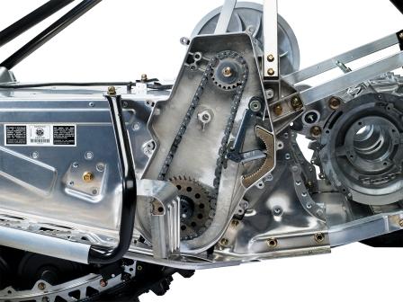

It appears the snow machines have a chain reduction to the drive belt just like a motorcycles final drive..
Photos are hard to see the parts.. But here is what I found..
The green circle is where the Secondary clutch mounts. The Jack shaft includes the Brake, Then to the chain drive to the belt..
I'm steel looking for the ration in the chain case.

Some details about my diesel Moto-Guzzi project that might answer some of your questions: the engine is a 3 cylinder Diahatsu 950, bought new. The tranny is the stock 1978 Moto-Guzzi Convert unit, which uses a hydraulic torque convertor to connect to the flywheel, making adaptation easier than fitting a Moto-Guzzi clutch. The Convert has a 2-speed tranny behind the torque convertor with a dry clutch in-between. High gear is for highway use, while low is used in town as it gives a bit better acceleration but limits top speed. There’s no neutral, so you only shift while stopped. Two speeds work fine in combination with a torque convertor, other than the torque convertor output rpm is always lower than the engine rpm. This is sometimes called “slippage”, and soaks up some of the engine power, which also means poor fuel economy compared to the other models. To make up for the slippage in the torque convertor the Convert final drive “differential” has taller gearing than other models; 9/34 (3.778:1) vs 8/37 (4.714:1). But, it isn’t easy to swap; the drive shaft and rear housing/swingarm are unique and won’t fit other transmissions unless the front input shaft from a 4 or 5-speed tranny is used, and the u-joints are also different, requiring some machining. Obviously if you’re starting with a 5-speed then you’ll need to find a complete Convert rear drive if you want to go this route to get 25% taller gearing. It’s worth noting that the Eldorado tranny has a slight overdrive in 5th (1.079:1).
The Convert rear end has a single brake disc but two brake calipers – a primary hydraulic one, and a cable operated parking brake that operates when the kickstand is down, preventing the bike from moving when the engine is started. Remember that the Convert tranny has no neutral, so it’s always in gear – don’t goose the throttle unless you want to start moving with the kickstand up. There’s a learning curve with Converts.
With my stock Convert tranny and stock final drive, 3600rpm gives about 64mph. That’s not fast enough for USA highways and freeways. I’m modifying the Convert tranny for taller gearing by changing the input shaft “primary” gear from the stock 19-tooth to a 24- tooth gear, which also means moving the intermediate shaft about 5mm. This will give it 80 mph at 3600 rpm, and obviously lower rpms at lower speeds, which should help fuel economy. I’ve already machined off the old gear and welded on the new one, and am in the process of relocating the intermediate shaft bearings to make everything line up properly. A 24 tooth gear is from a spare output shaft, or used parts places, or NOS.
I also have a T-3 5-speed tranny and the matching front drive shaft, in case I can figure out how to fit a clutch to the diesel flywheel that will work with the Guzzi tranny input shaft and clutch release mechanism, but that’s harder than modifying the Convert tranny gearing.
The original stock Convert with gas engine got around 35 mpg on the highway, somewhat better at lower speeds. If you have to deal with stop and go traffic, especially if traffic is creeping along, the Convert is great, since you don’t use the clutch at any speed. That saves your left hand. With the Daihatsu diesel the mileage went up to 45 mpg or so. Adding the Vetter streamlined nose increased that to about 65 mpg. The next step is to fabricate the tail, which is as important for proper aerodynamics as the nose, and should bump the mileage up even more, with a slight increase in top speed at 3600rpm, but probably not enough to keep up with freeway traffic, so the tranny mod is still necessary.
The Daihatsu engine is longer than the stock engine, and has a cooling fan and water pump on the front, so the chassis has been stretched about 5 inches. The taller engine also required different frame geometry to clear the valve cover. The stock fuel tank would no longer fit, so I made a new one that kept the angular lines of the original one – keep that in mind, it took one whole winter the way I work. YMMV.
The torque convertor generates heat so there’s also an oil cooler and pump in addition to the engine radiator. I kept the mechanical radiator fan for simplicity. The 30psi oil pump is driven directly by the crankshaft at the front. The Daihatsu exhaust manifold points straight out to the side, about where my knee would be. I fabricated a new one that points back, tucked in close to the chassis, like a real motorcycle. The tail pipe was originally a stainless steel bathroom grab handle ($5). The muffler is a chrome reproduction Triumph unit from Bent Bike. The stretched chassis require a longer speedometer cable, which isn’t like any other until I tried one from a snowmobile! The bike now weighs about 500 lbs, or about the same as the police version with all its equipment, or riding two-up. It also feels top-heavy, which isn’t surprising with the taller and heavier engine and the larger fuel tank (8 gallons when full). The longer wheelbase changed the handling, but on the road it feels solid and tracks like it’s on rails. At parking lot speeds the top-heaviness takes getting used to.
I’m very happy with the linked-brake system that came stock on the Convert. Also the floorboards. When I modified the chassis to fit around the fatter diesel engine I didn’t want to lose cornering ground clearance, which was also reduced by stretching the wheelbase, so the floorboards are a bit higher.
I’ve run out of ideas to offer. Ask questions and I might have an answer.
Engine in stretched chassis

GuzziJohnO is a steel working artist.. Beautiful work..
What are the frame connection points called?
Did you buy or make these?

Frame cutting and modification
Post by klwinter2 »
I had hoped to avoid cutting the frame for the diesel install.
That is not going to work, so I will modify as needed..

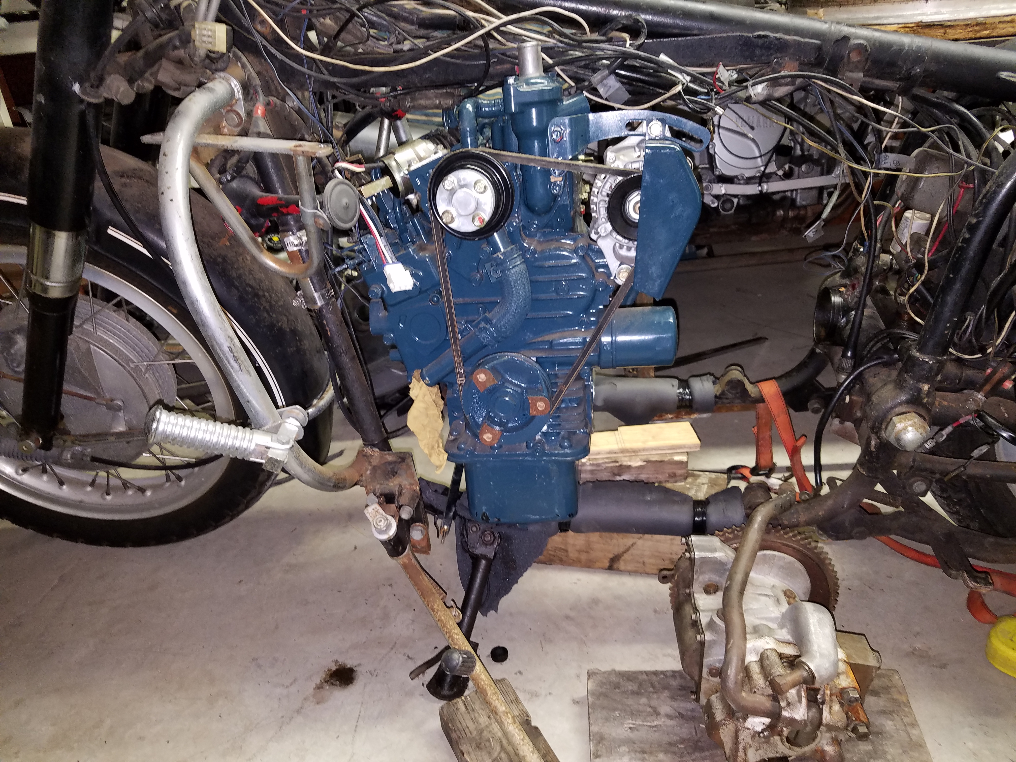

Right now it appears if I moved the whole engine forward 6 inches, I could use the CVT system.
It would require removing and modify the front two down tubes.
This will allow me retain the stock bike length..
My question are about CG affect of moving engine forward and crash bar strength.
1. By Moving the engine forward towards the front fender I can get the engine and CVTs into the frame. But it will change the balance of the machine..
Do you think moving the engine 6" forward would upset the CG too much???
2. Are the crash bars structural? ie are they strong enough to hold the frame shape while I build the engine mounts and come back with new front down tubes? red and yellow circles.
Before you start cutting metal just check that the front wheel and fender will clear the engine when fully compressed.
You could use a ratchet strap to pull it together.

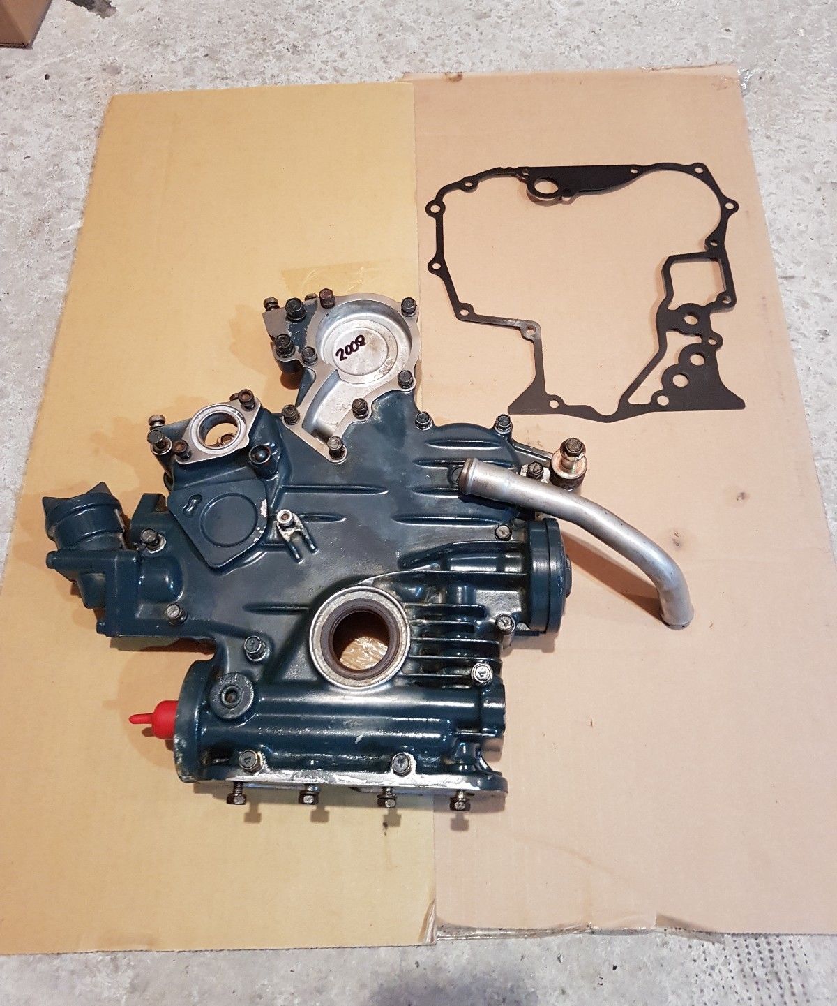

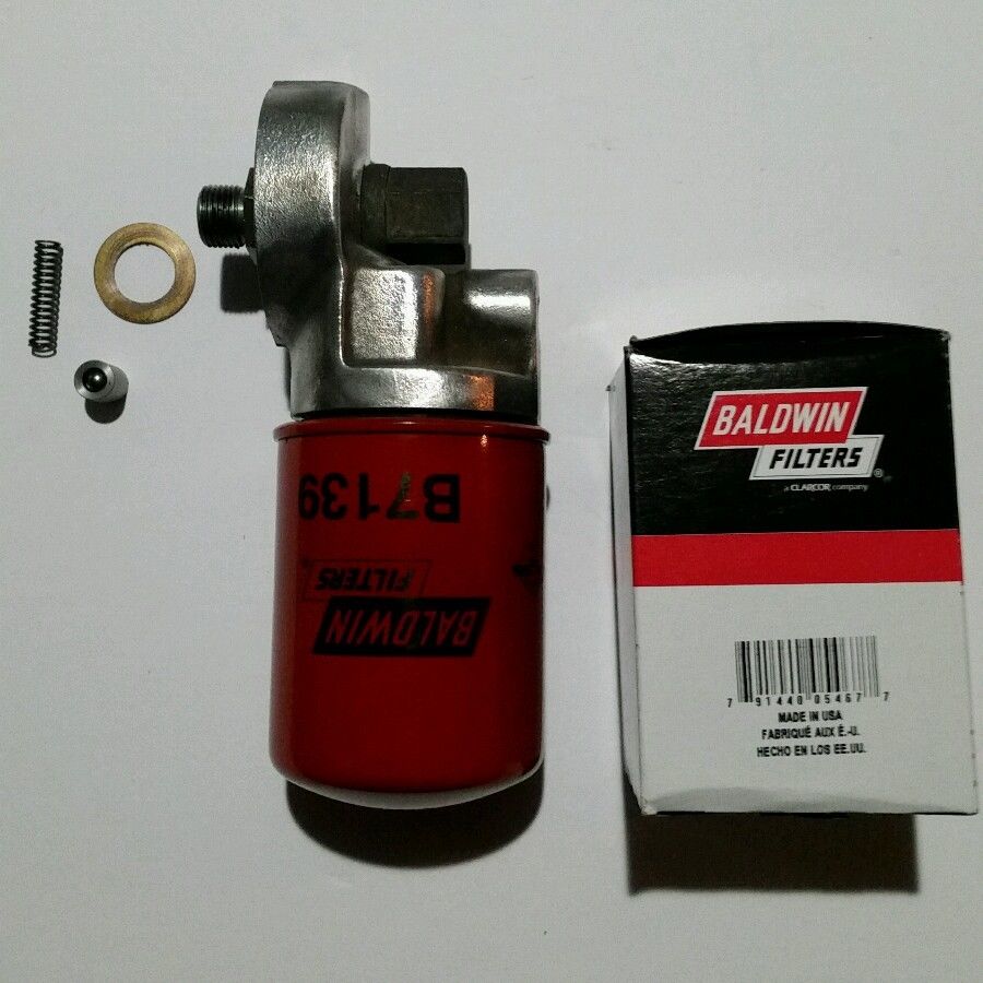

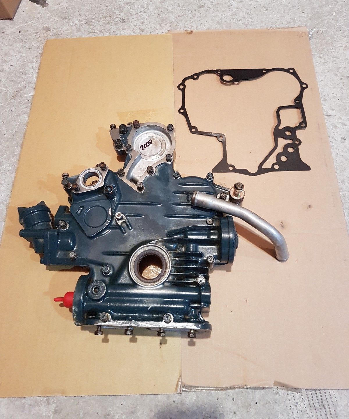

Gilburton's point is well taken. Clearance at the front wheel appears to be at a premium. And if a no-go, would mean a frame stretch instead. But, before you resort to the blue tipped chisel (isn't that the proper British term for the torch? Or more commonly referred to here in the states as the "fire axe") are you certain that engine can't be nudged further forward. It can be narrowed considerably. The alternator does not have to be mounted where it sits. A local Amish machine shop modifies the front crank pulley to drive additional hydraulic pumps. And their modification could instead mount a pulley forward of the downtubes to drive the alternator off to the side. Doing so would allow you to drive only the water pump vertically from the crank utilizing a tensioner.
Interference by the oil filter could also be addressed with the front cover in the pic below that offers either left (with red cap) or right filter mounts. The unused base is then capped off. There's an accompanying option of a right angle filter base that allow you for a full 180 degree orientation including tucking it back along side the engine under the injection pump.
The oil filler casting on the pump side can also be unbolted and capped off with a plate, narrowing the engine even further up front. And the oil filler tube/cap can be repositioned to either the pan or valve cover. But, still not sure it would get you a full 6 inche.
As an aside, the other benefit of choosing this engine is that when it comes time to mount your sidecar, your reverse can be driven by the hydraulic or power steering pump that bolts to the back of the injection pump cam. No doubt that's what Kubota had in mind when they designed it.
