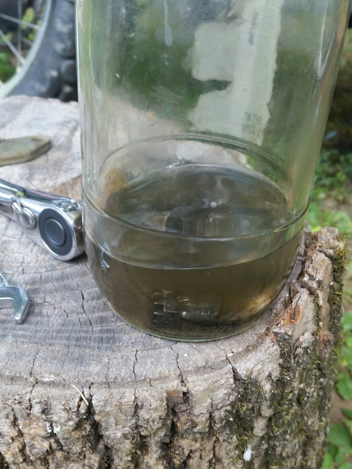

Jar pic..... 2.50$ worth of carb cleaner. Maybe Half a can sprayed into glass jar that once was morning fuel (coffee). This amount covered everything in the cleaner just fine. The good stuff only sold by the Gal. at around $30$
When disassembled things there was two small pins that locate things along with a few small parts. NO SPRINGS. There are three holes where pins where.. at first thought a pin was missing then saw the third hole is a bit smaller so don't think so. Anyway. this one being kept as spare. There is a breakdown in the generic Yanmar manual linked to here on this board in another one of the threads of mine. Can use it to rebuild the injector
