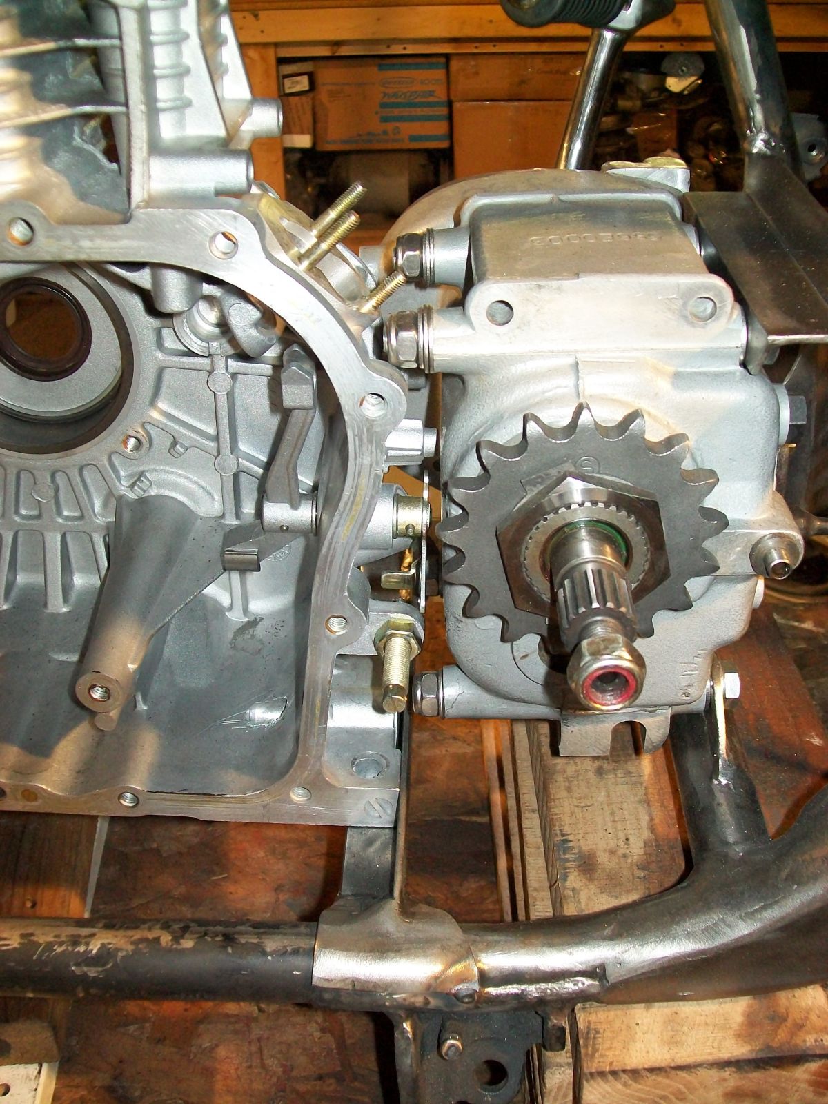

Here's the bike I'm talking about.
If someone has on sitting on the bench could you take a picture of it and give the dimensions of the parts?
Or maybe someone can point me to a Web Site that will have that info on the transmission would be great!

Re: Enfield Transmission Dimensions needed
Curtis,

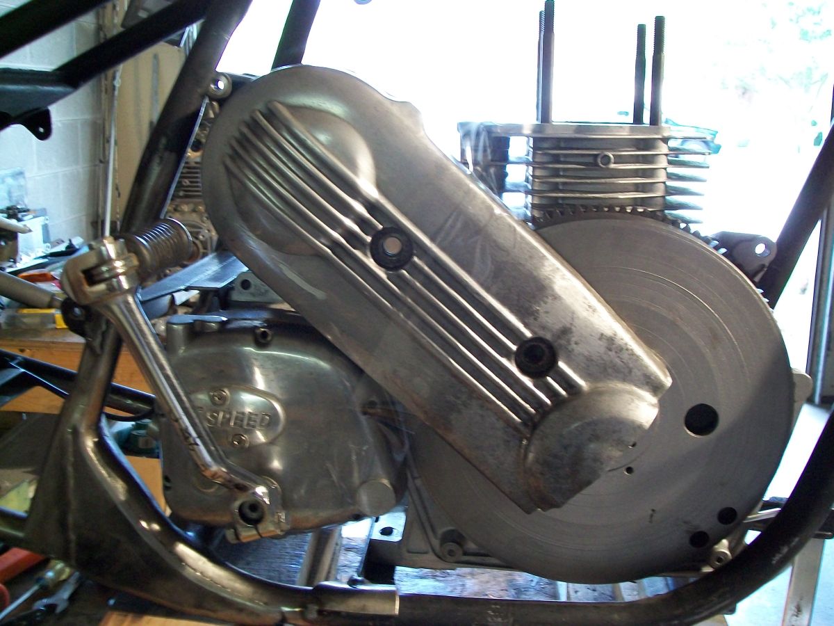

The dimension for the RE 5 speeder are as below. And I presume you're speaking of the recent production Indian built 5 speed as opposed to the Hitchcock UK produced 5 speed intended to replace the old 4 speed.
The trans requires a full 12 and 1/2 inches behind the centerline of the crank. And that's using the original RE 5 speed primary which snuggles you up to the Yanclone as close as you can get. It's 7 and 1/2 inches tall and measures 9 inches from the right hand cover to the centerline of the sprocket on the left (kick start shaft stub not included). Or 12 inches from the right hand cover to the end of the clutch retaining nut of the clutch on the mainshaft ( the clutch springs and retainer extend somewhat beyond the end of the shaft).
The main casting of the trans at it's narrowest is 5 and 1/2 inches. The forward facing bulge on the right is 7 and 3/8 inches using the same aft reference as the narrower dimension.
From the looks of your picture, it would appear you'd have to back up pretty far and get a good run at it if you intend to fit that trans in the available space. Additionally, I believe the fan shroud would need to be modified as the trans comes within about 1/8" of the flywheel. The pic below isn't the greatest, but you might be able to see how close it comes (click on it for the closeup).
If you should go that route, Martin Sprocket has the 06B-2 drive sprocket for the RE primary in stock in either Ft. Worth or Houston - can't remember. Get the one that utilizes the taper bore bush that's readily available about any where. Or if you've got one of those generator engines with the 26mm shaft, there's a company in South Caroline that has the 26mm bush.
