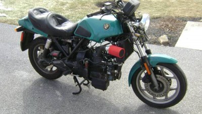

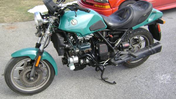

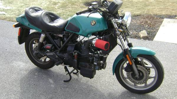

yes I built this bike

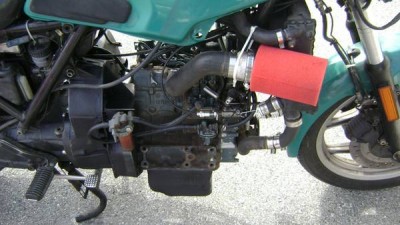

I can answer any questions that you guys might have. I will say I used the bmw trans and it runs and rides like a normal bike. The most fun thing I did on this build was to add the bmw ignition to the back of the alt. then mounted the coils back on the bike in order to pulse the ignition and make the tach work. only problem is tach is 2 times crank speed I haven't figured out how to cut the pulse in half. Fun side it's the highest reving diesel on the planet over 6 thousand rpm's. But it is nice to see the tach and speedo working plus the bike has abs brakes. No top speed on it yet but by next week I will have a number so far 46 in 4th and it was still going hoping for 60mph in 5th

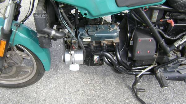

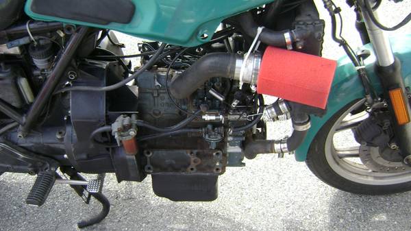

the bizarly that was a fun build good to see a pic of it. to start off the k100 trans is shifted to the right of the bike to center the pancake motor . yes I made an adapter plate to mount the Kubota to the bmw I also adapted the bmw clutch to the Kubota flywheel to use the clutch. in order to balance the bike I tilted the motor to the left 20 degrees I pie cut the pan so it was level with the bike upright and extended the pickup it also added more oil to the system used the bmw radiator. I know there are other tach options but I like to work with what I have on hand it was kind of fun to get the tach working with what I had. besides my way it will twist over 6 grand. I cut the front down tubes added a cross brace and hung the front of the motor from it.
