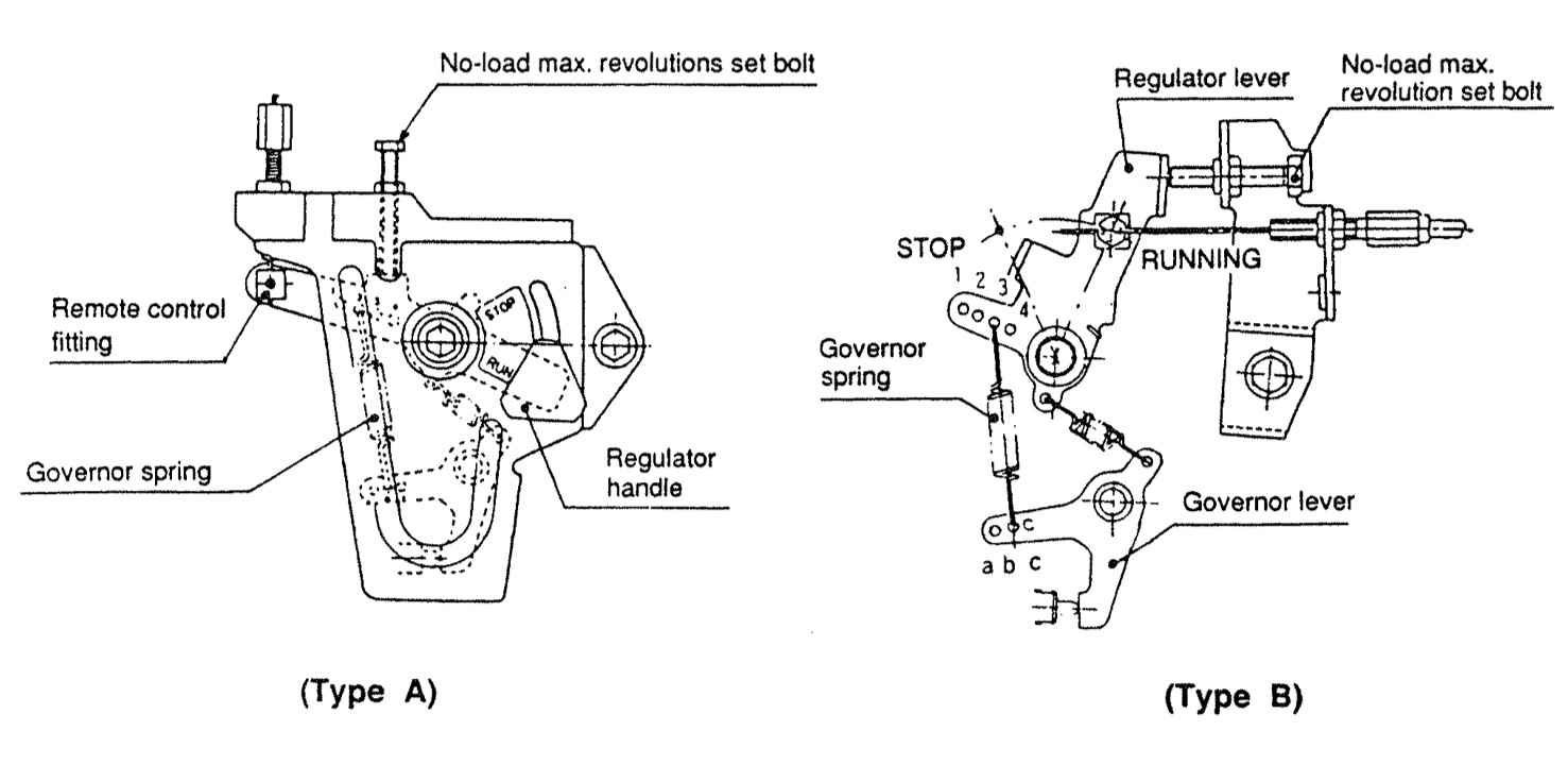

Re: spring setting and idling yanclone
For one, I can see you have tension on the governor springs at rest. With the engine off and the throttle at "stop", I'm pretty sure there should be slack in the two main springs. You can NOT substitute springs for any old spring you find, its calibrated for specific tension springs. Using the wrong ones can cause twitchy governor or engine overspeed.
Second, read through here: https://www.dieselbikeforum.com/view ... f=21&t=753
Third, see the attachment, I hope this helps!
Thanks for the info.. i 'knew'it already but good to take a look at in this context.
In the meanwhile, i tried something desparate and it worked! i changed the big governer spring for the one i had on the - also not good idling- 10 ps rotek engine, it is 1mm longer..
Now the engine runs very good and has stabil idling.
