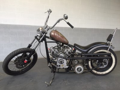

Hi All, I've been lurking here for a while. I've finally made some progress on my build so I'll start a thread. Thanks to all on this forum who've shared their experience, and to those who've answered my emailed questions. Started it for the first time last night. Exhaust, wiring, shift linkage needs to be sorted(before I can ride it), but here's a video of it running(on commercially produced B99 biodiesel):
http://www.youtube.com/watch?v=60QWByhbz-k
It's a Paughco frame(Harley aftermarket) that we cut the tube between motor and transmission and created a "Y" for clearance. Motor is a Punsun from a portable generator that had a tapered output. We had to cut and tap the taper and CNC an insert to fit the Primo from primary pulley. The motor has rubber mounts on the bottom and a head steady on the top. It rocks front and back, but not side to side.

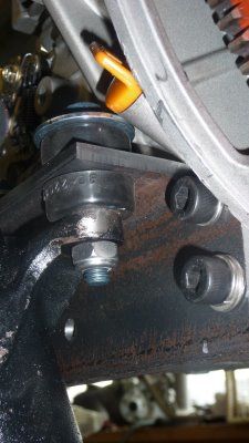

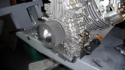

Here's a pic of the "head steady". Motor rocks forward and back, but not side to side, keeping the belt alignment ok.

Re: Punsun HD chopper
Gotcha, that looks like it will do the job

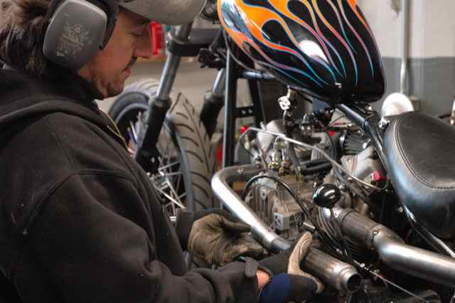

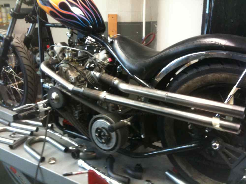

Got the exhaust started today. Here's a pic of Peter working with the flexi bits that were part of the generator's exhaust and then the final layout.

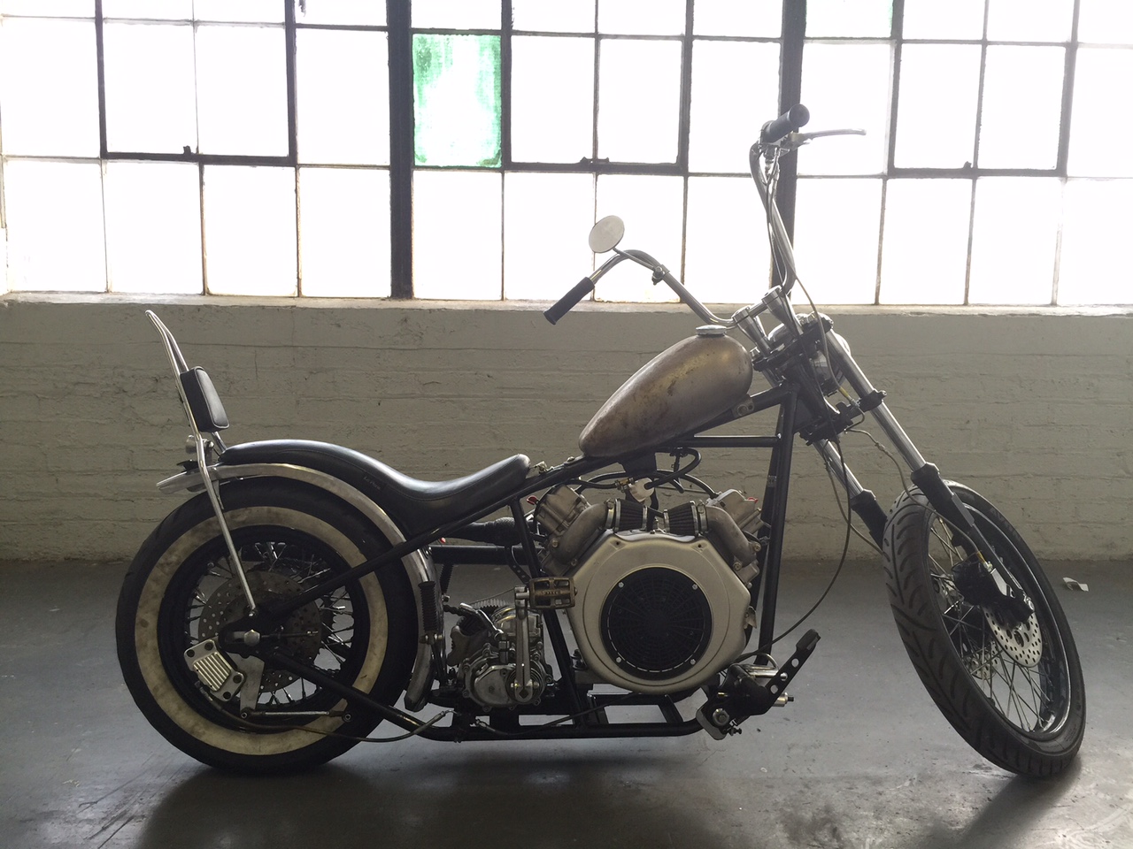

After 3 years I thought I would post a follow up.
Yes...I did eventually add a front brake. I rode it for a few thousand miles and enjoyed the frame cracking in half on the top tube under the tank and both supports we welded in the "Y" section between the motor and transmission.
We used thicker steel and got it back on the road.
It really ran well. I eventually added a Baker 6 into 4 transmission and could go 90MPH.
Recently it was running fine and then suddenly lost power. It appears that the Punsun blew. It still runs, but horribly. I found that the crank itself it wrecked, or the crank bearings are shot. You can rock the flywheel/crank back and forth. It is amazing it runs at all.
I haven't taken it apart yet to be sure, but this is what I know so far.
I got my hands on two Longfar motors that looked identical to the Punsun, except they have keyed 1" output shafts instead of the tapered one on my Punsun. It will require a new pulley insert. Then I realized that the Longfar motors also have different motor mounting points(vertical instead of horizontal holes) so it will need new motor mounts too.
Finally getting around to putting the pig back together. "Iron_Monkey" the adjustments I referred to were just changing the fueling screw. Nothing extreme, just adjusted for smoke.
The Punsun died due to the crank splitting in HALF right in the middle. I forgot to take a pic of it, but will and will post it. It is bizarre that the motor still ran afterwards.
I'm not sure how many miles I put on it(no speedo). Guessing maybe 5k. I really don't know though. Not a lot.
I had 2 Longfar motors that I ordered, hoping they would drop in. They have "feet" cast in the block(I didn't know this) so the mounting to the frame is different from the Punsun(no feet on block).
The crank was removed from one Longfar, but it is not the same as the Punsun.
So....the decision was made to change the frame mounts to adapt to the new case design of the Longfar motor. Theory is that the rubber mounting on the Punsun caused stress on the crank and killed it.
Longfar is now solid mounted to the frame with a new head steady without joints. Maybe the vibration will be miserable. Maybe it will destroy itself without rubber mounting. One way to find out.
Next step is to make a new insert for the front pulley(Longfar is a keyed 1" output and the Punsun was a taper).

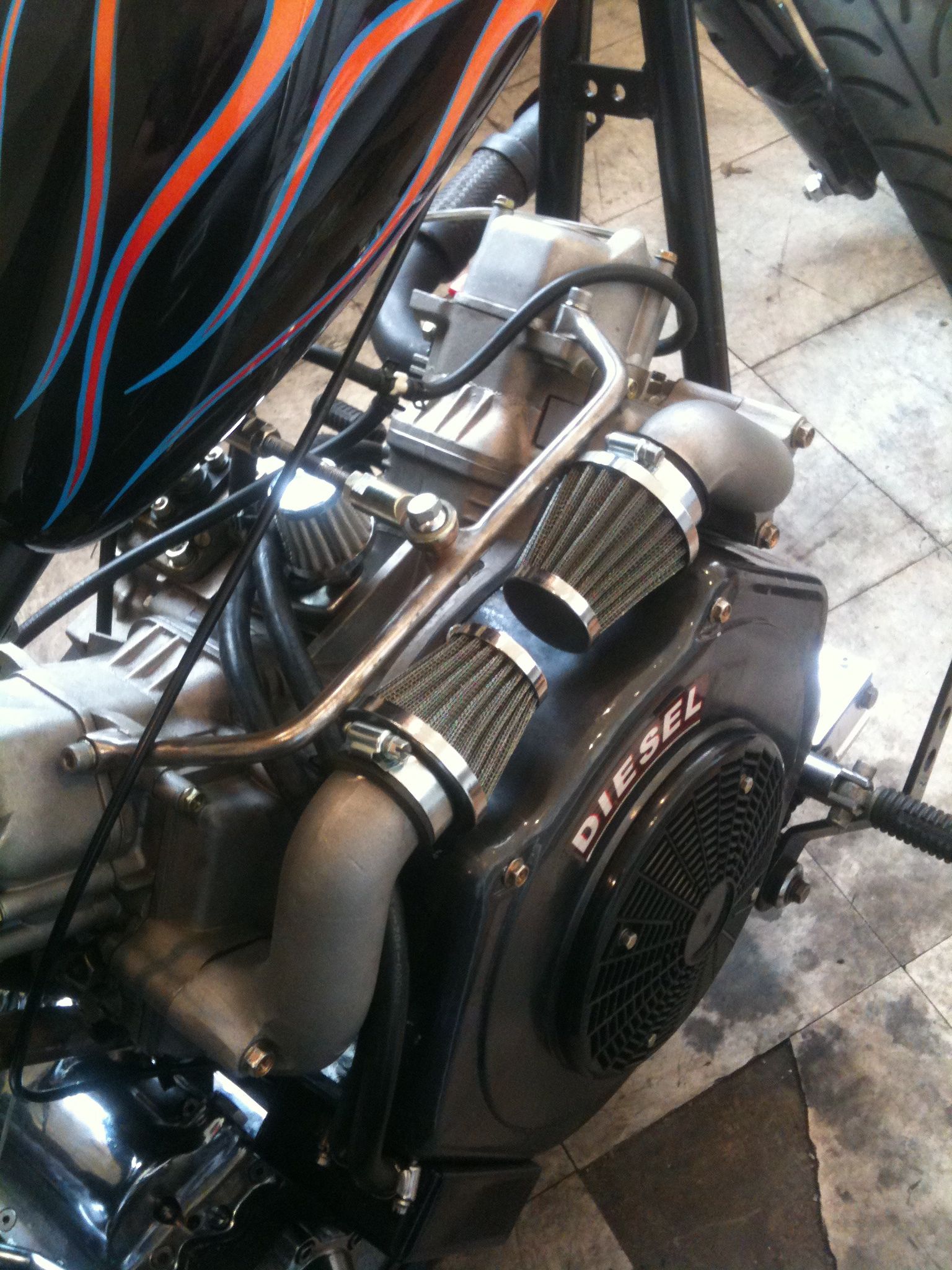

Finally got the motor in and running. Actually seems to vibrate less than the rubber mounted Punsun. Maybe this Longfar has better balance.
I need to finish the primary.
