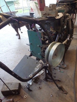

Alright - here's the progress with pics so far!
I got the engine baseplate tacked on before - it still needs some adjusting to get the motor in place and lined up correctly. It's just tacked on for now while I figure that out (currently working on that). You can also see what I did just this past weekend - mounted the jackshaft and secondary CVT pulley. Everything is just tacked together right now - I still need to work on the bottom frame mount of the jackshaft a bit - it's just got a throughbolt through the original engine mounts holding it in place.
Here's a side view of the jackshaft. As you can see, it's not finished, but it's all where it needs to go!
Project: 1980 CB750 with Hatz 2g40 (CVT)

Maybe Im not seeing it...... but how are you adjusting Jack shaft distance from Primary Pulley on engine for purpose of CVT belt remove/replace, along with tension adjustment?

Re: HondaCB+Hatz Scrambler project
Your pics reminded me very much of how I mounted mine although I was struggling a bit with the MZ frame room wise lol
One thing I did do was weld the mounting plate on to the upright jackshaft plate in an "L" type configuration as I felt that it would tie the 2 elements together in a sort of old Brit bike unit/pre unit sort of way and be stronger.
If I've any criticism your jackshaft plating looks a little thin? I used 6mm or 1/4" on mine and that was only an 8hp single :D

Yup! plating seems a bit thin to me as well, but it's what I got lying around the shop. I'm going to get everything in place first, and then add bracing wherever possible. FWIW, the guru who's advising me seems to be totally unworried about it. We'll see what happens!
Just finished up releveling and adding a bit of bracing to the engine mount plate, so I'll be remounting the engine to adjust the hole pattern next! Moving along!
Thanks again for everybody's advice - everything is very much a learning experience for me right now!

Post by sideshow »
Alright - long delay, but I've been busy. All the major pieces are in place - here's proof!
https://www.youtube.com/watch?v=BjNT1qur1U4X
Hope y'all enjoy! Didn't quite get to the video before dark - I'll have to get a better video in a bit in the daylight.
Still plenty of plenty of work to do. Found a small oil leak that needs to be tracked down now, plus plenty of big stuff left - exhaust, air filters (just arrived!), CVT tuning, and a lot of beautification/cleaning up from the last owner. But it does feel super nice to get to this point!
One thing I noticed - the fuel shutoff solenoid takes a lot of power draw. I'm guessing people here have moved to a mechanical fuel switch? I'd be interested to hear what people have come up with - my first thought is some kind of cable-activated latch that i can wire to the now-unused clutch lever.
-Alex
