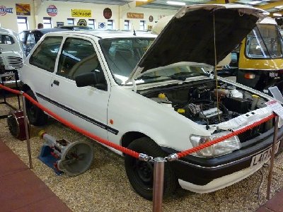

iirc werent ford experimenting with 2 stroke diesel engines for small fiesta sized cars in the 1990s, i seem to recall that queens university belfast were involved somehow too. from memory they were getting decent performance with a turbo and exceptional economy too.

John, I saw that Ford Fiesta 2 stroke but I don't think it was a diesel. It is at the Haynes Motor Museum.johnr wrote:iirc werent ford experimenting with 2 stroke diesel engines for small fiesta sized cars in the 1990s, i seem to recall that queens university belfast were involved somehow too. from memory they were getting decent performance with a turbo and exceptional economy too.
