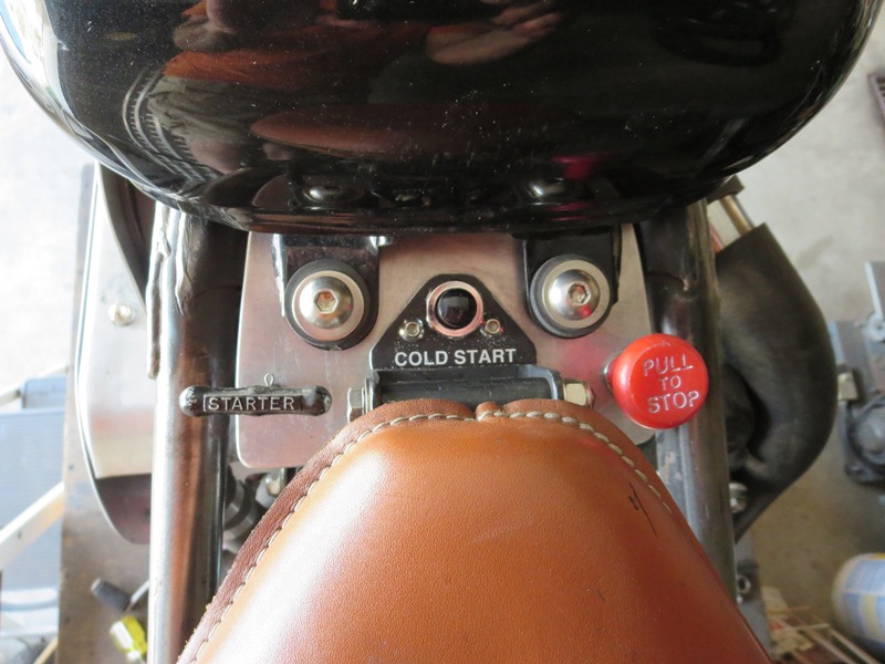

Today's result. And Freud would be pleased with the placement of those power controls.
Left to right as follows.
1. Starter pull handle from Pratt & Whitney aircraft engine
2. Glow plugs fired by 60 amp starter button from 1937 Cadillac
3. Stop cable from Ford diesel tractor

Love your selection of practical Gizmo's with an almost steampunk attitude.
Re: Honda 750 with Kubota Z482
Looks great! Make sure you tie the stop lever to the "Throttle" and not the decompression lever.
Fortunately, the Kubota has a dedicated shut-down lever on the pump to couple the pull cable to. But no decompression lever. We'll see how kick starting goes.Make sure you tie the stop lever to the "Throttle" and not the decompression lever.
Ah completely forgot its a 482, even though its in the title!pietenpol2002 wrote:Fortunately, the Kubota has a dedicated shut-down lever on the pump to couple the pull cable to. But no decompression lever. We'll see how kick starting goes.Make sure you tie the stop lever to the "Throttle" and not the decompression lever.

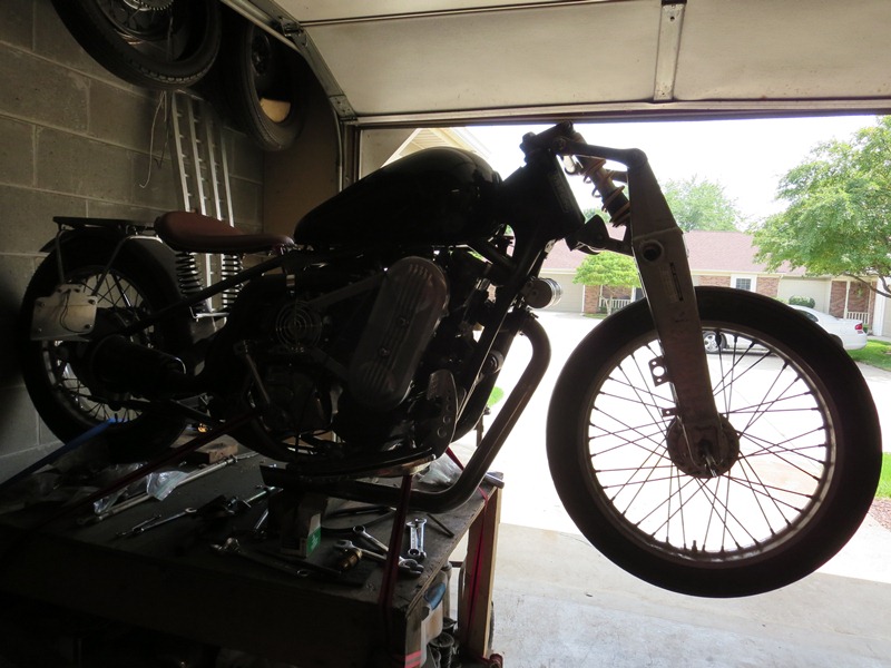

For mock-up purposes I hung the girder today. The shot below in silhouette is intentional as I suppose I don't possess the confidence to reveal all the unsorted bits. The math seems to be working out quite well with roughly 4" of trail. I have a rebuilt set of later model 750 forks to bolt on. But, I've always wanted to do a girder. Whereas telescopics under full compression (i.e. hard braking) can reduce the trail and wheelbase by as much as 4'', I was able to set this up such that the front axle travels almost vertically when the suspension is compressed. Should make for better handling when braking in turns. Time will tell. All needle bearing pivots and aluminum construction makes for light and smooth action. But, plenty to do yet until it's fuly functional. Suggestions and critique are most welcome as I'm swimming here in uncharted waters.
