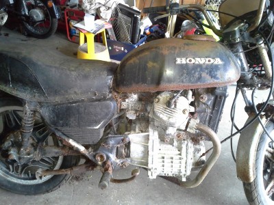

I now have assembled most of the parts to start my build. I have sourced a Honda CX500 in a very sorry state, an Aixam 500 diesel car for the engine and CVT and a Lombardini twin (the engine I originally got). I will post details of the build as it progresses.
There are no layouts in mind yet I may follow Heiko's design with the CVT behind the engine. The bike may only be suitable as a jig for the engine and drive so I will be looking out for a better bike later.

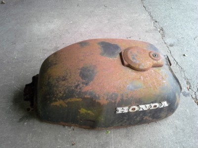

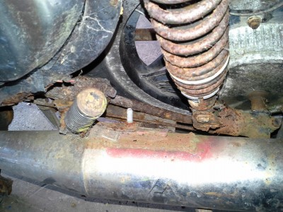

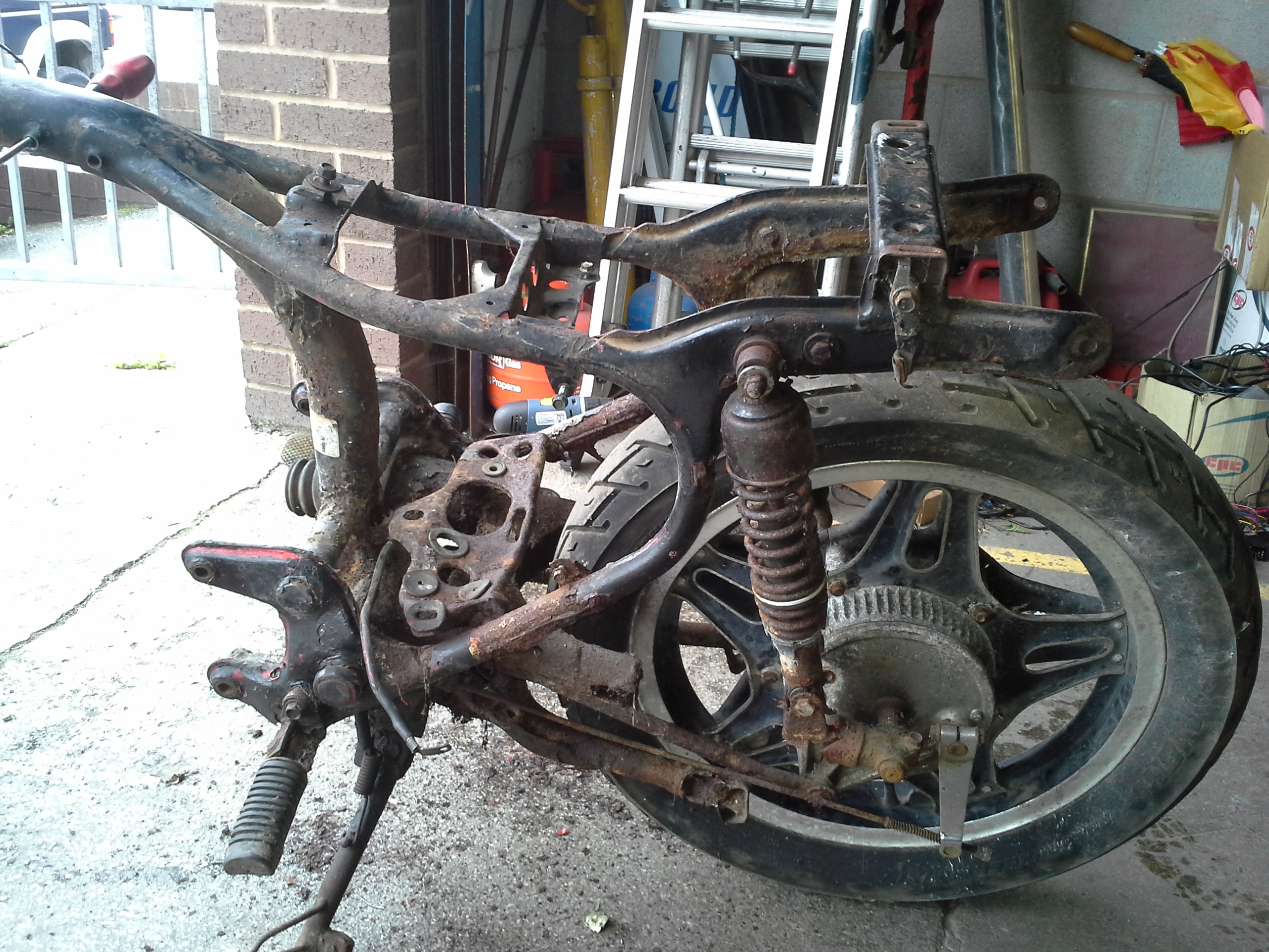

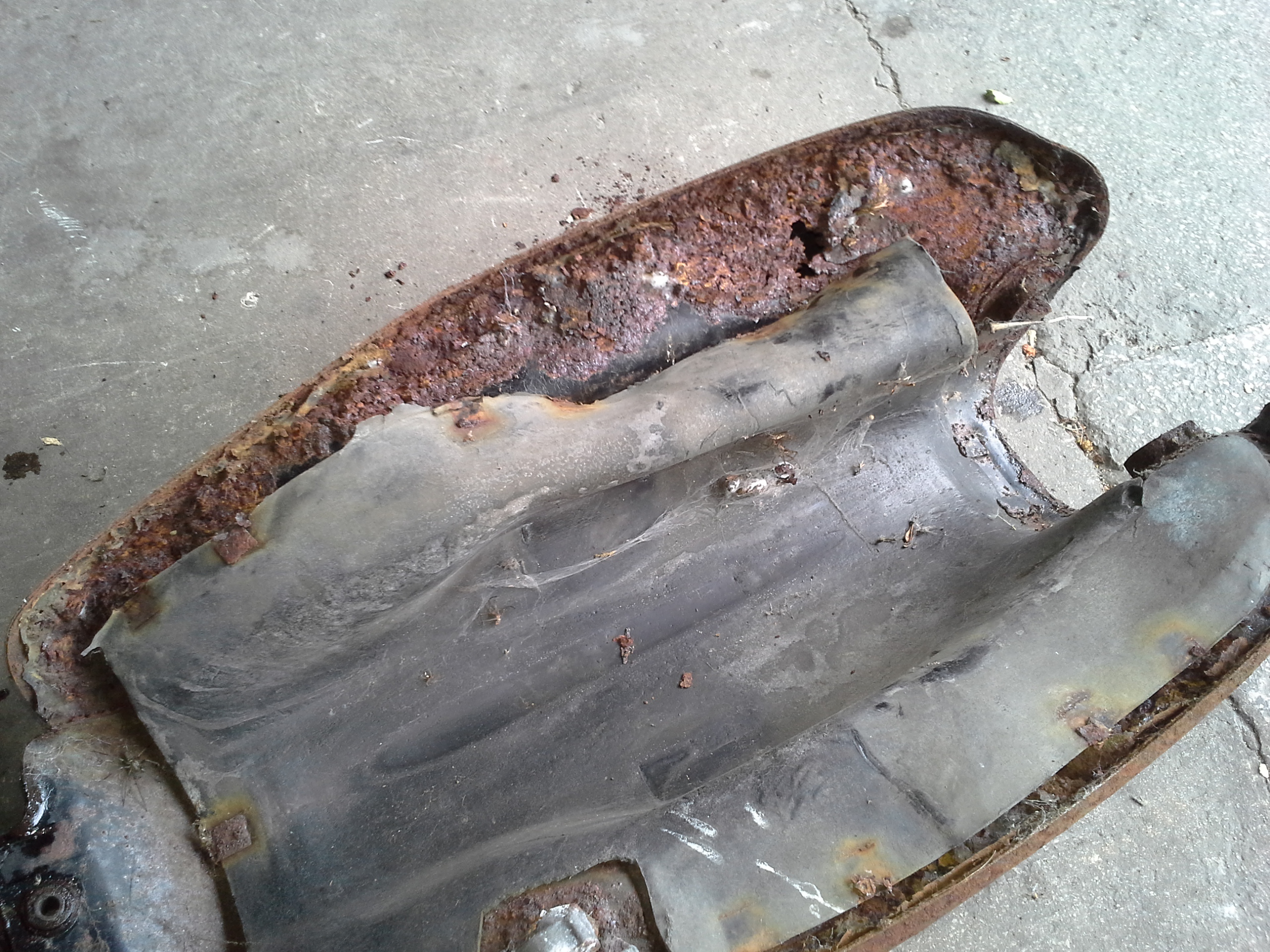

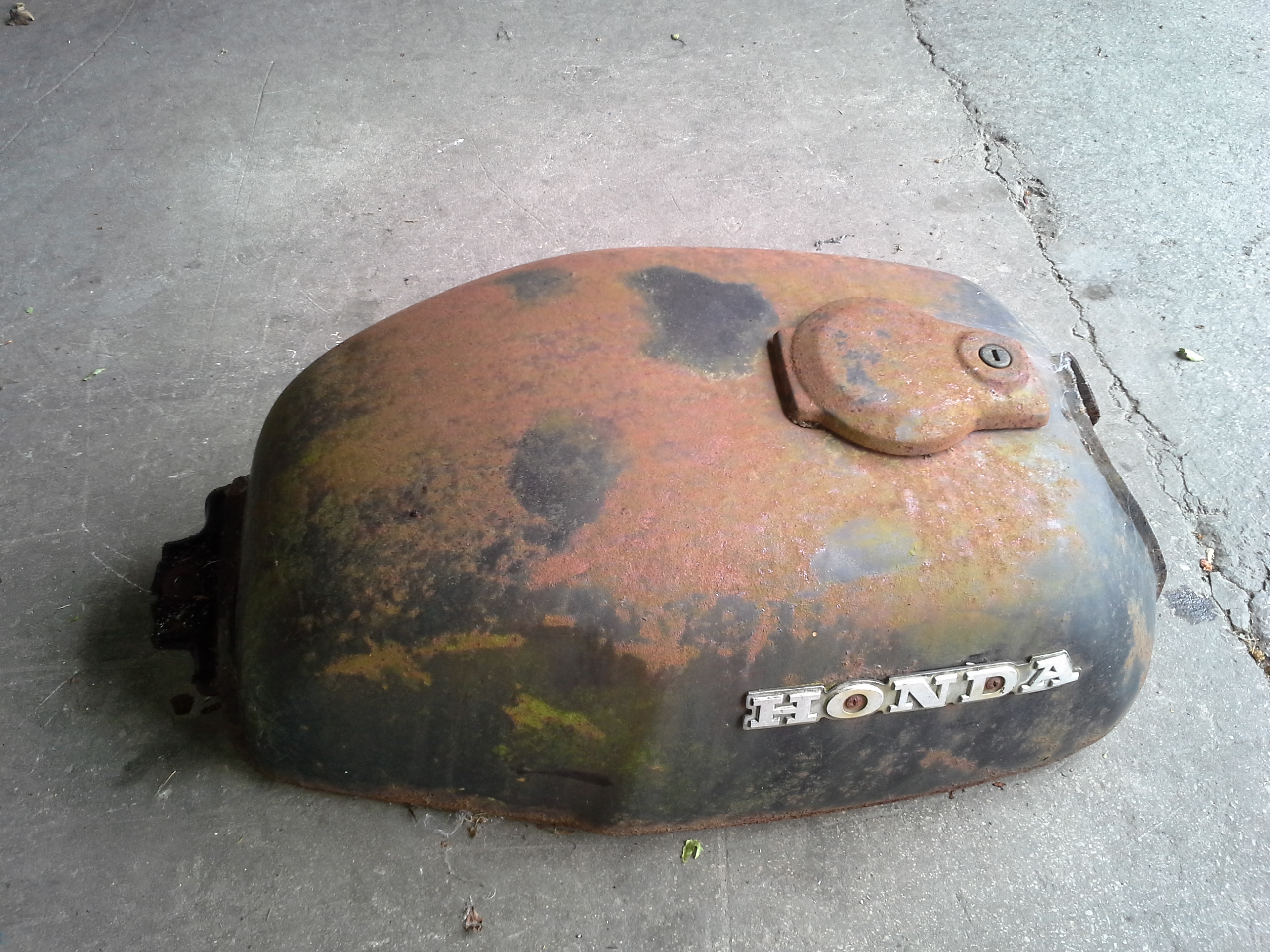

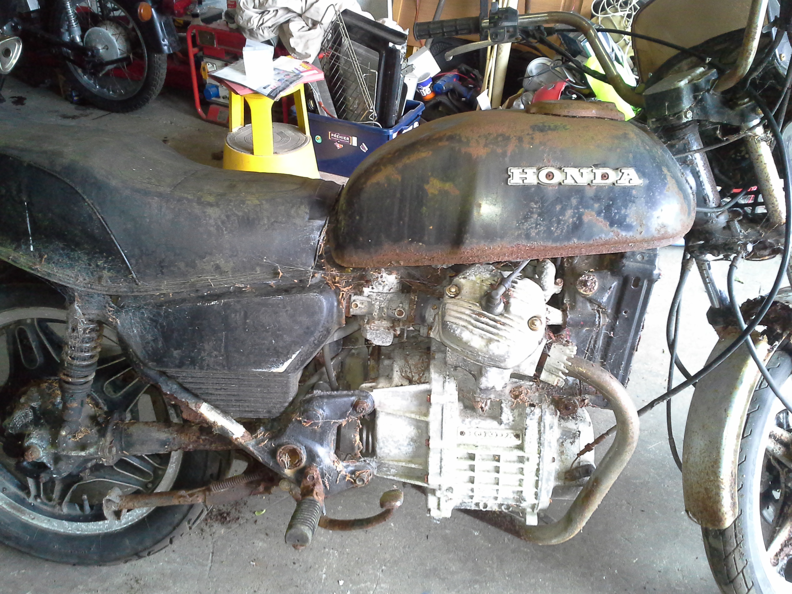

I bit the bullet and started the strip down of the CX. I underestimated "very sorry state" as you can see from the pictures. I new the bike was in a poor condition when I first saw it last year. As I trailered it home parts were falling off, at least they went into the trailer and not on the road.
Spoke too soon.

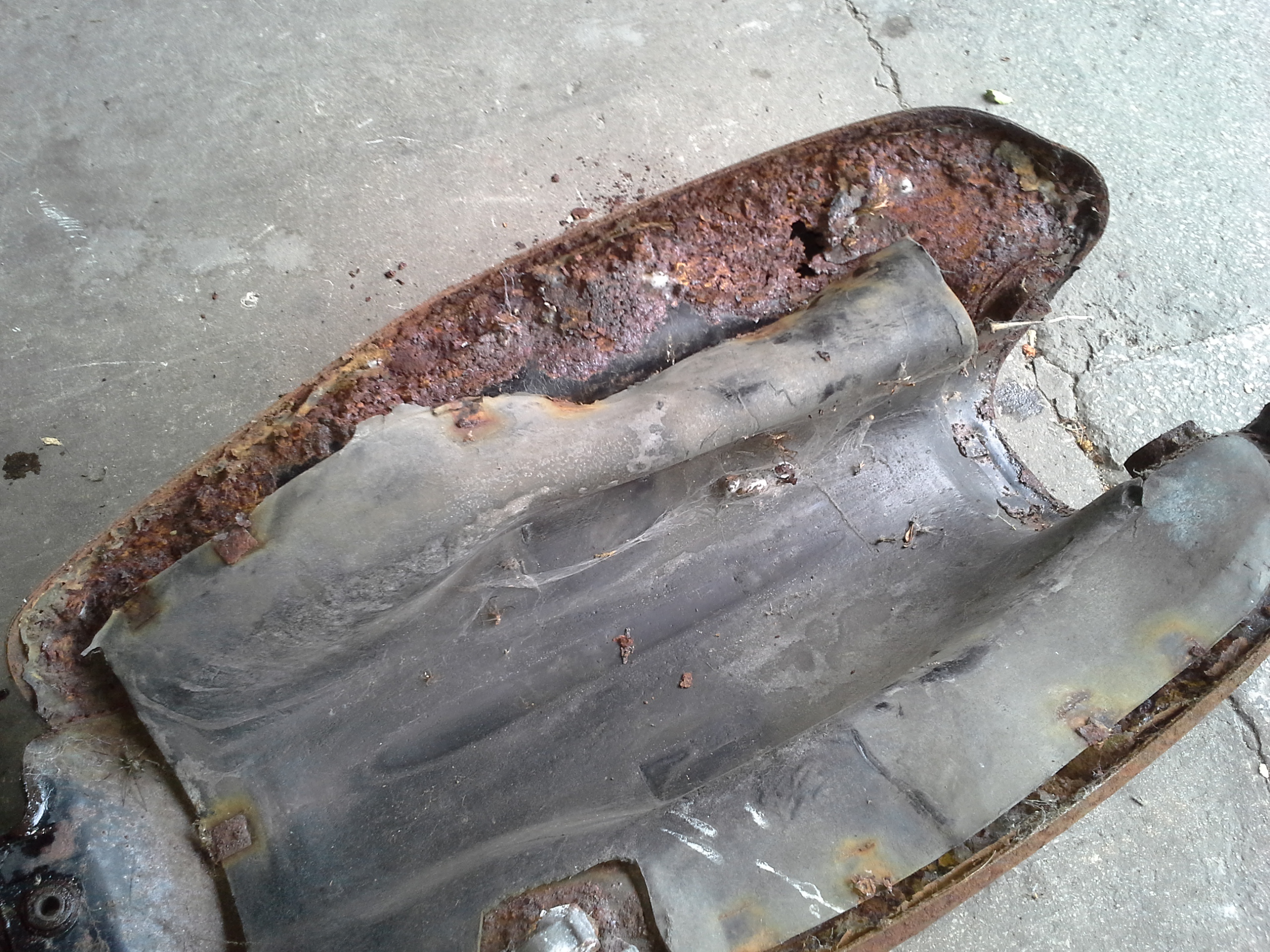

As the teardown progresses the tank looks OK.
Ah well!

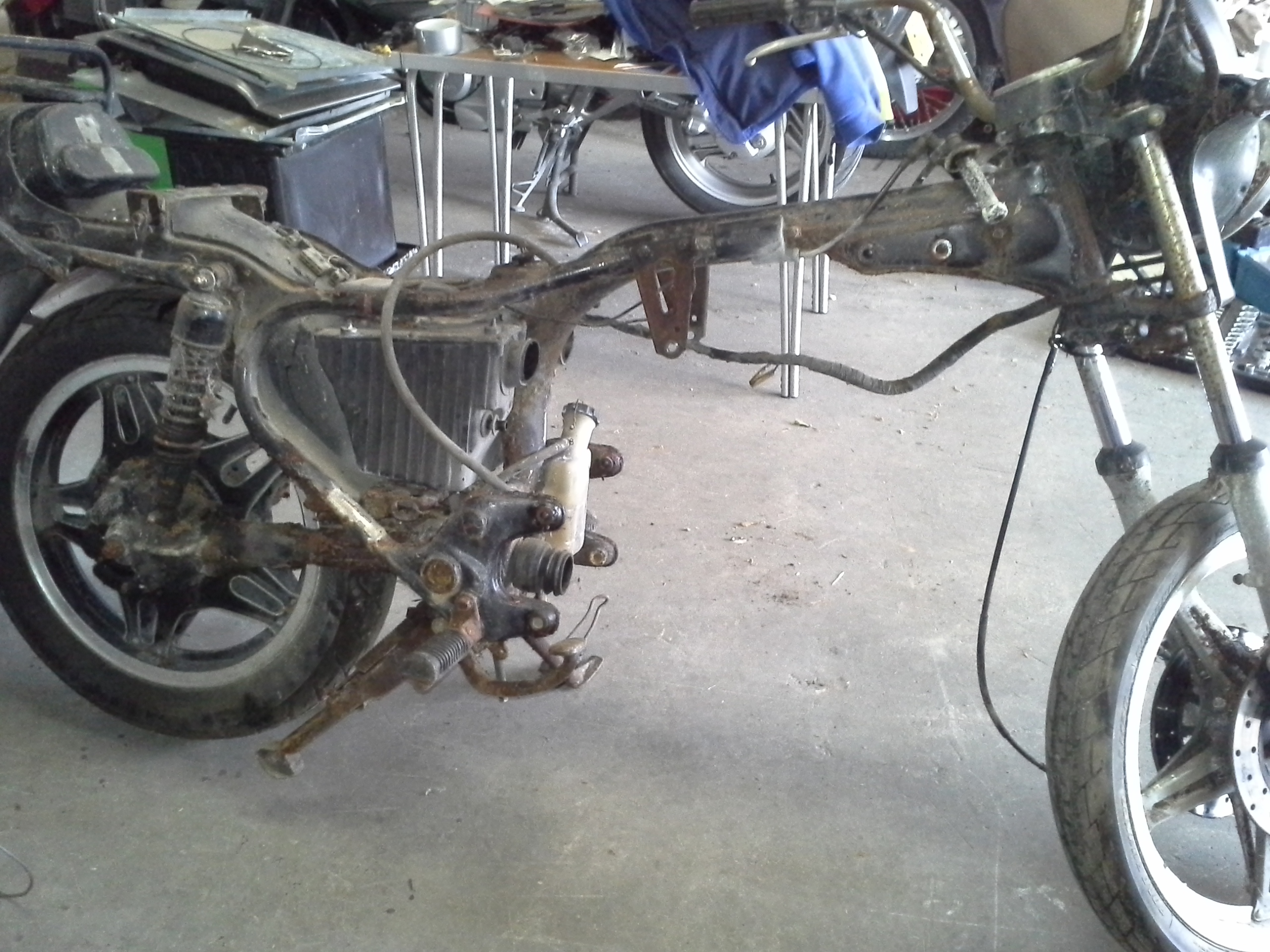

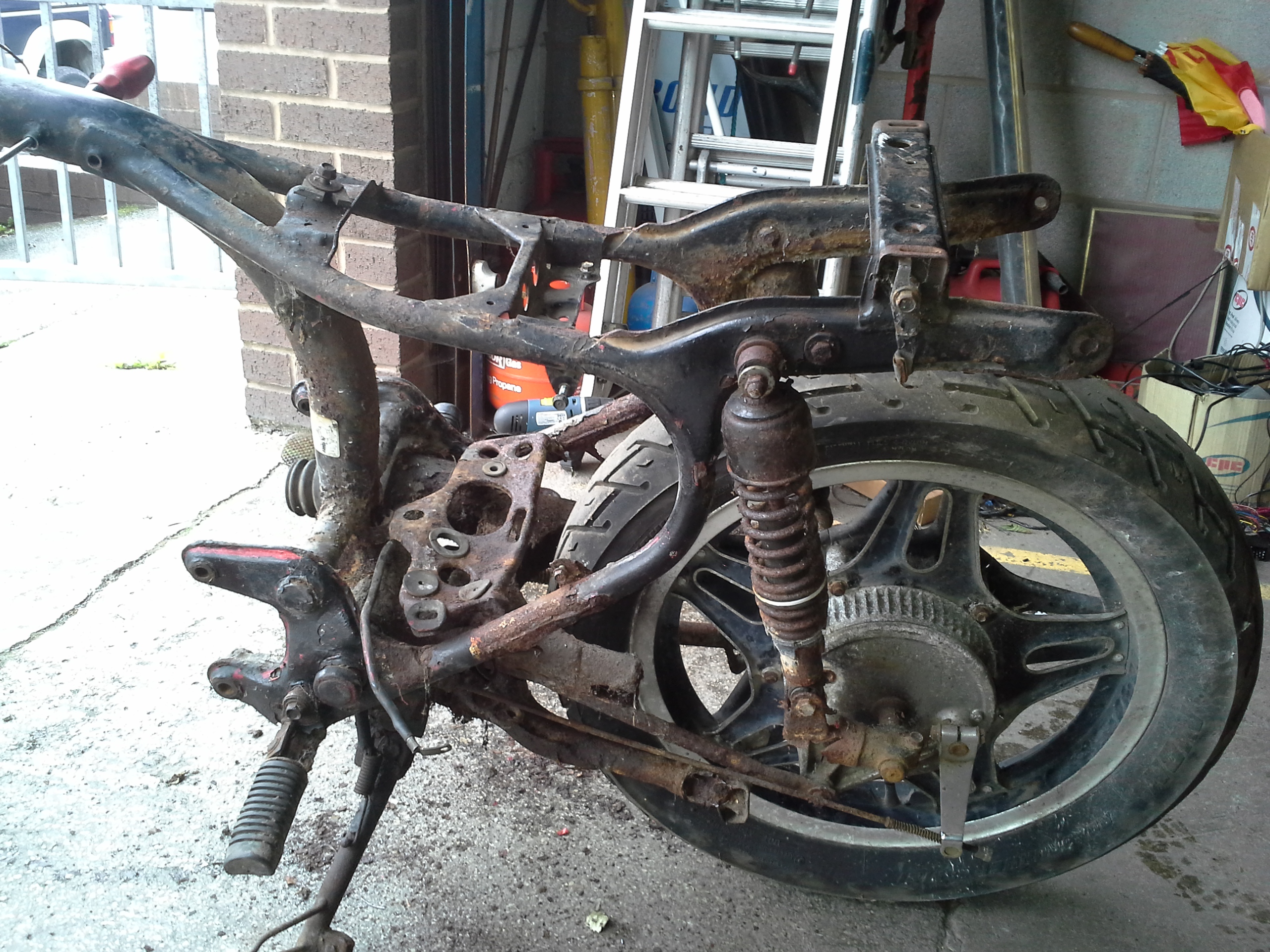

The frame is nearly there now and I have removed the front mudguard and callipers as required for any build. Surprisingly most of the bolts came off without a problem considering the bike has been under a tree for 5 years hidden behind a pile of soil.
More to follow soon.

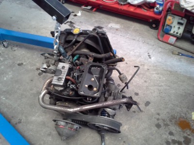

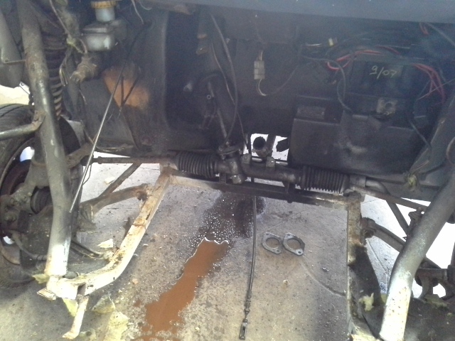

A couple more pictures.

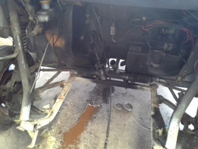

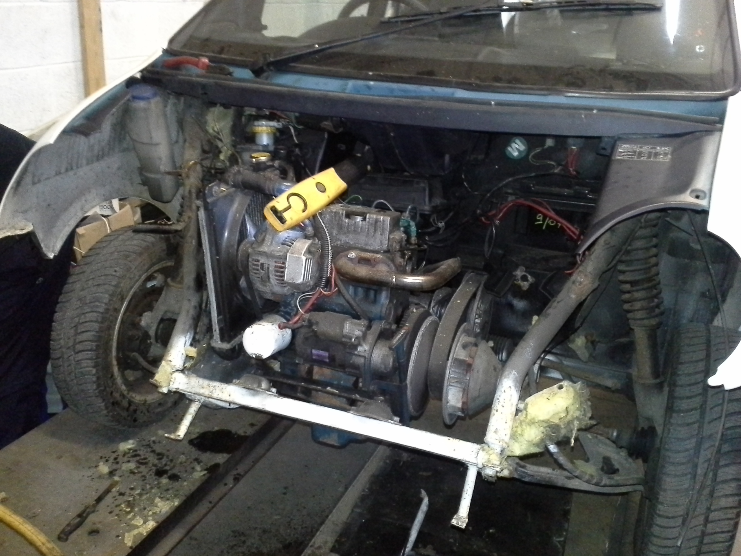

And now for the Aixam strip.
Bit of a sod to remove but finally.
It didn't look that big in the car.
The next job is to remove the gearbox and reposition the secondary CVT pulley. After that make a replica of the engine dimensions and mount points in wood so I am not lifting the lump in and out of the frame (up there for thinking down there for dancing as my Dad used to say). I will also strip out the remaining parts from the car that are engine related.
Re: CX500 build.
so much rust thru and near thru on that frame. I wouldn't feel safe using it. But you may have mad resurection skills that I dont have.
Eddy Wane
- Posts: 137
Re: CX500 build.
Coach. The photos do not do the rust any justice but on closer inspection it is repairable. For the moment I am using the frame as a jig to get everything in line. Unfortunately I need 3" taking off the engine overall length which means that the Aixam CVT will have to be swapped out for a thinner unit. After watching Heiko's video of his build I know it can be done but I do not know what make of CVT he used.

Initial measurements show that the Aixam CVT is too big at 7" overall length and I have probably got a 4" gap to fit something in. I have contacted Chris at Gemini Karts and he suggested a Comet drive. The smallest of these is the 330 at 3.31" but they are a bit pricey at £173+VAT just for the driver. After looking over the site the 40 series may also be an option at 4".
My mission, if I choose to accept it, is to source a secondhand 40 series complete unit. But at the moment they are a bit thin on the ground i.e. none on eBay.

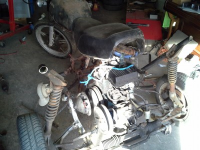

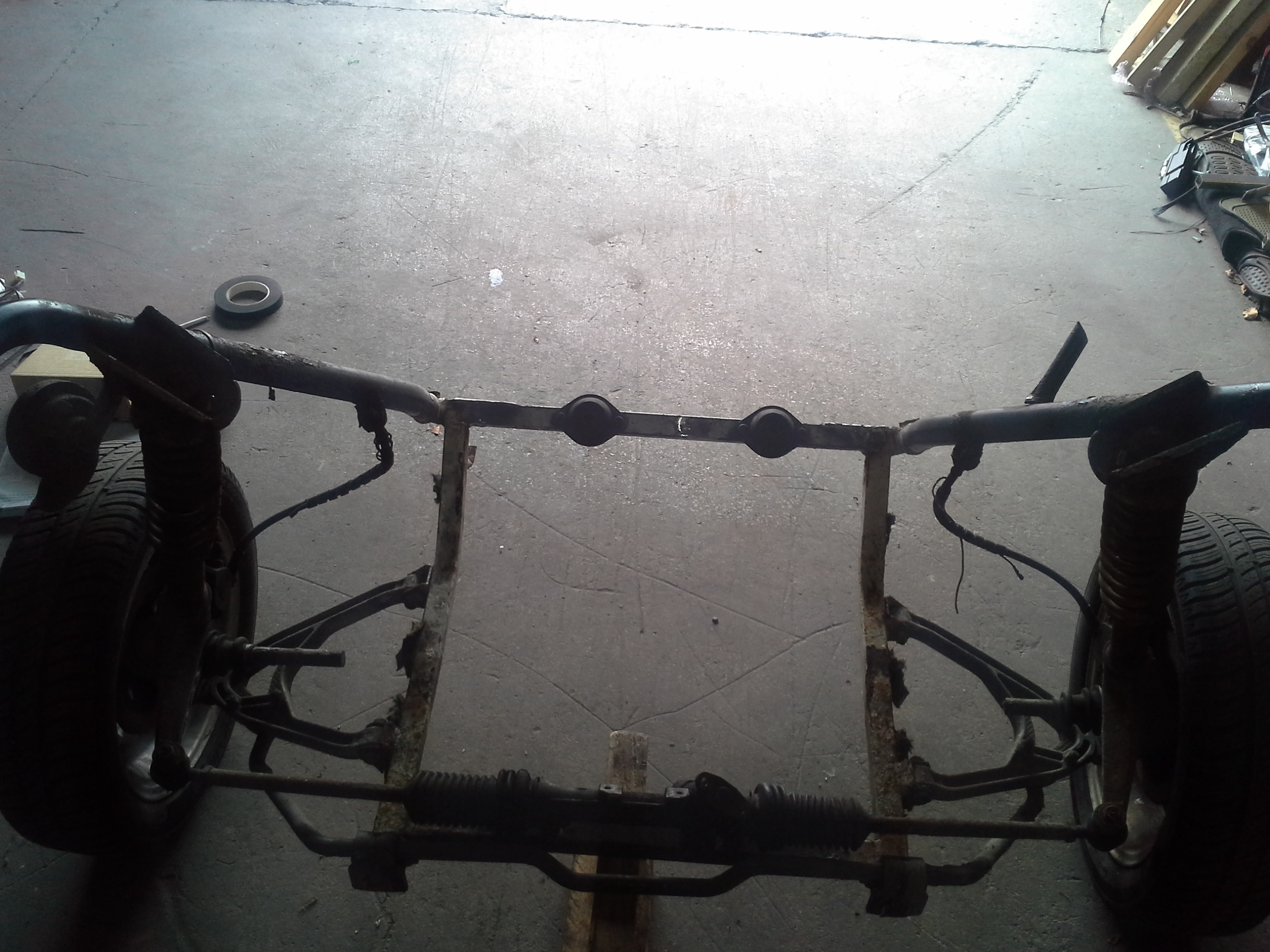

It's amazing what you can achieve in an hour. Plan B is underway. The engine cradle was chopped from the donor vehicle.
The engine was placed back in the cradle and the rear end of the bike was removed. Both units were then positioned to see what it would look like.
It does appear to be well proportioned and once the front engine mount has been fabbed up to fit the swinging arm mounts and the rear brace picking up the rear suspension locations I will have a rolling chassis ready for the next stage.
I am hoping to link the brakes and use the CX's existing rear brake location for the footbrake and throttle pedal, this will free off the front brake lever for use as the parking brake similar to an ATV system. The original Aixam battery will just fit in the airbox space and will house most of the electrics and the gear lever should locate on the left hand side near the frame spine.
