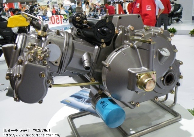

All it needs is an output shaft either the normal left side or possibly the choice of r/h side?
Pity we don't know the price?
Re: Zongshen 500cc Diesel Bike Engine
Judging by #4 and the gaping black hole on each side
4, using the integrated differential, more compact.
looks like this has an output on both sides intended for left and right axle for something of a 2wd ATV design. Thus for our purposes we would have to weld up the diff.

Axles coming straight out of the unit the diff must also include final drive reduction. To use it on a bike I'd want to take the whole lot out and so avoid having a 1:1 final drive.

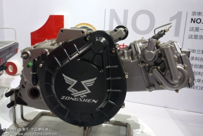

10kw is just under 13.5 hp. As for gearing I suspect it will be fairly low so sprockets would give the chance to experiment.
The horizontal and compact gearbox layout would allow fitting to most frames without a lot of cutting.

If it had an output shaft instead of a diff, and a vertical cylinder arrangment, then that would be a near straight swap replacement for a petrol engine!

This must be produced for a particular purpose ie. quad. The half shafts that need to fit the diff must be from an existing vehicle ? probably rigid back end quad as each shaft would need two UJ joints if it was to have suspension.
A lot of talk about it just fitting into bike frames. But if it has to be mounted as in the photo have you notice the length.

Integrated gearbox and diff make for easy installation, and have some potential for weight reduction. That's nice and dandy.
However, what I cannot understand is why Zongshen limited themselves by doing a one-cylinder configuration - where they could easily do a double (V2, straight double, boxer, you name it) and double the HP by making their engine-gearbox combo only some ten-thirteen kilos heavier.
Compare the data for 400 ccm single and 840 ccm V2 Yanclones, being based on identical technology and produced on similar equipment, and you'll see what I mean.
A 20 KW unit weighing 90-95 kilos complete with gearbox (and diff, since they are so keen on keeping that) would sure fit nicely in a Harley or Dnepr/Ural. And that's without taking into account the possibility to super/turbocharge it...
