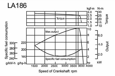

Torque curve for a Launtop (yanclone) 10HP single cylinder diesel
Torque Curve.jpg (30.85 KiB) Viewed 16007 times
If you look at this specific torque curve from a 10HP diesel that many of you are using or are thinking of using in your bikes you will see that its optimum RPM for both POWER and FUEL CONSUMPTION is at 3000RPM where it is producing around 8.6HP @ 26Nm (19.18 ft/lb's) of torque.
