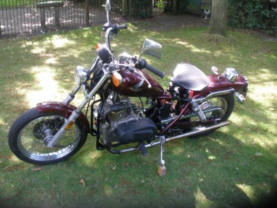

If you can send pics or do you know if your bike was built by someone who was possibly on this forum??

Here is a picture. No, not built by anyone in this forum.

Nice looking bike, by the way, so might be worth posting a few more pics/details

The bike is a 418cc (China-made) diesel in a Honda CMX Rebel (former 250cc) frame.
Found it when I randomly surfed on the net on a Dutch site, Autoscout or something like that.
Called my Dutch friend Ruud and asked him to go and take a look, so he bought it and shipped it here to Sweden in his van - he has a summerhouse in this village. Convenient

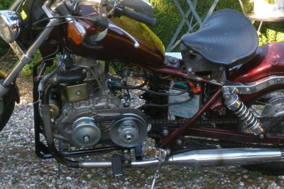

Well today the problem solved itself.
I went for a ride in the wonderful weather, and thought well today I'll try the top speed. Lo and behold - 90 km/h
But in a long uphill there was a funny buzzing sound, and the bike lost the drive, but engine was running smoothly.
sh*t, I thought, must be the cvt-belt that broke. And indeed it was. There was not much left of the belt, in fact
How could this happen - new engine, new cvt...??? Ahaa ! I discovered the disks in the cvt were not in line, not at all
The difference is more than 5mm, take a look on the photo. That must be why the belt got hot and sticky and did not function well.
Or what do you think guys ?

Well it looks to me as if the final drive sprocket is in the wrong place??
Shouldn't it be behind the backplate?
If that is the case you might be in for some serious re alignment of the engine as you can't move the chain alignment.

So - is it not possible to move the front sprocket out 5 - 6 mm with a spacer ??

I'm not familiar with the Comet CVT but if you can do that go ahead
Only other comment I'll make is if the rear chain is a standard chain needing oil I would try to make up some sort of splash guard to stop it getting on the belt/pulley.
If it's sealed chain it shouldn't be a problem
If you still have belt problems after you correct alignment have a look at this post.
Does your drive pulley have a bearing/bush like this for the belt to rest on at idle??
https://www.dieselbikeforum.com/view ... 670#p14670
- Peter the blacksmith
- Posts: 44
- Joined: Sun Sep 30, 2012 8:41 pm
- Location: Sweden
Re: CVT trouble - back wheel locks up
No, it doesn't
But thanks a lot, it was really a good tip what you wrote about keeping the oildrops from the chain apart from the discs !
I really appreciate that
The early bird will get the worm, but the second mouse gets the cheese
I think too this design is to have the sprocket on the backside of the backing plate. Looks like the chain's been nibbling at the inside of the driven pulley. I don't think they were ever intended to be sleeping that close to one another. As it is, the driven shaft is cantilevered off the bearings with all forces excertd outboard of the backing plate. All a recipe for a short life. If the drive pulley can't be moved outboard a sufficient distance to align with the driven, another option would be to replace the stub shaft with one long enought to reach to the other side of the bike, flip the rear wheel over and move your drive sprocket to the right side. All in all it would be a fairly simple process. It would also include mounting a bearing on the right side and re-routing the brake mechanism. Probably easier than moving the engine that much to the left.
Believe comet sells a tool for setting the distances left and right properly between the two clutches. Since one clutch has one sheave that moves inward and the other has one that moves outward as they expand/contract thru their ratios; they do have to be aligned properly to keep the belt from being tweaked. The secondary I do believe is the one whose sheave moves inward so if your sprocket is there it may also be conflicting with its travel; thus the marks your found on the secondary sheave.
Another idea is for you to NOT use the comet mounting plate your using. Get rid of it and mount a jackshaft for the secondary to ride on with pillow blocks. Might give you a tid bit more options that way and prevent you from having to swap it all to the other side.
I was wrong. The sprocket is outboard of the backing plate. But, that's good news in that no major mods are thus required. Still a bit puzzling why the chain is turning down the driven pulley. Especially since it's the outer half that moves (Sorry George, I think we're arguing on the internet over this one. I believe that's something we're never supposed to do).I think too this design is to have the sprocket on the backside of the backing plate.
hmm. interesting on sprocket location. Different designs apparently do it opposite of one another. It appears some manufactures set inner as movable sheave while others set the opposite. In the following video the Team Industry set up has the secondary's movable sheave as the inner onepietenpol2002 wrote:I was wrong. The sprocket is outboard of the backing plate. But, that's good news in that no major mods are thus required. Still a bit puzzling why the chain is turning down the driven pulley. Especially since it's the outer half that moves (Sorry George, I think we're arguing on the internet over this one. I believe that's something we're never supposed to do).I think too this design is to have the sprocket on the backside of the backing plate.
http://www.youtube.com/watch?v=uCEvBGT8twM
while the comet; like used on his bike in video below has the outer as the Movable.
http://www.youtube.com/watch?v=DNzFTxTvajg
doing some looking at CVTech units and apparently they too have the inner sheave of the secondary moving inward as well.
http://www.youtube.com/watch?v=xeQITB_H2wM
note this video has a bent or flexing jackshaft holding the secondary. Threw me for a second too
So back to topic... could the torque of the diesel be flexing the shaft the secondary is mounted too?
Hi PeterPeter the blacksmith wrote:So - is it not possible to move the front sprocket out 5 - 6 mm with a spacer ??
I moved the front sprocket on my bike with a spacer I made. On my engine it was not a problem. Took some measurement and turned a spacer on my lathe
Seems a reasonable hypothesis. While it's rated as taking 9 hp, the torque from the diesel would be considerably greater than a petrol engine. Additionally, as this unit is designed for a #35, 40 or 41 chain, could the wider #530 chain also be contributing?could the torque of the diesel be flexing the shaft the secondary is mounted too?
