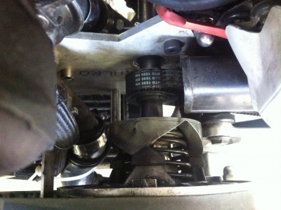

I find the engine braking on diesel excessive . Having a CVT transmission this seem to compound the engine braking issues and even on steep hills I still require throttle or it will slow down more than I wish.

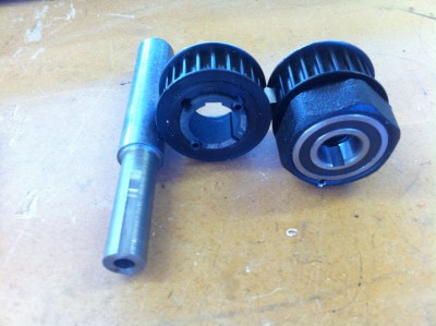

I want to experiment with fitting a one way drive or ratchet in the secondary drive small pulley . This will then remove all engine braking . If it works hopefully it will solve the over braking and may even improve the fuel consumption ,
I have used a sprag bearing on one side , these are a ball bearing race which has a set of cams that will freewheel in one direction but lock the bearing in the other direction.
On the other side of the pulley is a sealed bearing . The sprag bearing requires a key way both inner and outer to transmit the torque and prevent it slipping in it housing.
The unknown being if it will be able to cope with the torque, being belt drive it will help reduce the shock loading on the sprag bearing . I addition It may also just be to weird to ride !
[img] [/img]
[img] [/img]
I will fit it to the MK 5 bike currently under construction ...... So you will have to wait for the results!
[img] [/img]
[img] [/img]

I looked at the subject for my single cylinder bike and concluded that most diesel engines of industrial origin rev to around the same revs whatever engine is used and the only difference is the power output.
My CVT was from an Aixam Kubota Z482 so I was pleased that the cvt take up was working fine and I just experimented with the rear sprockets.

I agree but I find the standard setup best for performance and I have reduce the engine rpm to get the engine back to being more fuel efficient and I find the higher rpm makes my bike noisy and a blurr of sound!
Possibly the real reason being I am just a sadoo that thinks what what if I just changed"...............?
The idea may not work but I will keep you updated when I have tried it.
Thanks Tim
