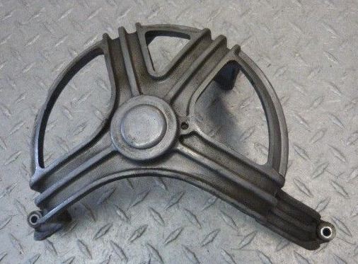

Tim, since your rear pulley cover allows for exposure to the elements, I presume a front cover could do the same. I''ve got several of the guards as shown in the pics below that I'm considering for my primary drive. Just another option to consider. They're CVT guards from Yamaha and Suzuki ATVs and both were sold in the UK. You'd still need to forego the bell-bottoms from your wardrobe.

pietenpol2002 wrote:Tim, since your rear pulley cover allows for exposure to the elements, I presume a front cover could do the same. I''ve got several of the guards as shown in the pics below that I'm considering for my primary drive. Just another option to consider. They're CVT guards from Yamaha and Suzuki ATVs and both were sold in the UK. You'd still need to forego the bell-bottoms from your wardrobe.
Hi
It's a shame your across the pond as they look interesting what diameter pulley will it fit around?
I will look into the guarding when the build has progressed further as I can't yet work or see what's going to be possible and look good so I may be back to you.
