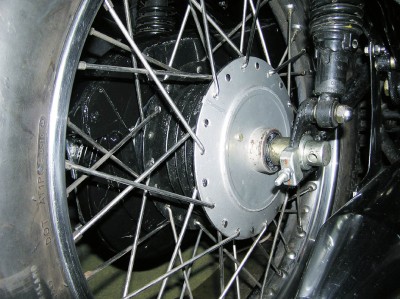

So using the existing chain guard, some carbon fibre effect 2mm thick high impact plastic sheet, some off cuts of metal strips for support brackets, some 3mm and 4mm diameter bolts and nuts, and not forgetting the bottom chain case half which is an old second hand modified Honda GC125 part, where I've even managed to keep the chain inspection hole with it's plastic blanking plug.

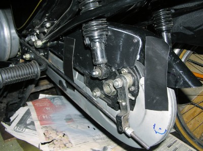

Doing a trial fit for mounting bracket manufacturing and measuring. The usual method of using marked up cardboard templates for the fill in panel measurements for the chain case, and for the mounting bracket plates was used.

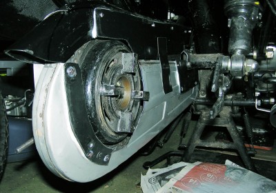

The original Honda part needed quite a bit of twisting and fettling to get it to the right profile for the swinging arm!
The hardest part was getting all the profiles right, around the swinging arm, making sure that nothing rubbed or fouled the bike frame or drive chain.
The positioning of the chain case body securing screw head sizes were critical, again to avoid rubbing the drive chain. All the joints were finally sealed with flexible sealing compound, and the chain case securing bracket plates were secured using rubber mounted 4mm diameter bolts,to reduce vibration stresses.

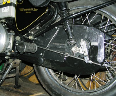

Some internal rubber anti- rubbing strips were added, where the chain case sits against the swinging arm and the rear drum assembly. Then a final bit of adjustment of the plastic fill in panels could be done, using my hot air gun and with care with my fingers!! slowly moulding the plastic edges around the swinging arm and bike frame, to allow for sufficient clearances, even when the rear suspension shocks are compressed. All was correct in the end, and the chain cases could be finally fitted and cleaned up, ready for the bottom half to be repainted.
I managed to get it all finished and then tested on a reasonably long run on the bike, going over some bumpy roads, and no problems! And then the bike passed it's annual MOT test soon after, with no adverse comments from the MOT tester about the chain case, so it must be all right!
I made sure that the drive chain was well lubricated, being waxed up with chain wax spray, and the chain play adjusted before fitting the chain case, so now hopefully I should have very low maintenance riding regarding the chain, especially in the winter, and no more rusting chain links!
Just enough clearance was allowed for the rear cush drive and wheel hub assembly to move smoothly round, and without rubbing.

If you look at the first pic above the lower chaincase half has a rubber bung which is removed to check chain wear
